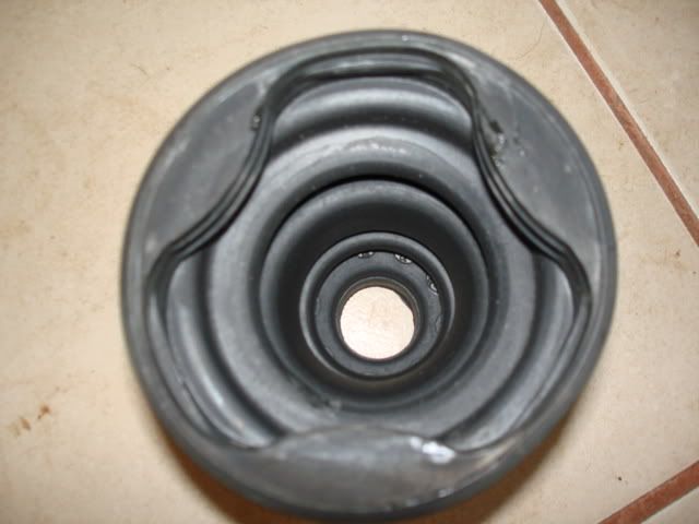

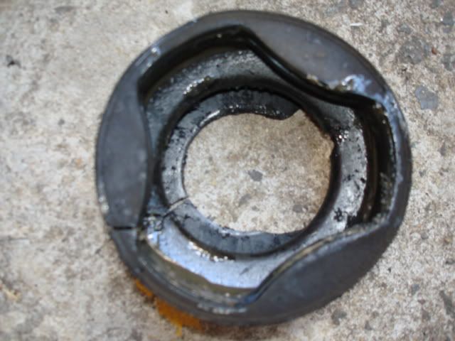

Hi all,
changed all CV boots on my S2 Stag this weekend & have some info re: the inner boot on the passenger side.
I dont have a part number but do have a photo of which I will attempt to upload below. The 1st one is the old boot, 2nd is the new one.
Is that a Nissan part or generic?
Generic, I think. I cut the boot off the passenger side thinkin it would be the same as the driver side........NOPE.
I then had to do a frantic ring around to find a steering place near me that was open on a saturday arvo, lucky for me I found one.
They charged me $40 for the privilege. Still I'm not gonna need to change them for ages now.
