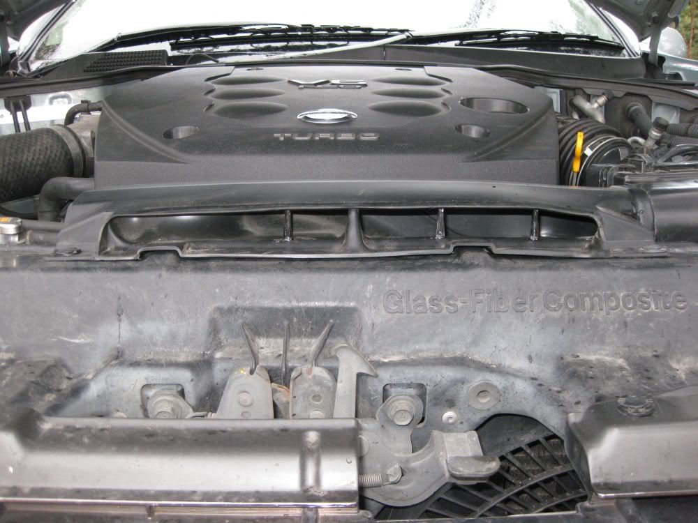

So I got a bit sick of looking at that damn open airbox in my M35, no doubt sucking in warm air from the engine bay and I refuse to shell out $180 to Nissan for a Powerduct.
I decided to see how a secondary CAI would go on with a closed up airbox compared with the open airbox panel and stock air intake I was running.
While I was at it, I decided that enough was enough with the "sucked in" opening to the OE intake funnel.
As you can see below, the airbox panel is removed (duh!) and the right side of the air funnel has almost been sucked closed.
I was toying with the idea of an aluminium airbox with pod for some time, but decided to go this route first as it would cost very little if there was no improvement.
First up, the factory air intake funnel.
I found these some plastic wall lugs in my tool box (similar to THESE).
Drilled 3 holes in the bottom of the intake funnel, painted the lugs black and gently screwed a screw into each of them from underneath.
It stretched open the right side of the funnel quite a bit, yet the bonnet causes no damage to it at all.
end result looks like this

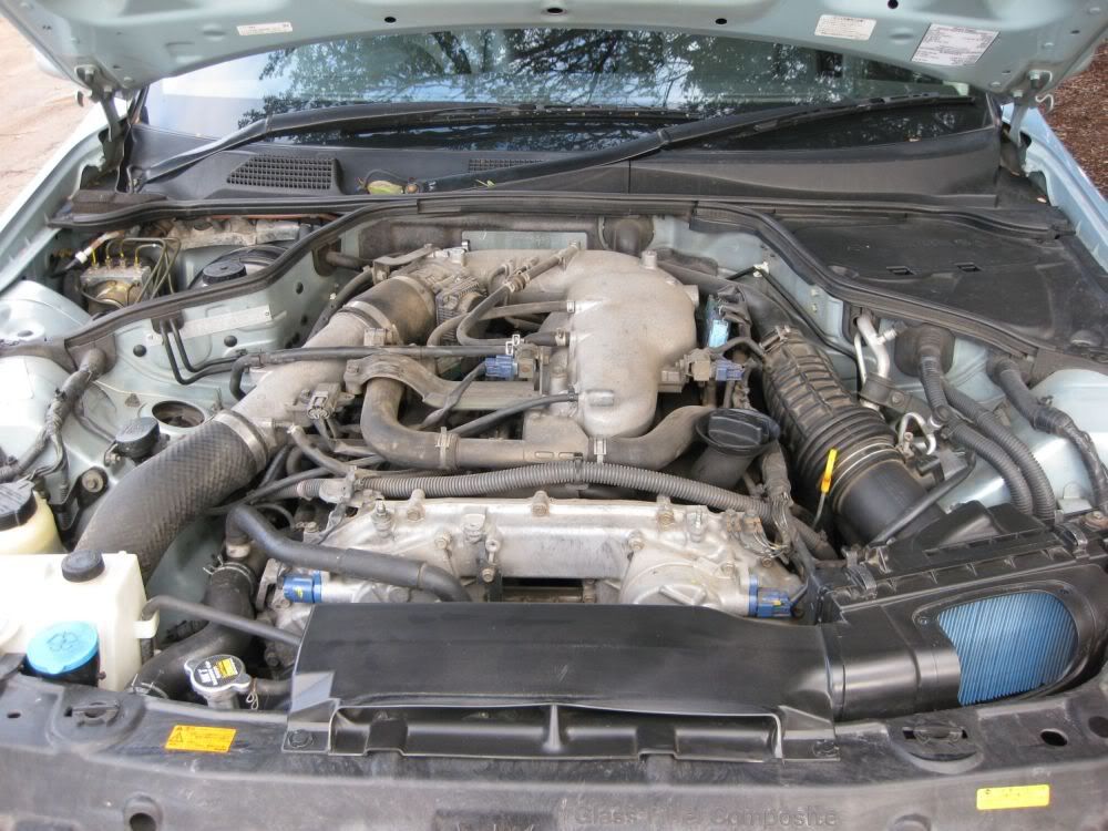

Next, I cut out the inside of the "drain hole area" of the bottom of the airbox (obvious when you look) and stuffed one end of 40mm flexible pond hose into it.
I went with 40mm as it was all I had lying around, but you can buy it by the metre from any Reece Irrigation store (probably other Irrigation or Pool shop would stock it too).
I used pond hose as the inside wall is quite flat and very slippery.
I bought an 80/50mm DWV reducer from Reece (or Bunnings or Mitre10... whatever) for a couple of bux, sprayed it with a matt black primer so it dried faster and stuffed the other end of the hose into the 50mm end to make the funnel.
I then just used a large cable-tie on one of the rear holes in the reo bar to hold it in position nice and tightly.
This is all you can see from the outside
Surprisingly, it has made a HUUUUGE difference. Car feels a lot more solid and I have no hesitation accellerating a bit harder now (no stupid WWWwwwo sound. Some of you M35 guys know what I mean). Top end of the rev range is fine as well.
If I put my hand in front of the funnel, I can feel the air getting gently sucked in when the car is idling. Can only be a good thing.
Takes about 45 mins all up if you let the primer dry. Far too easy.
It is a quick, easy mod that is quite beneficial, it would seem. A lot cheaper than a Powerduct as well.
Anyway, there you go!

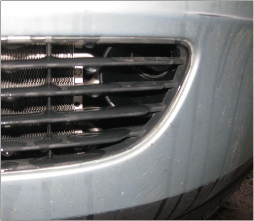

So I thought I would have a bit of a play with my stock air box and intake to see how much cool air I could get in.
Liked the idea of opening up the snorkel but I just used one support on each side and a bit longer to open it up more.
Left the cover on where the "powerduct" would go for that stealth look.
Then I took to the inside of the air box with a die grinder to get rid of all the ribs and smooth it out for better flow (maybe).
Also removed that resonator chamber that just unclips and covered the opening with some aluminium sheet and some self adhesive foam.
Cut a 76mm (3") hole in the bottom.
Got some 76mm flexible tube from Clarke Rubber and just managed to squeeze it down to the lower bumper.
It wedges in against the bumper quite well (didn't use any cable ties) and is far enough back that it hopefully won't catch too much water or bugs.
Finally, I removed that hard plastic tube from the intake pipe and got a Turbosmart 38mm BOV plug which is actually a bit small and nearly fell through!
I have since found a 44mm blanking plug from eBay and it fits much better (put the old hose clamp back on too).
Results? Not so much down low but definite improvement in mid to high revs. Lower rpm (50ish) at idle too but not to the point where it's going to stall.
