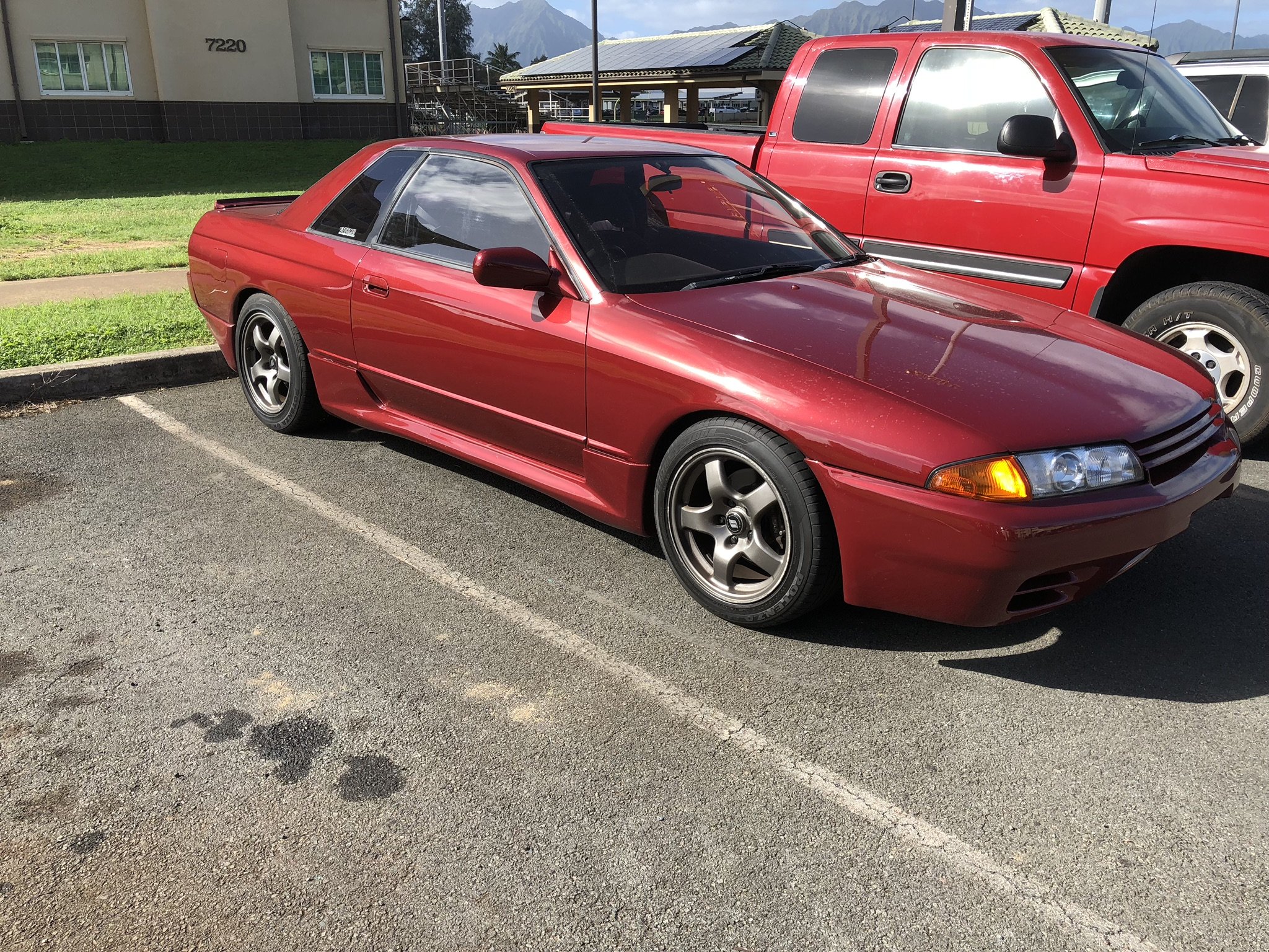

Hey guys, Recently got into a sticky situation with my car and I'm in the need of new corner lights. The thing with my GTS-T is the previous owner put on the GTR hood, grill, headlights, and bumper. I can't really tell if the fenders and corner lights have been converted so I'm not sure if I should be looking for GTR or GTS-T Indicators. Here's a pic for reference. Also has anybody seen or heard of anybody besides ZLED that converts corner lights to LEDs like this?
