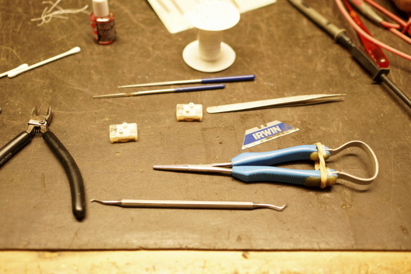

How to repair seat switches in the M35 Stagea.
You MUST find someone with a proper, professional quality desoldering iron. The switches are pure copper and will suck up heat easily. Seat_1.JPG
Steps:
·        1)  Remove seat.
·        2)  Remove switch PCB from seat.
·         3) Remove switches from PCB.
·        4)  CAREFULLY lever switches apart (I used a Stanley™ knife blade), taking care not allow springs to end up 10 Metres away, by removing the switch cover.
·         5 Burnish and clean the switch contacts.
·         6) Condition switch contacts with De-Oxit™ or equivalent.
·         7) Allow to sit for a few minutes.
·         8) Clean off excess De-Oxit™.
·         9) Place a minute segment of Blu-Tack™ on the end of the two springs and re-insert.
·         Here is where you need 4 hands:
·         10) Place a loop of strong cotton (I don’t like using mon-filaments, but use whatever you like – it must be fine enough to allow the switch cover to be re-installed whilst the cotton is in place) around one end of the switch body.
·         11) Replace the two switch levers and ball bearings.
·         12) Install both switch actuators.
·         13) Ask you second pair of hands to place a second loop of cotton around the other end of the switch.
·         14) Both switch actuators should be reasonably secure at this point.
·         15) Replace the switch cover.
·         16) Cut the cotton.
·         1 - 16) Repeat as necessary for other switches.
·         17) Re-install on seat.
·         18) Re-install seat.
Happy days.
