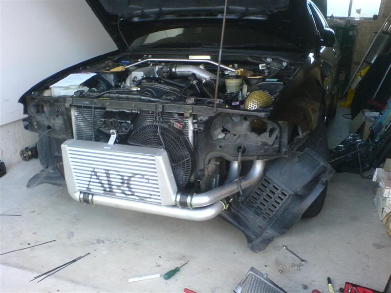

The one thing though I couldn’t find much of was a write up on Front mount intercooler installs on S2 R33 skyline. I installed my ARC Kit on Sunday and decided I would do a write up about it.
The kit is the ARC with the pipes both running down the passenger side of the car. The car a 96 S2 Nissan Skyline. Well here goes hope this helps some of you out there.

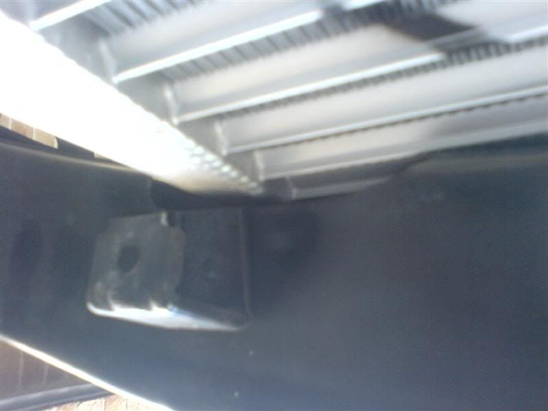

6. Modification to the centre bracket where the bonnet latch is. Photo will clear it up. There is a metal bracket that clips into the grill, it comes off the center support at about 90 degrees. What needs to be done is the removal of it, get 1 angle grinder and cut it straight where it comes out of the center. Buff it up and then I repainted it all black to keep it looking tidy as you can see in the photo.

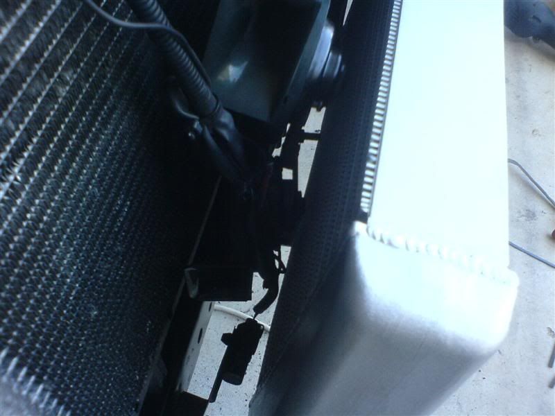

8. Re installing AC fan requires a bit of modification to the bottom plastic fin picture shows what is needed. Take it back to the grill this will give you all the clearance and also still keep rigidity. It bolts up to the same 3 holes it was unbolted from. Reconnect the plug and now you are ready to mount up the core.

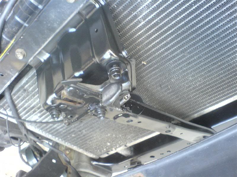

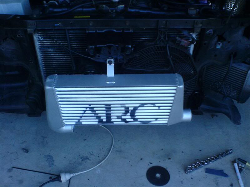

9. For mounting the cooler, undo the bottom bolt out of the bonnet latch bracket and mount it up. Place the bolt back in and line it up, it will fit into already positioned holes, and once all straight tighten up with supplied bolts…… BIG WARNING do not over tighten as the bolts will snap heads off, happened to me on one of them and had to tech screw it to the car. Once this is positioned time for removal of stock IC

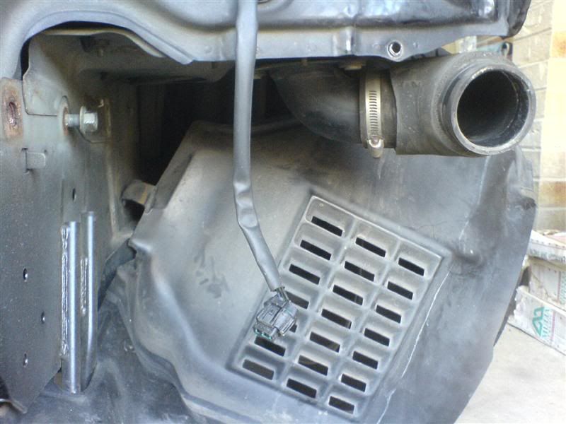

10. Removing the factory unit is a bit of a pain, firstly I loosened the hose clamps off the pipes where they enter the engine bay. Once these are removed time to take out the bracket that holds the cooler to the chassis. It’s fiddly but once it’s loose it will pop out and you will be well on your way to put on new pipes. Once cooler is out the last metal pipe its bout 20 cms long has to be taken out, its held to the guard by 2 10mm bolts, take out this pipe and your ready to bolt the new pipes in. I had a quick check in the pipes for build up and nothing in them.
11. Mounting the new piping – fairly self explanatory, long pipe runs down along bottom of cooler, and connects to the shortest 90 bend this then continues straight up as can be seen in the photos to the factory cooler pipes. The other pipe mid length with 2 bends runs straight off the left end of the cooler up to the factory piping in the engine bay. The ARC kit comes with all Hose clamps and also green rubber silicon. I didn’t like the green so I hit it with a black spray paint, it peels off but I will be getting black ones for it this weekend. Once the piping is all mounted up, kick the car over to make sure its going to run without any leaks or problems. If its all good its now time to place the intrusion bar on the car again.

So that’s a run through with pics of the full install, with 2 guys with jap instructions and my phone as a camera. Took us bout 6 hours with the right tools, and just steady pace with drinks and lunch etc. Hopefully that helps people out and gives them a bit of a heads up on what can be done with some common sense and patience, I think it looks really tops. Next mod is custom lexen pod box with ram CAI.
