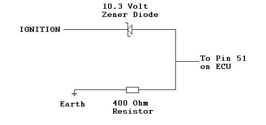

Below is the wiring diagram which enables the power fc to function properly in a manual stagea without throwing the engine checklight.
I have used this wiring circuit in three series 2 25t rs four "s" stageas, all with great results.
However i cannot attest to its viability in a converted series 1 manual stagea.
Hey Andy, I figured out something similar to achieve the same results.
I just put a 510k ohm resistor from pin 51 on the ECU to ground, because pin 51 has around 5V coming out of it
and you just have to lower that voltage to around 3.7v to turn off the engine check light.
It seemed to affect the idle slightly aswell, did you notice that?
But besides that, it runs fine, just have to get my cold start sorted out.
i can attest to the workability of the "secret squirrel tweak" as i have it installed on my car and it is easy to fit and allows you to tune the power fc as you would in any other car.
cheers oxford
I can confirm that the method that I have used in a series one converted to manual
does work.
But if the method Andy has shown is a better way of doing it, I'll give it a go.
Anyone know if it would be the better way of doing it?

i have no problems with idle or any other side effects.
the way it works is that the zener diode (or diode's if you use a combination to achieve 10.3V) have a break over voltage of 10.3V, meaning that only 3.7V (14-10.3) or there abouts makes it to pin 51. the resistor to earth is to stop any current from flowing through the ECU.
My cold start is a bit funny as it still needs sorting out, but once it's warm it idles fine.
What I noticed was that when I put the resistor in, the idle changed (lower or higher not 100% sure now).
But I might give your method a go when I get some spare time, see if it makes any difference.
the R34 powerFc pin 51 goes to the traction control so if you plug it in it will run the engine no problems (at least on a series 2 stagea and presumably on a series 1) but the engine check light will be lit. EGA4IT's circuit will provide the 3.7V to get rid of the checklight.
