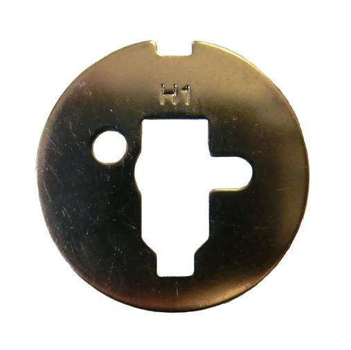

Yeah had a look today and they all working sweet now don't know why I didn't look into it earlier lol just been yo busy with other jobs to worry about my own cars. Had heaps of d2s bulbs the person that cut the wires to ballast before I had it must of not known what bulbs went in so they just wired up h1s .
Should have good lights at night now with the projectors working happy days!
This annoys me greatly. Instead of destroying the standard wiring and plugs, shops can easily get a D2→H1 plate made up and disconnect the HID part of the wiring and make up a two wire "harness".
e.g.
11223717-origpic-2dfbe1.jpg_0_0_100_100_
