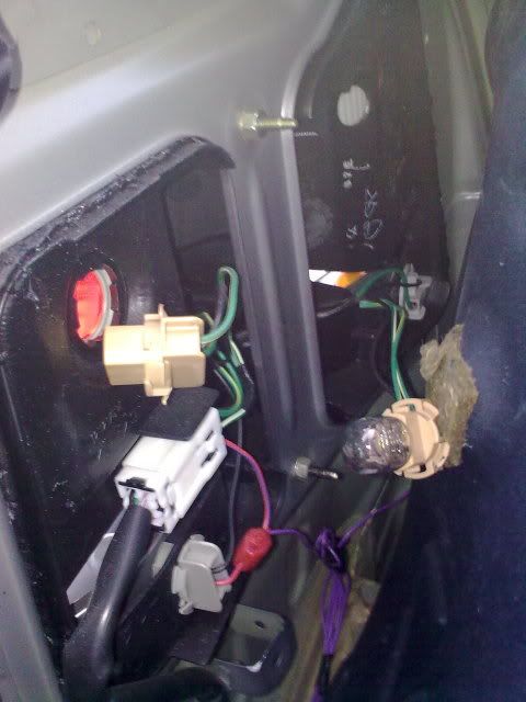

You're Right, I opened up the carpet and there were 4 10mm nuts. I undid those and the entire light assembly came out.
From there it was really easy to change the globes.
I took a quick photo with my phone (sorry for quality) for anyone who wants to know in the future.
I also found an old Jap razor blade in there.
Ash.

Cheers mate. All was good i fixed it that arvo. The trim clips were easy with small screwy to lift the centre out a bit then pull the whole clip out. The stop tails had gone on 3 out of 4 so i replaced all 4. The 4th was on its way too so i suspect it was just an age thing.
For anyone wondering with the r34 gtt 4 door, it doesnt require you to take the light off as the globes are all easy removal once you peel the carpet back. See pics. Oh and fyi, the globes were $12.50 per pair at autobarn.
