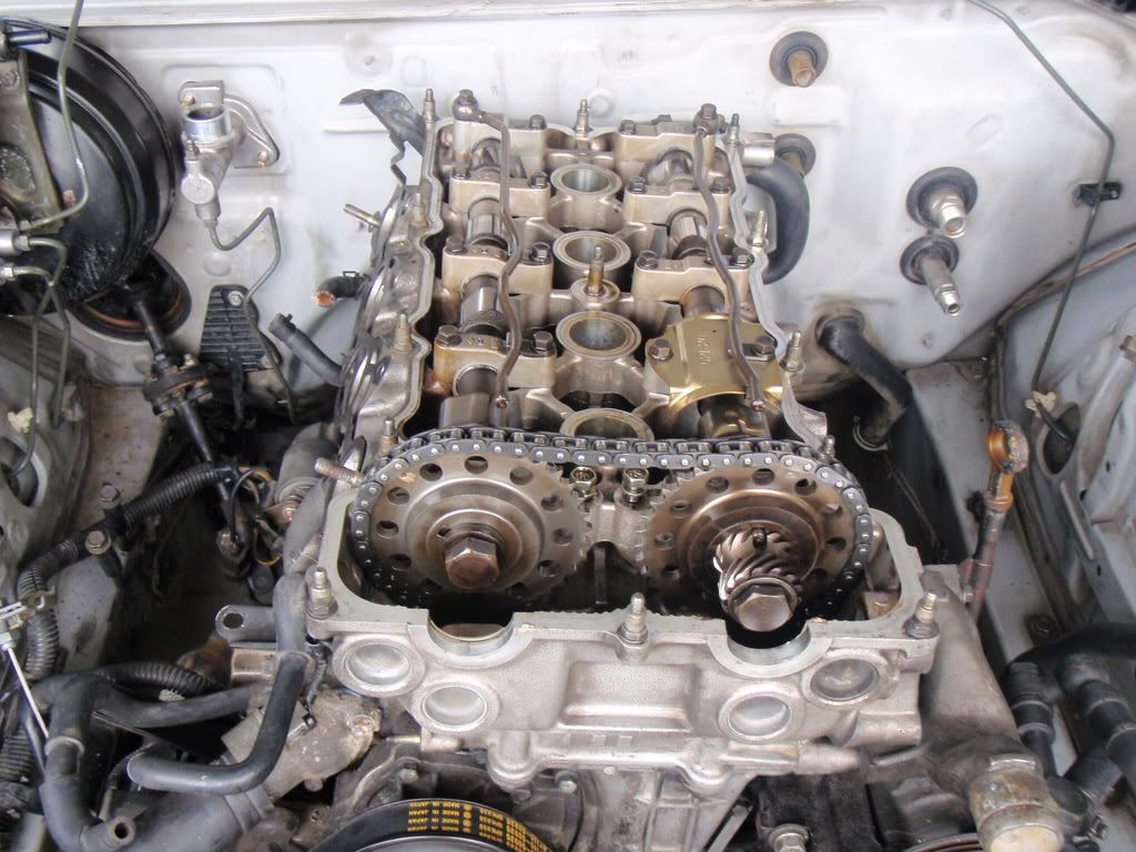

So this arvo a mate and I went at it to try and put in my HKS Cams, HKS Cam Gears and Greddy Rocker Stoppers!
Before :
And thats is it... there is no after cause we had to bail out, the cams I got came out of a Black Top SR with VCT, I was told that the cams should still fit in a Red Top SR but we cam across a slight problem. The cam bolt the bolts the cam gear onto the actual cam itself does not go in the cam due to the cams being specified to go into an SR20DET with VCT and the bolt is to big, So my question is can I retain the cams and use a cam bolt out of an VCT SR20 cut it down in size ( as they are longer to go through the VCT etc ) and bolt up my cam gear and put my cams in and done? Or do I have to get cams to suite Red Top only?
Bit of a bummer cause after cams were done everything else was going to follow and wiring also pretty much, now I have this problem... will be a pain to buy brand new cams when I had plans for other things.
