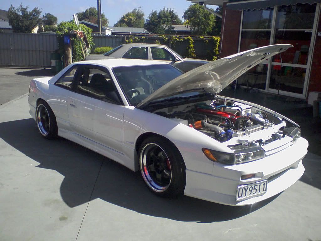

Yep RB30 in a Silvia.
i was gonna say!! where the hell did u find room for it
i tried doing that kinda setup in my R32 GTR and i couldnt find any room wat so ever under the car to do some thing like that
RB30 in a silvia??? dam!! any more details on the caR???
Edited by STR8E180
This is basically how it's wired.
STR8E180: Skylines have the same space underneath.. just they have a hicas pump in that place. And who needs hicas anyway? :) I think it's Hicas...
Widebody S13 with a RB30/RB26 in it. nearly 5 years work :)
wow thats some series respect!!!
did u upgrade the suspension for the heavy front end???
also wat turbo are u using?":?
i still got all the hicas junk under my GTR i just locked it up with a lock bar
Thanks mate.
It has some aftermarket dampers.. nothing amazing but no problems with weight.
Ballbearing Garret turbo. rated for 600HP or so. very responsive..
Remove all that Hicas junk then! bit of weight with all that. ;)
Cheers :P
