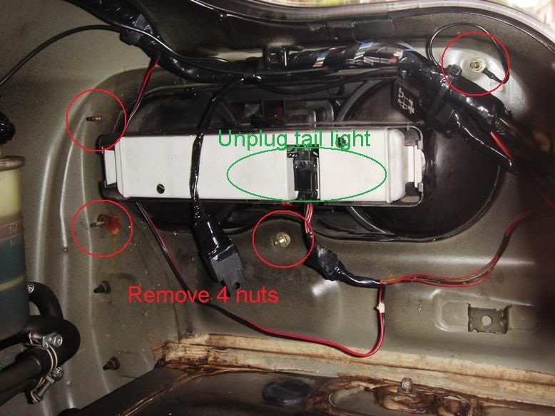

Now, undo the 4 nut that secures the tail light and unplug the tail light.

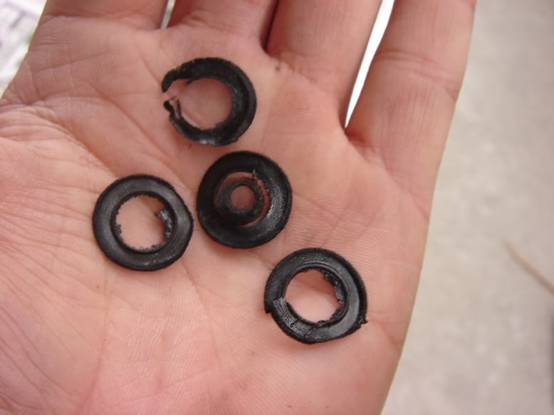

Once the tail light has come off, you want to save those rubber rings as they will be reused when you are putting the light back on.
