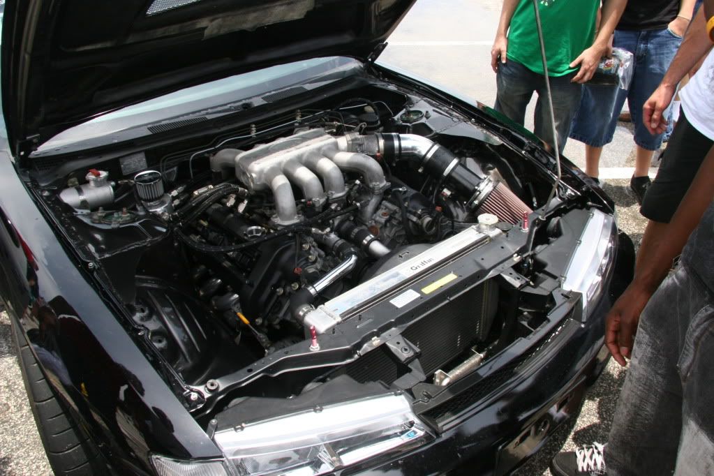

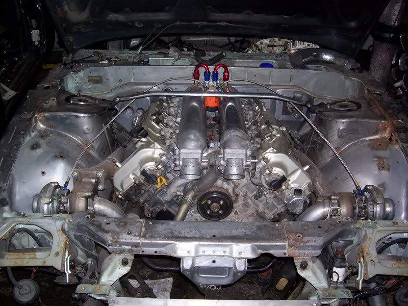

How are you going with the alternator clearance? Most of the US guys have to notch their chassis to get it to clear. Mazworx offer a full conversion kit, gearbox adapter (Z32), mounts for motor and gearbox, extractors (LHD though) and driveshaft. About $2k US.

I've binned the air con and power steering, just knocked the seals out of the rack and sealed up the old fluid ports. Got a heap of goodies for it, 1.5way diff, Tein's, adjustable everythings, Recaro's, 4 point welded cage etc etc. Also got a truck turbo that should work nicely, just have to mount the alternator up in the V to make it fit.
