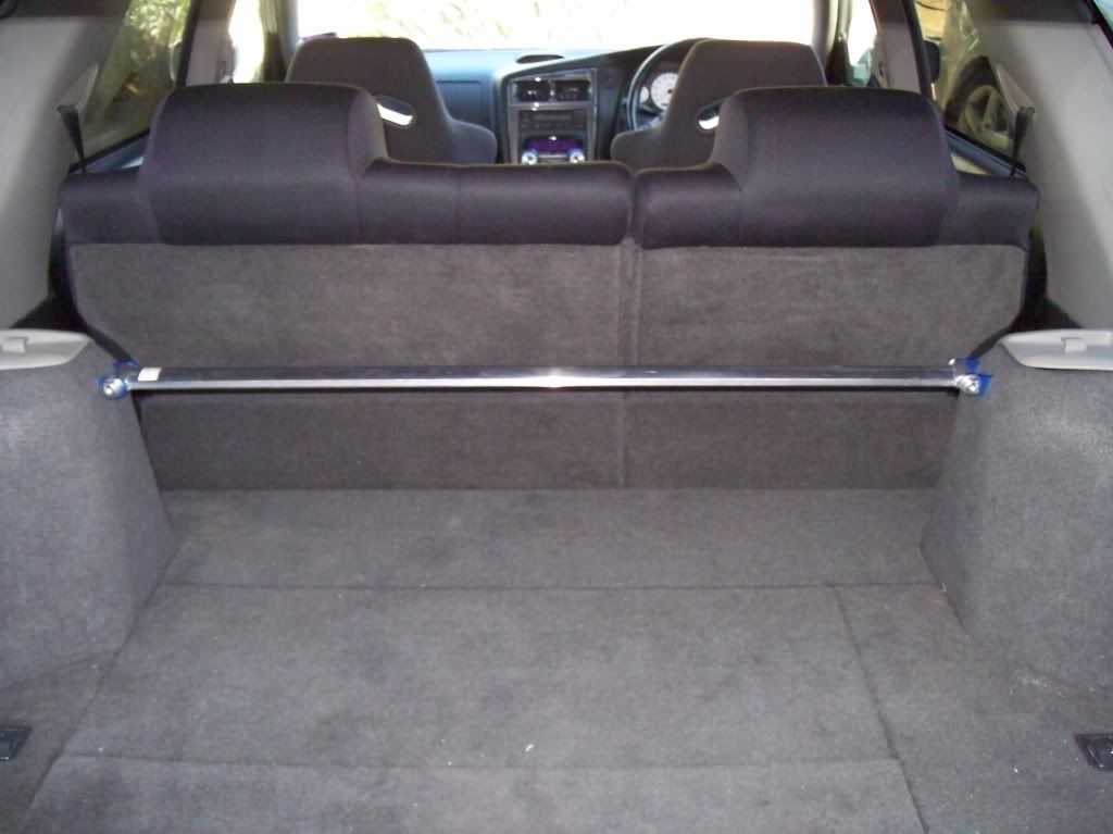

strut brace does impact on boot space a little but i find that most things fit around it etc (sits up pretty much against the back seat anyway) and if you ever need to take something larger, it's 2 bolts to remove the bar - just leave the end plates attached to the strut tops :down:

Probably the most dramatic mod I did myself was......... Once again: the rear strut brace: ties it down so much better, and makes it heaps more tail-happy... For the sake of a couple of greenbacks, I think you'd be hard pressed to find better mod :down:
