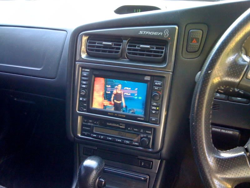

how had is it to get the tv working while driving? easy, plenty written about this over the years, you will need a digital tv tuner that outputs in NTSC and a unit which allows screen to be viewed whilst car is in motion.

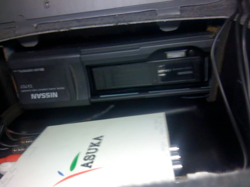

the lower headunit said 'cd change' is the xanavi unit a stacker also? stacker in back

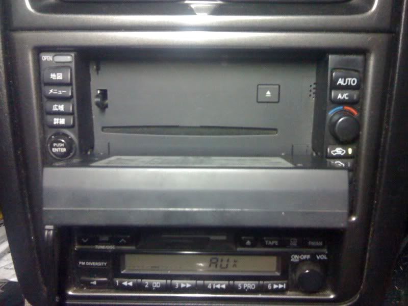

I think nobody's mentioned yet that the xanavi screen folds down (has an "eject" button) and behind it there is a slot-load CD player. Plus when it's folded down it doubles as a drink shelf :D

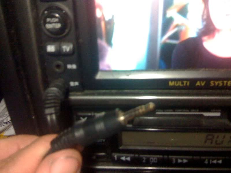

There are two 3.5mm phono sockets (the kind usually found on headphones etc) on the front of the xanavi unit; top is for video and bottom for audio (99% sure could be the other way round!)
To use as an input you press the TV button (is marked in English) and select "VR2" input on the touch-screen.

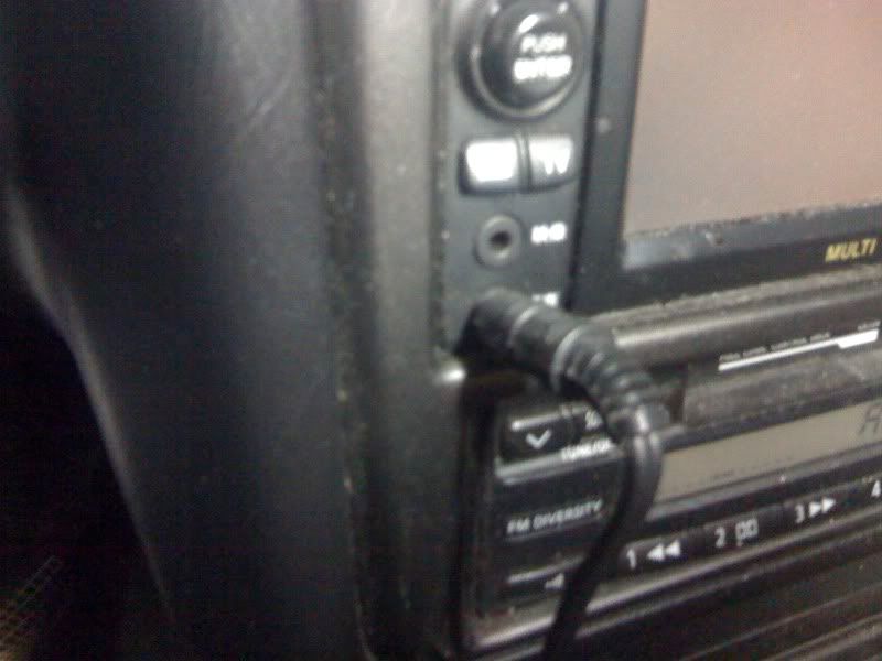

- My iphone plugs direct in the system and doubles as a incar phone kit too- just plug into phone. When someone calls the phone thinks you have earphones in- all audio goes through sound system:

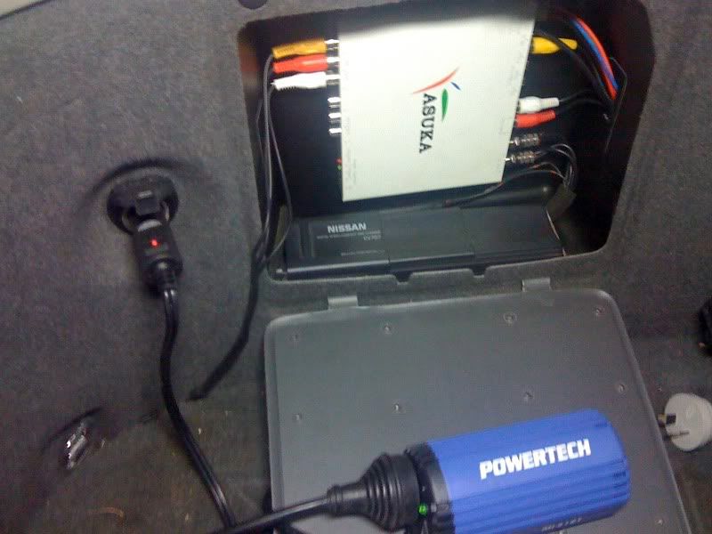

- Standard headunit is linked to a 6 stacker in boot:
- You can also put 1 CD at a time into the Xanavi unit (screen pops down):

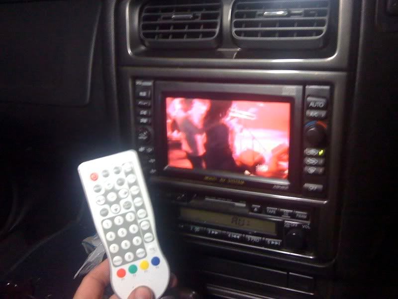

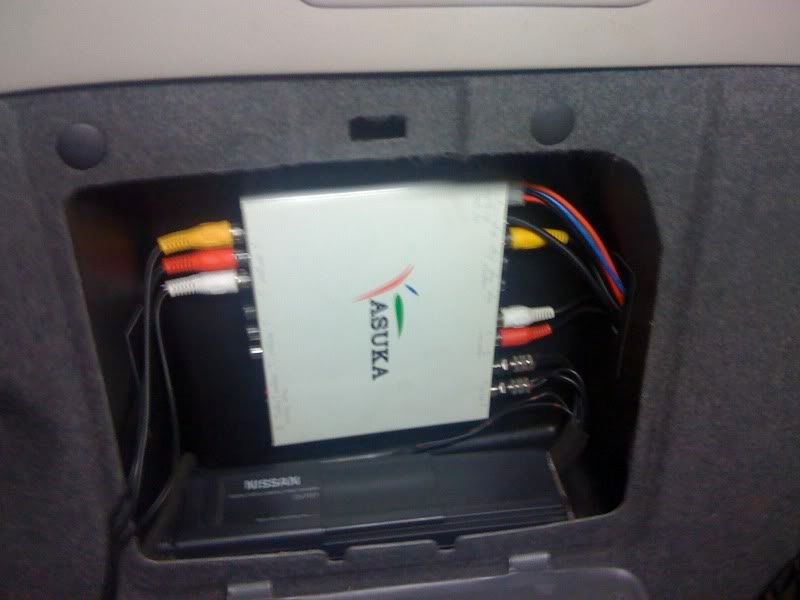

- My Xanavi has a digital TV tuner installed (thanks to chook! Oh and the blue thing is just a power inverter i use to power the DVD player- plugs into power socket in boot, but could easily be hardwired).
