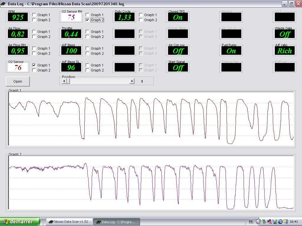

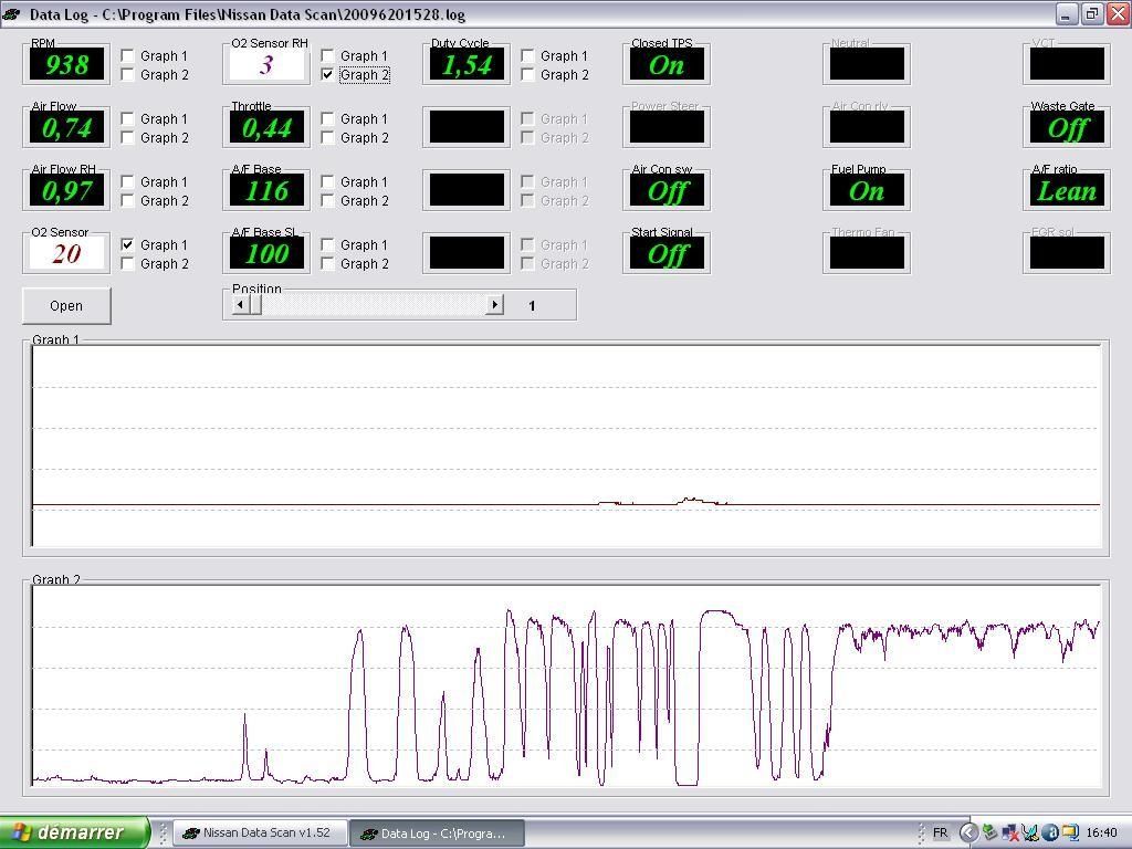

This is what Nissan DataScan shows for a stuffed sensor (top graph):
and with a properly functioning O2 sensor:
Note that the GT-R has two sensors but the principle is exactly the same.
