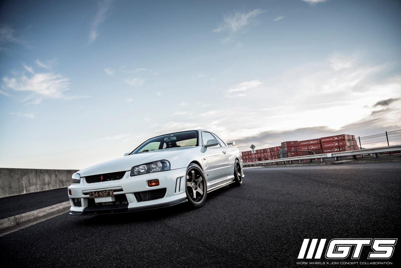

Looking at getting some of these late in the year, JDMconcept told me that this customer had the 18x9.0 +30 and 18x10 +38 but weren't sure on tyre size. Is the owner on here or anybody know what he would be running?

Looks like a 245/40 front and 265/35 rear
might be 255 rear but 265 should fit easy, could even probably work a half to full degree positive camber if you’re making some power to put to ground.
always best to check clearance to your suspension as that will be the deciding factor
I bought that specific set couple months ago for my 34. The tyres I went with where 235/40/18 on the front and 255/35/18 on the rear. Easily could go 265 on rear. I will say I dont think the offset is aggressive enough though. If I could go back I would get a more aggressive offset for the rear.

the white r34 is probably running spacers.
to get that flush finish with some tyre stretch it’s best to use a 9.5 wide wheel with +15-20 offset. You can make a 235 stretch nicely and still fit a 255 at the back. Seems to be a fairly common size amongst most brands
