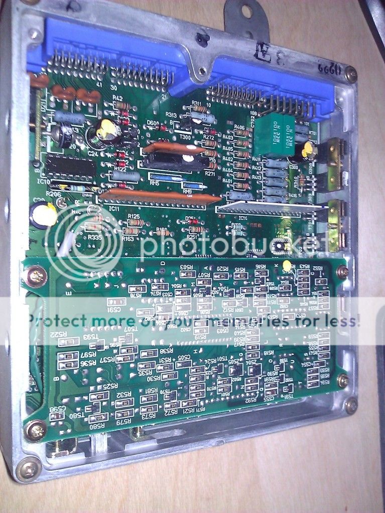

hey guys!
i got a r33 gts-t ecu today, i opened it up and it looks different to my old one...my old one had 1 level of pcb board and thats it, this new one has the same bottom but theres a second level of board, is that ok? why didnt mine have it before?
