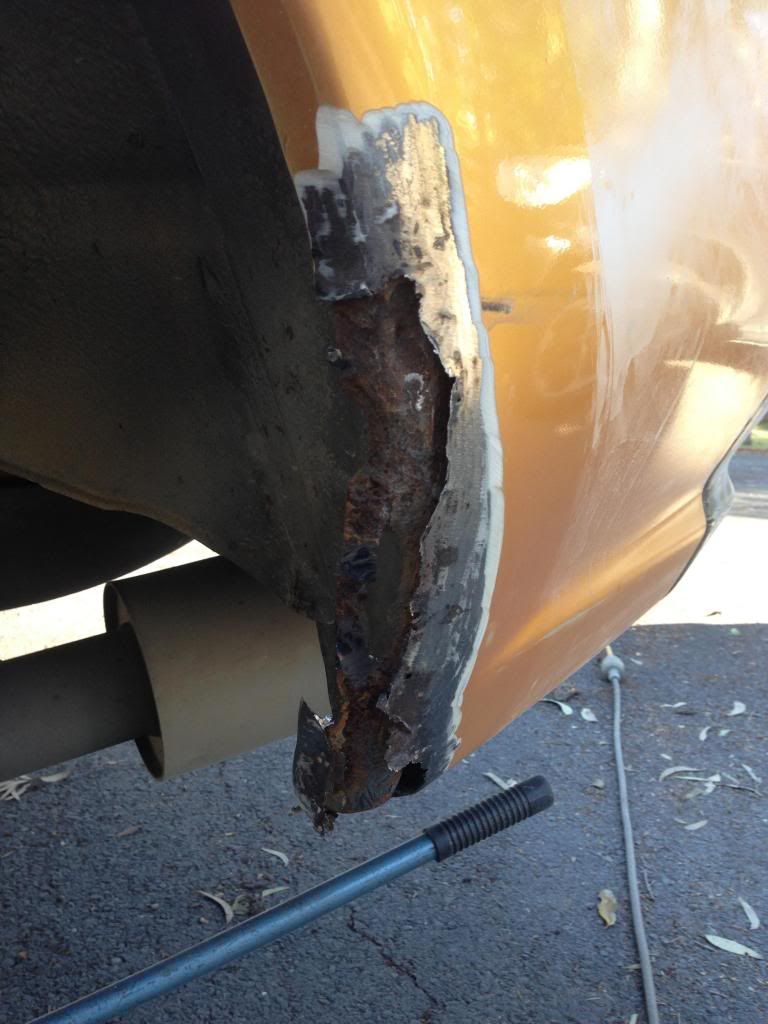

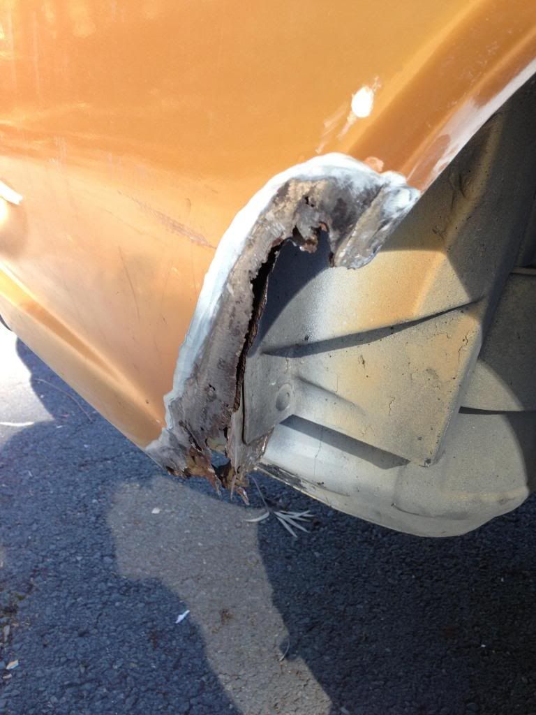

3 50c sized rust spots that look pretty bad..

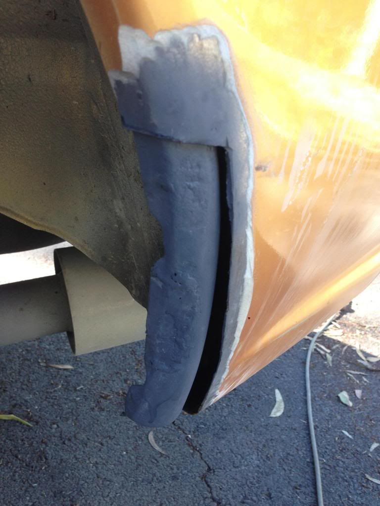

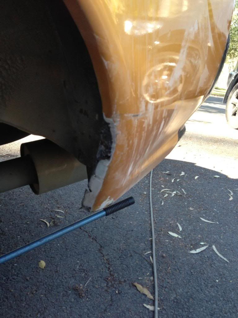

A nice chuck taken out of rear left quarter panel next to wheel and a crap load of bog
There are more but the big one is a bent front left chassis rail.. Just what I needed.

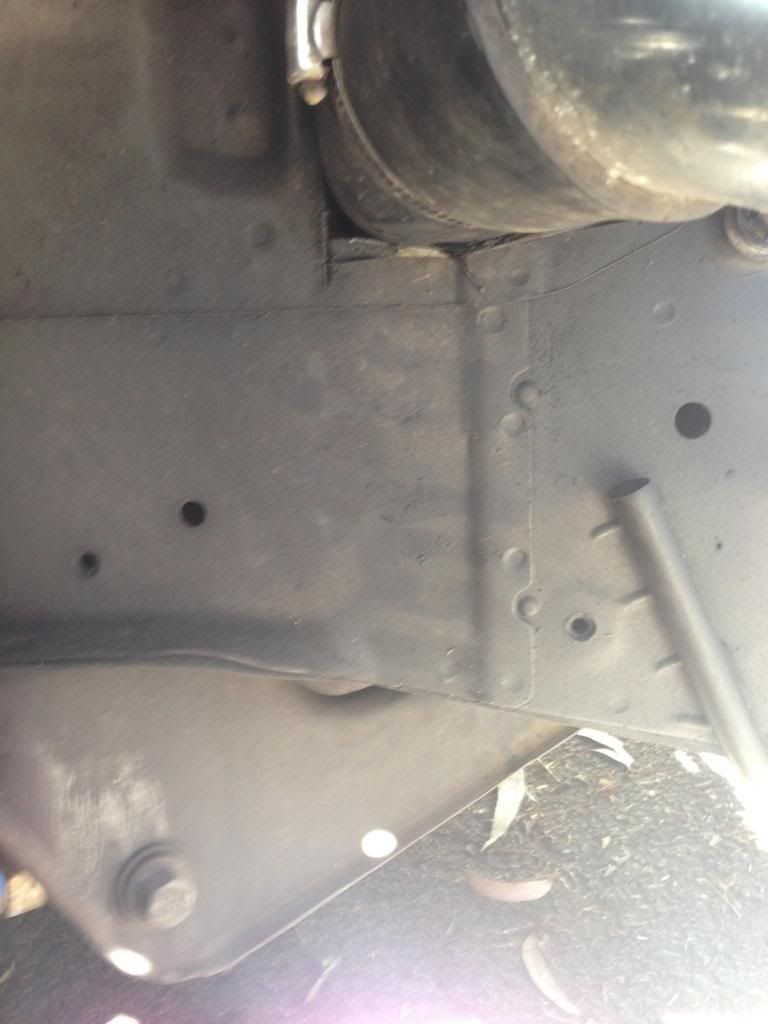

get some hi res pics of that LHS front rail, cant tell much from that picture
if get a full wheel alignment with print out you can usually tell how bad that bend is in how different the castor is on each side,although adjustable castor rods would fix these handling issues

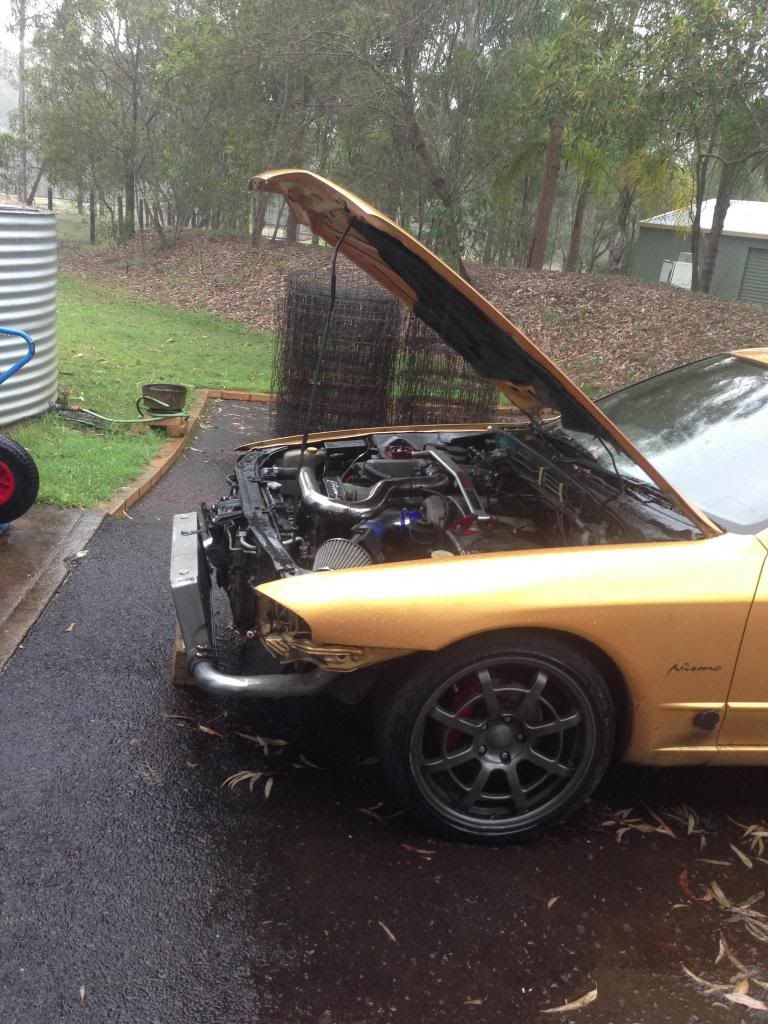

Yeah I know pics are crappy, it started pissing down after we got the guards off and everything.
So I'll be able to take better pics this weekend, it looks like the previous owner or whoever has tried to repair it themselves so maybe it was even worse.
There are a lot of aftermarket suspension bits and pieces under the car but I have no clue to what they are called, other than sway bars and coilovers.
More pics to come.

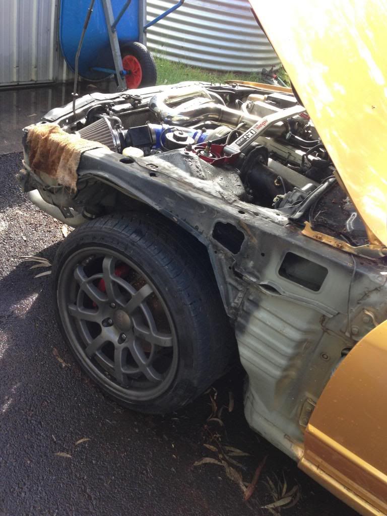

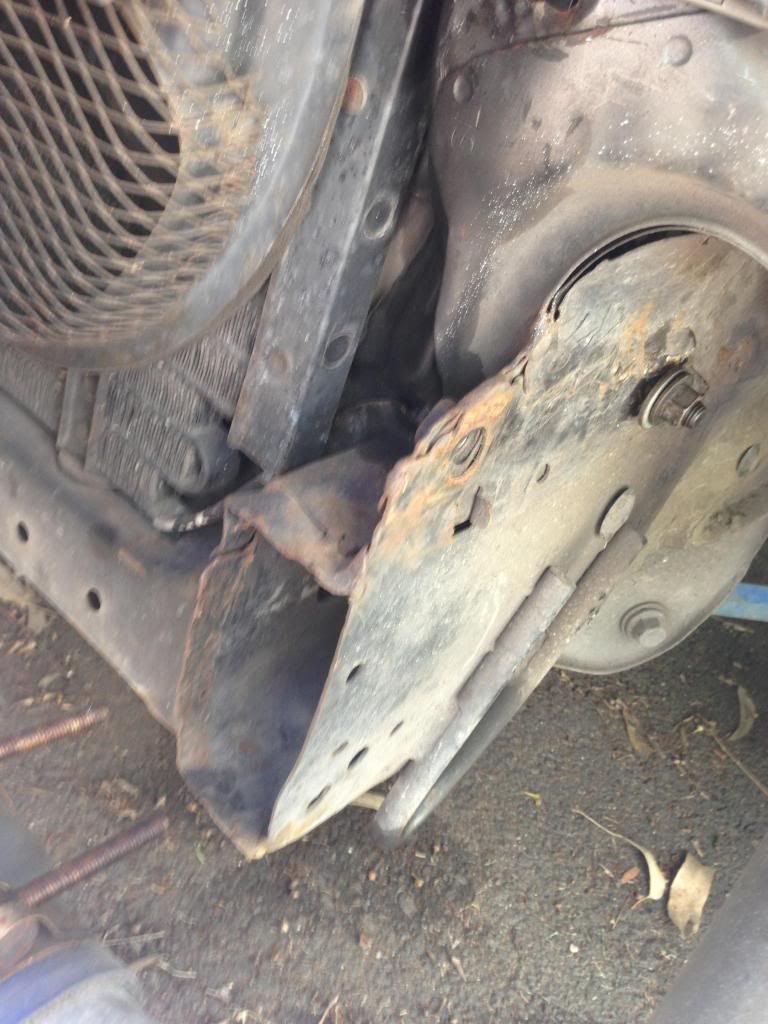

Hey guys got an update & pics! Good news and bad news, unfortunately.
As always, bad news first.
The whole Passenger side chassis rail has been moved back a good 30-40mm. :(

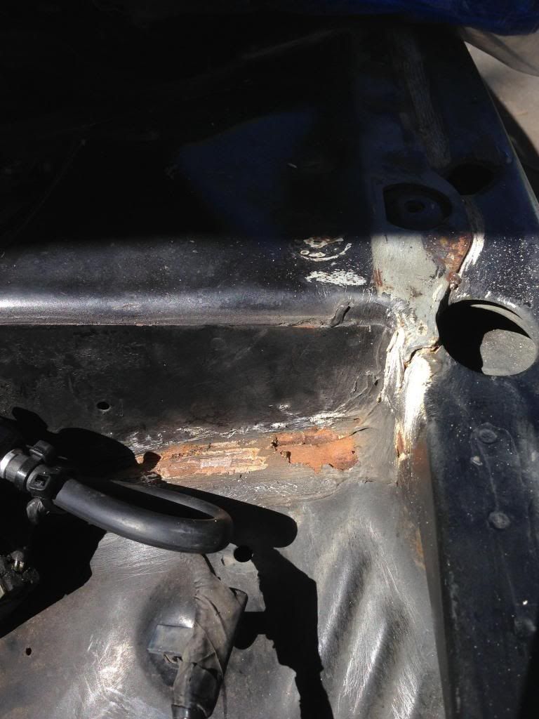

Found a crap load more rust and bog.

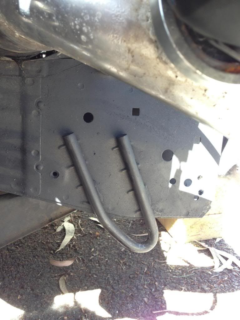

Here are some pictures of the drivers side chassis rail & I'm not sure of the right name but let's call it the under-guard? Lol.. (This side, so far appears to be fine)
Those are pretty much all I took of the good side..
Nice and neat.

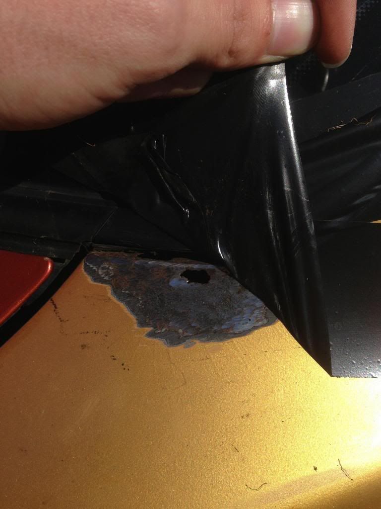

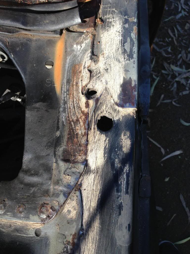

aaaaand here's some rust and bog I ground off
Drivers side
Passengers side
Passengers side 2nd go....

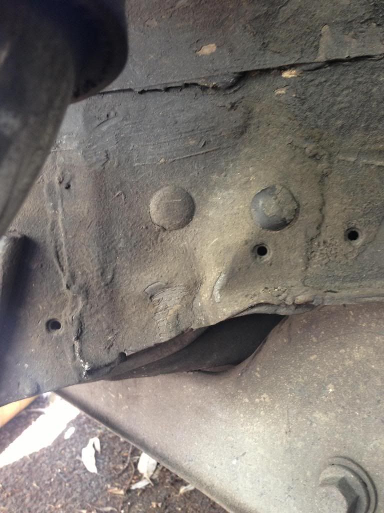

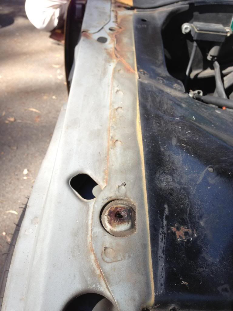

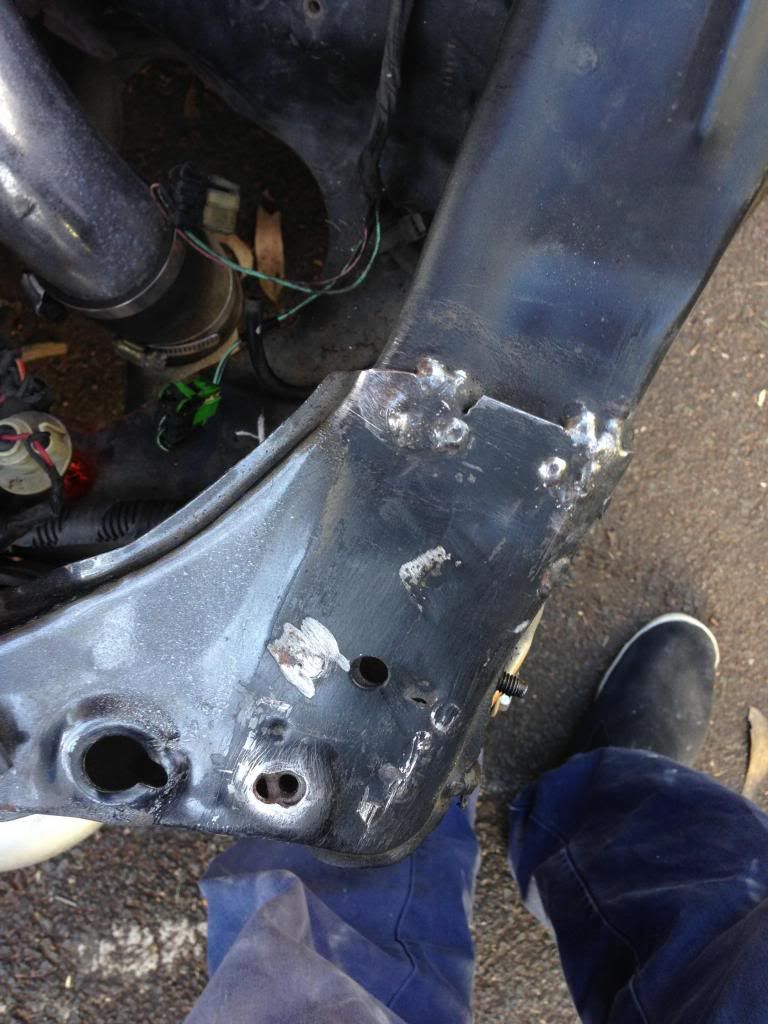

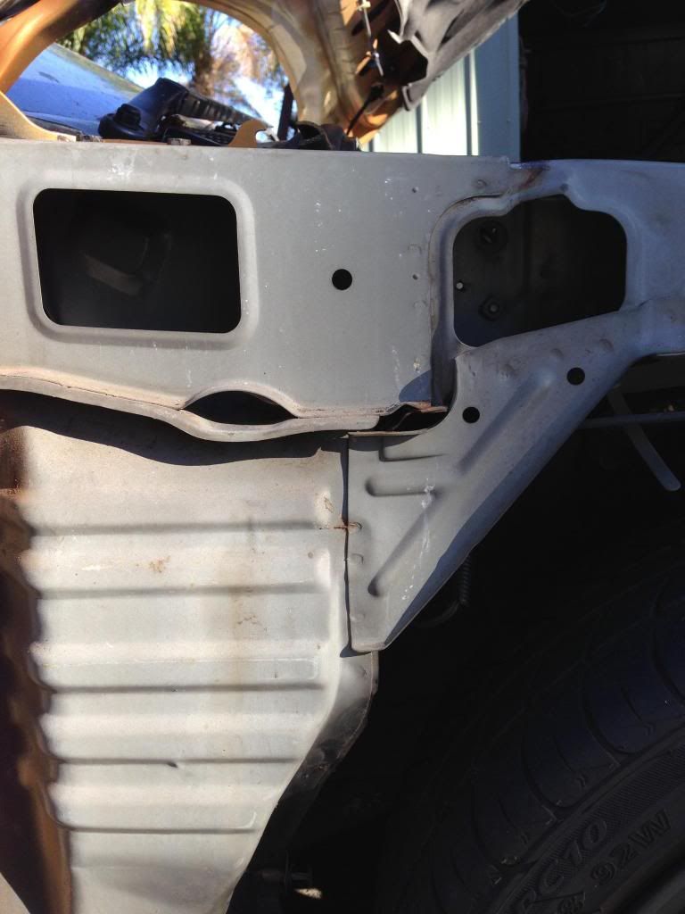

Here is the Passengers side (damaged side), sorry again for picture quality and if they are not "up the right way" oh well, you can still see its buggered.
Under-guard #2 bit of clean up with wire brush:(
Under-guard #3 just above head light
Chassis rail, this has been bent and also pushed back
Chassis rail #2
Chassis rail #3
I will post another one comparing the 2 same sides when I have some time later today.
Oh, good news is I'm keeping the car!
Getting it put on a puller eventually and get ALL RUST out and welding in metal pieces. Using a dolly and hammer to shape the way my pop has for years

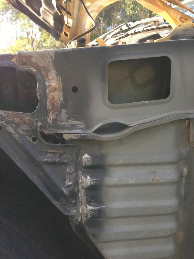

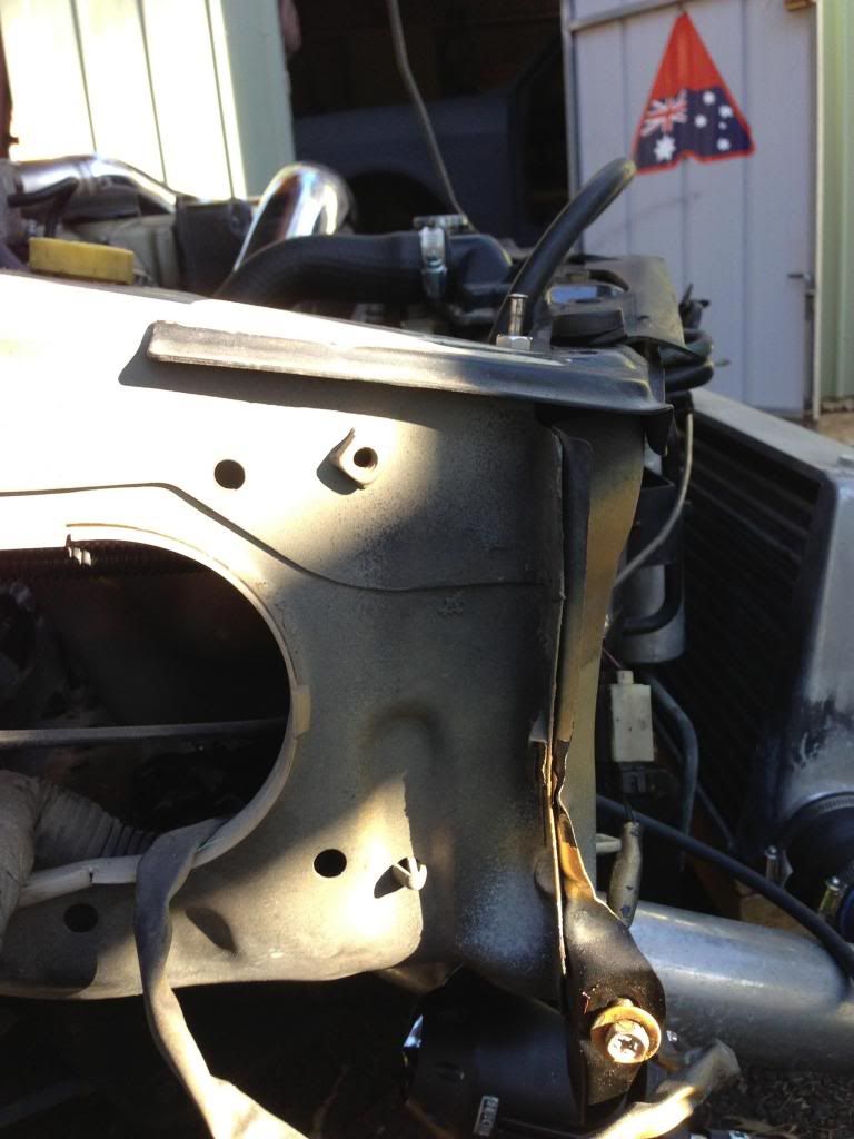

Here are some pics comparing the 2 sides together.
These are pretty self explanatory.
TOP VIEW
Good.
Bad. As you can see it looks like the spot welds have popped out and been welded back and heaps of panel sealant..
SIDE VIEW
Good.
Bad. Scratched are just from wire brush.. Those welds are not factory :(
FRONT CORNERS
Good. (Sneaky picture of my pops GT Cortina coupe that he's restoring)
And once again, Bad.

Those 3 50c piece sized rust spots have turned into holes about the size of 10c piece..
I will be welding sheet metal in its place and cleaning it up.

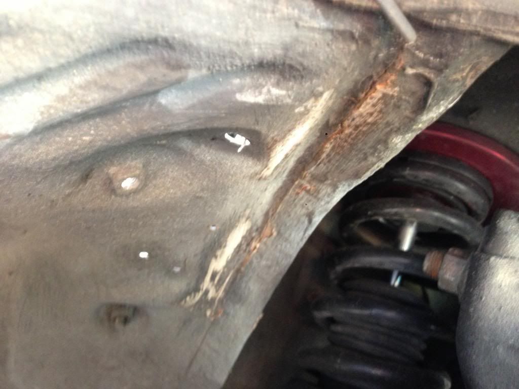

Another update guys & pics.

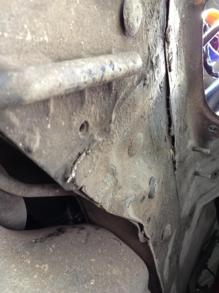

Found a nice crack at the bottom of my strut tower smothered in sikaflex..
Whoever "repaired" the rust on this car just stuck some sikaflex on there to hide it and I'm the lucky bastard that gets to cop it :)
Here is a pic of the the strut tower & underneath after a couple of minutes of scraping..
Sorry for pictures I was on my second beer :P aha

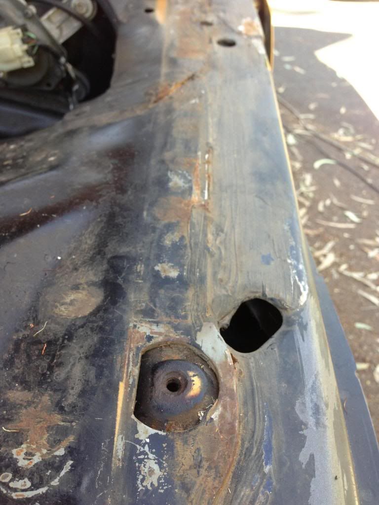

Cut rust out of both rear guards and bent some back into shape, also found some nice sheet metal in the scrap bin I can use to weld in :)
Also the hole at the bottom of rear window..
Anyone know and easy way to remove the rear window? Looks like its been put it with the purpose of never being removed again aha
