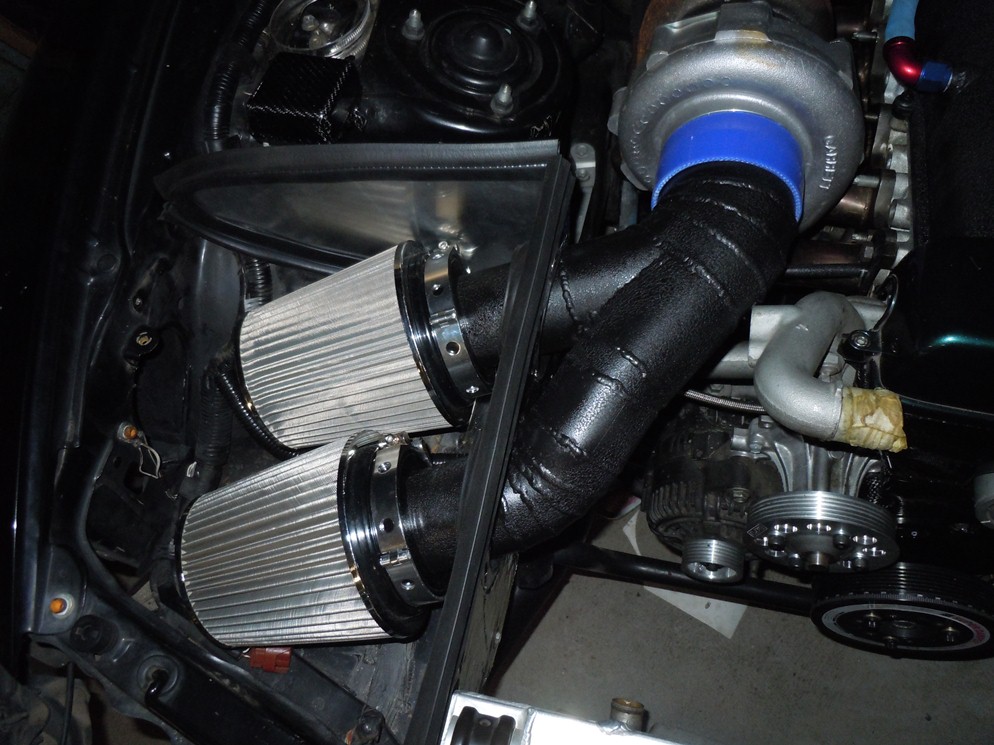

You have heard wrong, the stock paper/cotton filter is good for around 500kw in the stock airbox. A good cotton element would be my choice. K+N or other oiled filters will coat your AFM in crud.
To match the quality of the cold air induction that Nissan originally designed you would be spending big, for little gain. The only time I agree fitting pods is a good idea is when chasing 500+kw, especially when two pods are used. A decent cold air feed from the front bar into a sealed chamber is best, you want to build up pressure in there preferably. This would probably be instant defect on a road car, so unless it's track only, just keep the stock airbox, it's fine.

Your car is not going to exceed the airbox flow at that modification level. No need to improve upon its flow. You will never exceed the airbox. No need to buy aftermarket airbox, if your engine will not exceed the flow capable through the stock airbox. As said above, it will support 450-500kw.
