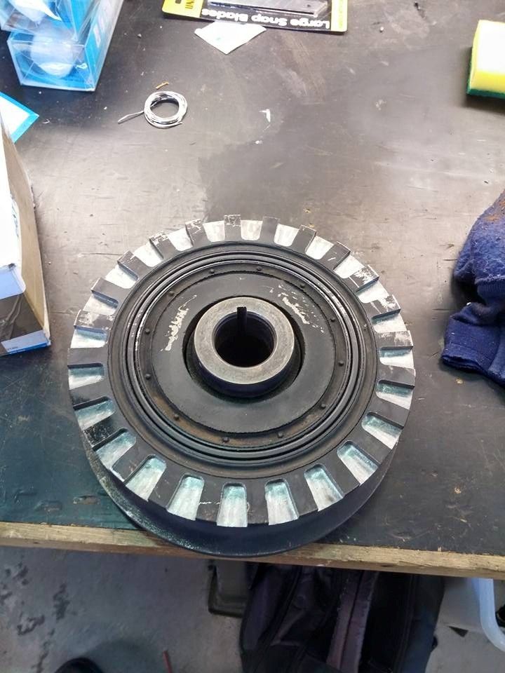

How many trigger points would people recommend when running Haltec platinum pro?
i went with 24 slots as it gives each cylinder 4 points for the ecu reference
