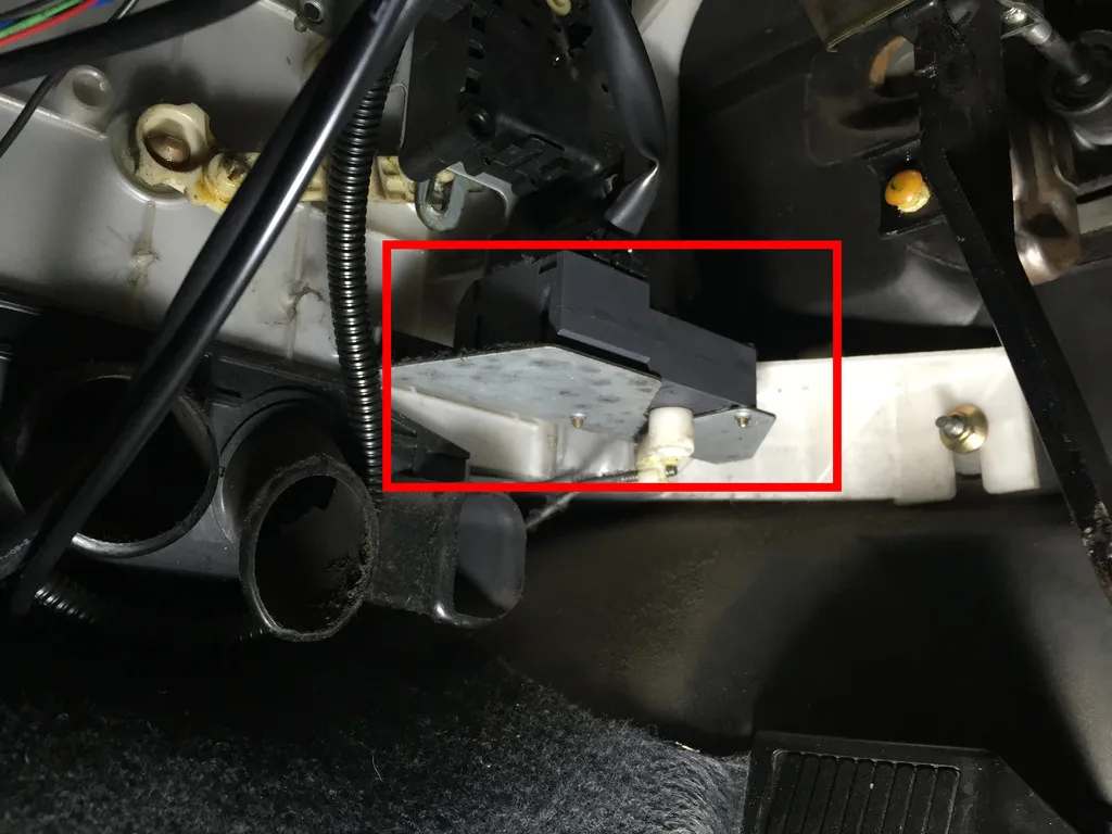

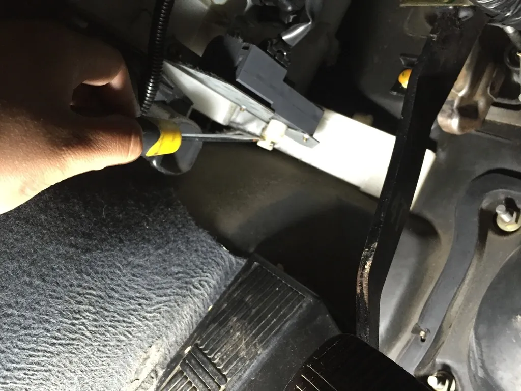

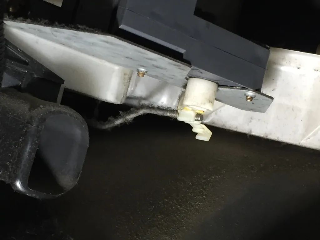

2) Locate the actuator under the drivers side dash to the left
3) Remove cap holding the actuator rod in place, mark the rod for reference and pop the rod out of it's "seat"

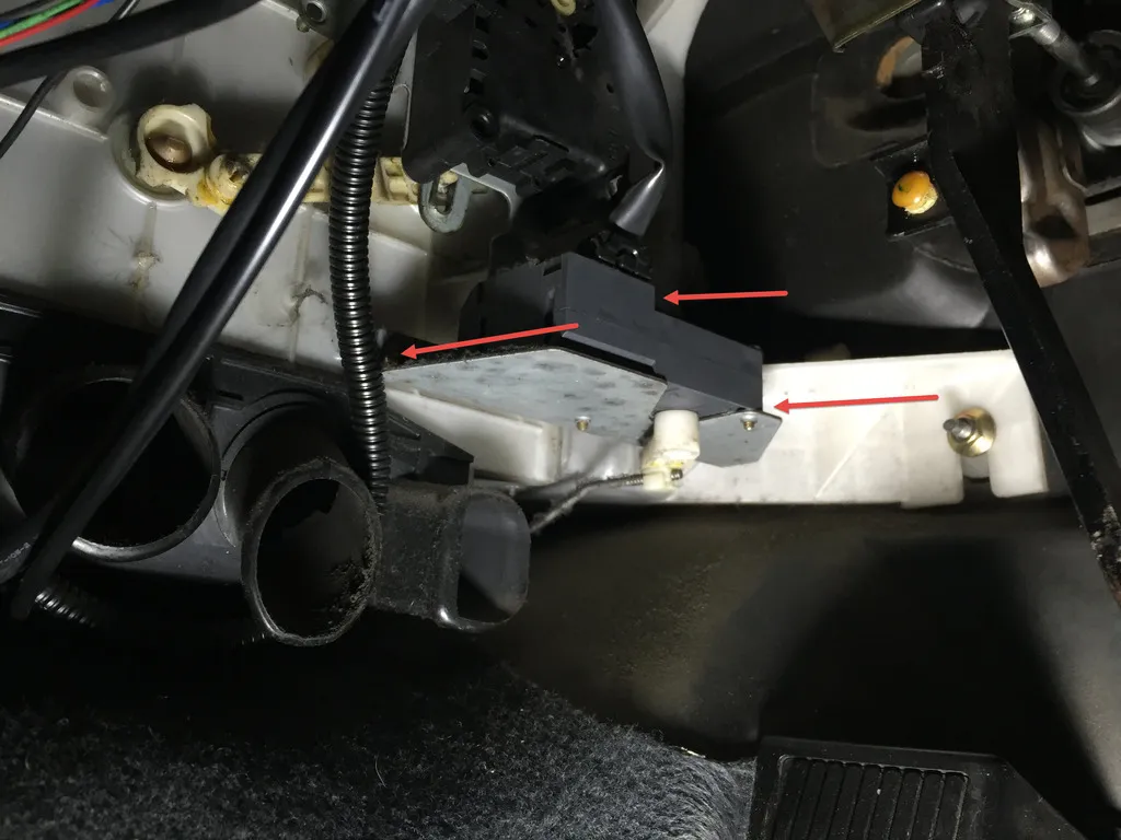

4) Disconnect the wiring connector from the mix actuator
5) Remove the three securing screws shown below and take the actuator out of the car

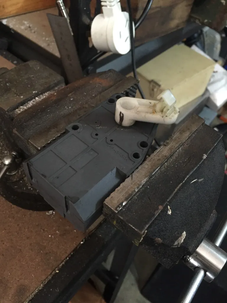

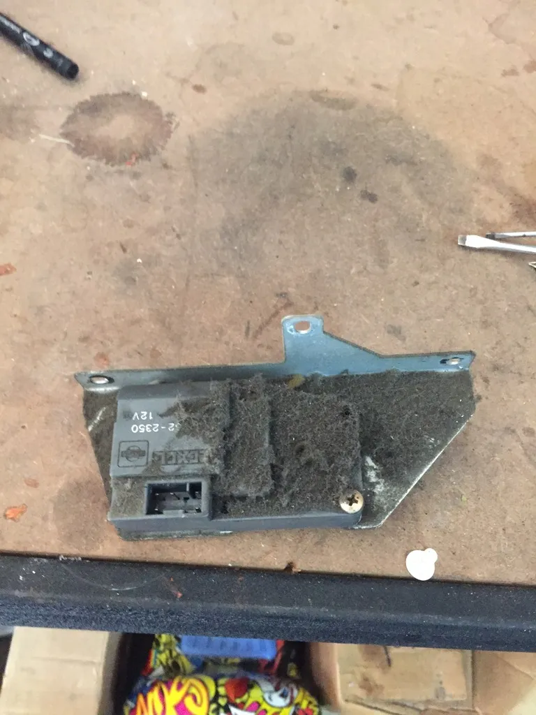

*over to the bench*
6) Mark some reference points on the arm for the actuator - This will make it easier to assemble again later

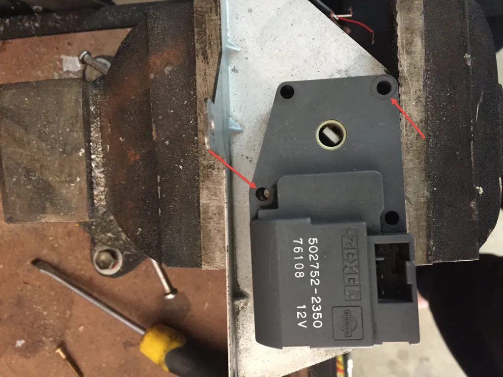

7) Unscrew the actuator off its mounting bracket
8) Remove the two screws that seal the housing

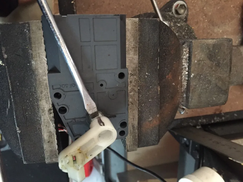

9) Using a flat head screwdriver gently pry the arm off the actuator

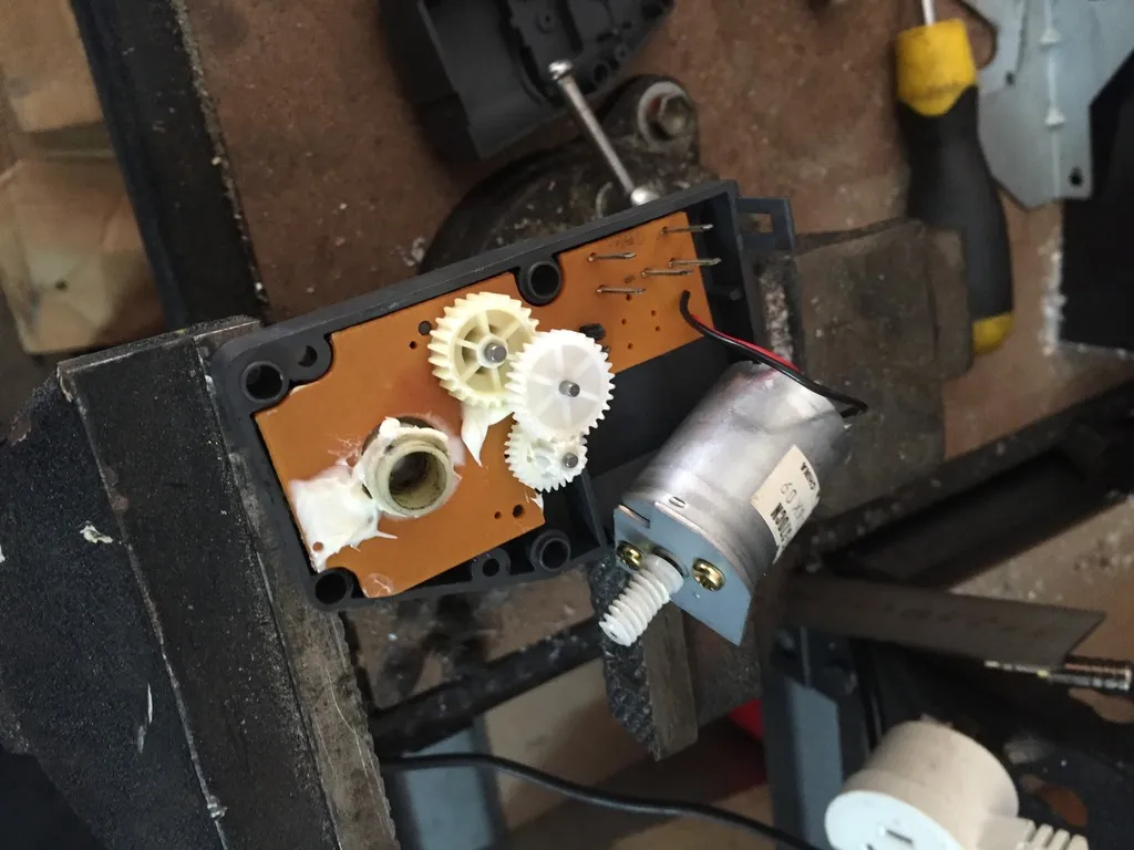

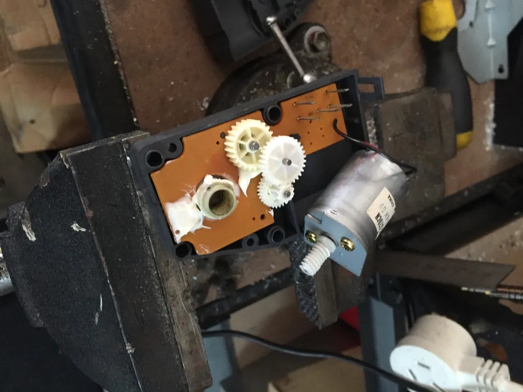

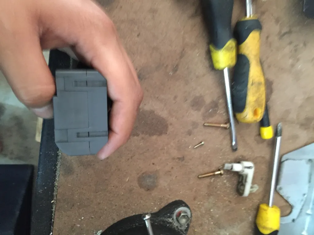

10) Separate the two clips that hold the housing together from the side and gently open the actuator case
11) Remove all of the little gears from the housing and set them aside somewhere they won't roll away

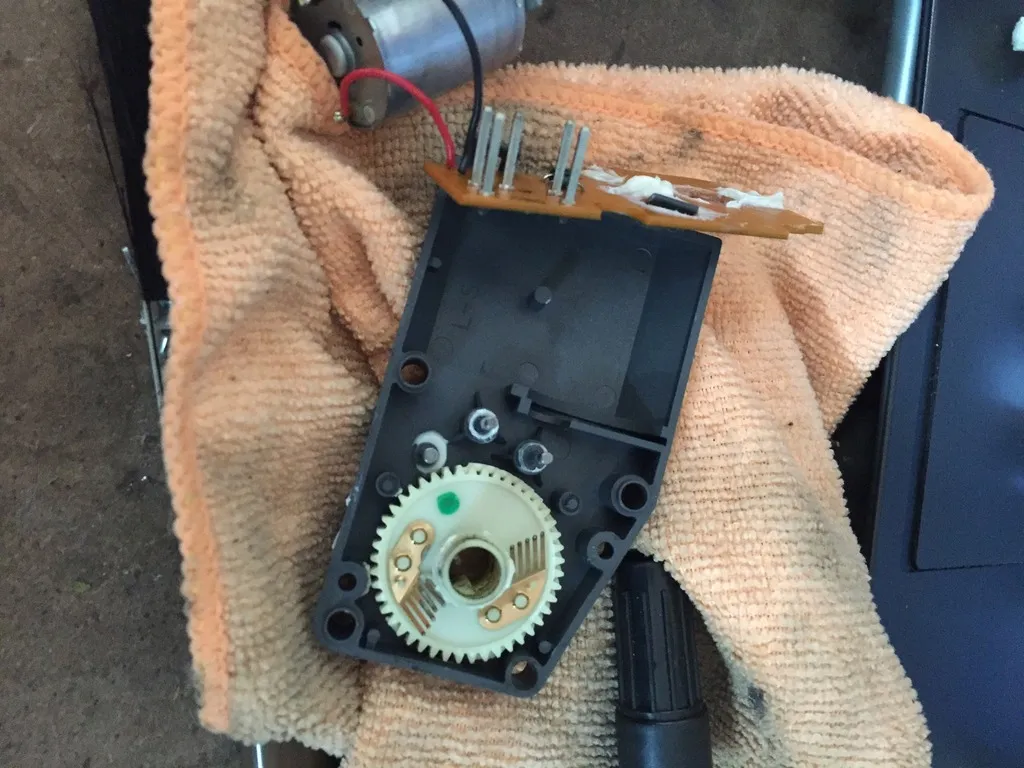

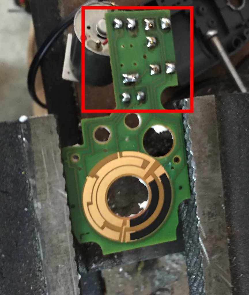

12) Remove the circuit board and motor from the housing to reveal the last large gear with contacts on it

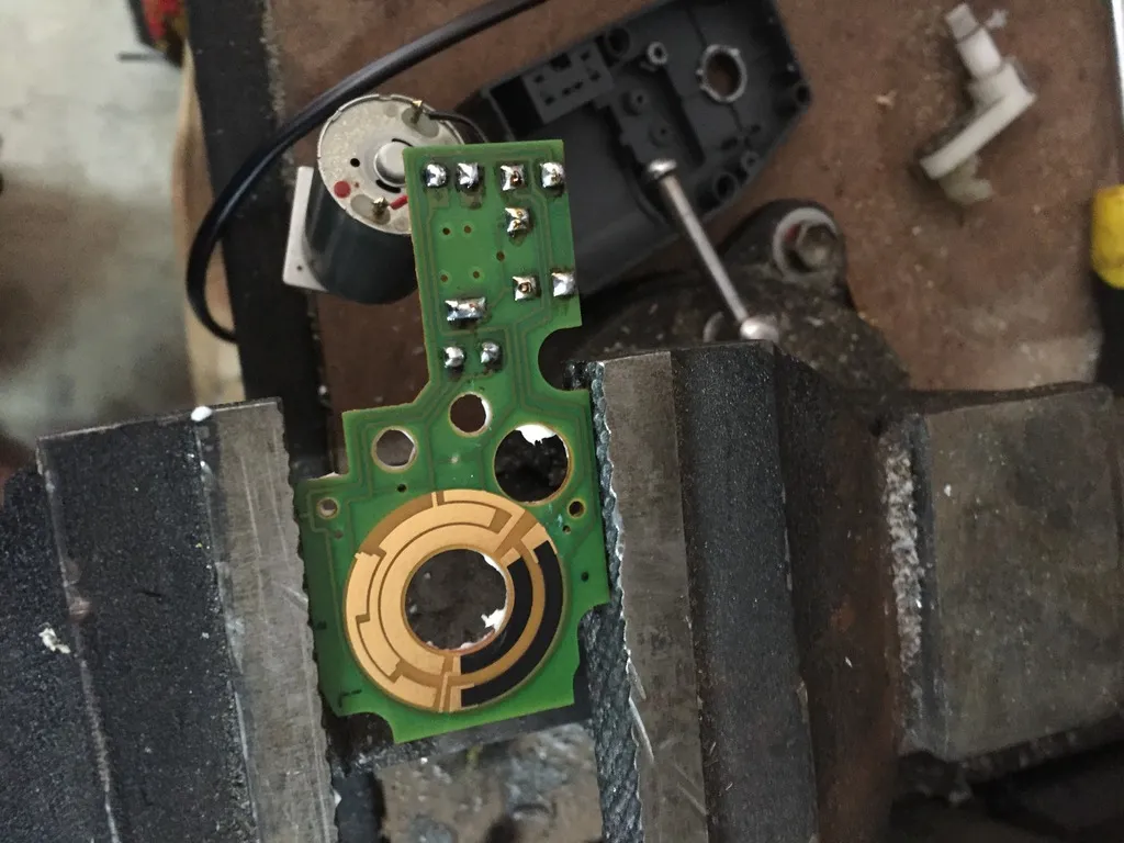

13) Gently bend the contacts upwards to ensure they haven't been worn out and bent over time - Give the contacts a light sand at while you're at it
14) Clean the contact surface on the circuit board - I wasn't sure what sort of grease this was so I left a thin coat on the board anyway
15) Connect a power source to the motor terminals to ensure the motor still functions - If not see the options above or look at a replacement motor (from Jaycar or other electronics stores or eBay)
16) Take your soldering iron and melt the solder on the joints of the board - Take the time to add a bit more solder where necessary
17) If all went well work your way back from step 12 and test the actuator again

does someone have a pic of what its suppose to look like when hooked up on the other side, ive just taken mine apart and put it together and it works when not hooked up to the door but when i hooked it up it wouldnt work, i think its just cause it fell off and now is in the wrong position.
with out it hooked up going full hot makes the arm move to the front of the car.  going full cold makes it move closer to the cabin/gearbox
But i cant seem to get it to line up with the door when i set it too full hot or full cold when i move the door myself
