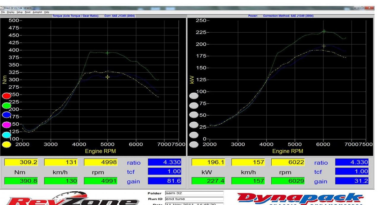

This is some result form an ATR43SS1 Turbo in bush bearing. It made 227rwkws @ 17psi on Pump 98 fuel. I've used the same turbo with BB core on my R34.2  with an RB20det (running with melted cyc 6) which is very responsive.

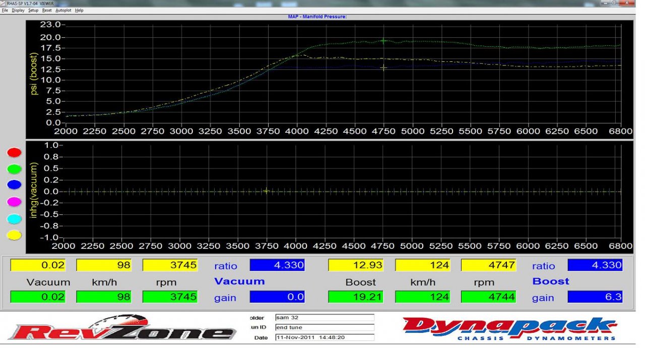

Green boost curve: Same turbo with BB's core.
So around 900rpm improvement in response from BB core??
Is that a typical result??? seems like a lot

Hitting 15psi by 4000rpm (picked that because the curve to 17psi rolls over a little presumably because of boost control so saying full boost at 4700rpm makes it sound much worse than it is) and making 227kw @ hubs, which is a healthy result - but to be honest, it may be my 16G fanboism coming out but I feel that one of those would happily do that power on 98 too, but with significantly better response.   His ball bearing equivalent shows 18psi by 4000rpm, which is more like what I'd expect from the 16G but of course DBB also offers transient response improvements (the old "Dyno doesn't show it" stuff) so that sounds a bit like it'd be quite a nice turbo on an RB20, especially if it's not expensive.

:D yes thats when they were first developed.The turbo is ATR28SS15 based, it maxed out at 281rwkws P98 fuel on an worked SR20det, on a stock cammed Rb20det it should be maxing some where towards the 250rwkws depending on mods.
I bought a R32 GTS4 late last year and trailed a bunch of other wheel and housing combinations and that is still the best one, BB improved transit response and made the turbo came in with very light throttle movement. Unfortunately I've picked up a bad car, its unfit for the building purpose, I might get another one to continue this venture when I see something come up decent.
