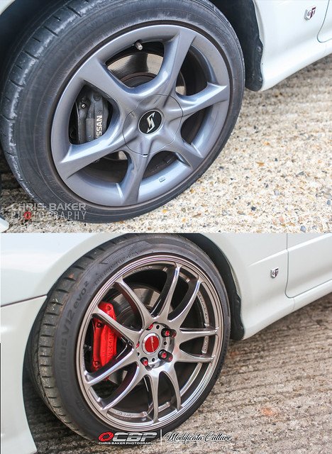

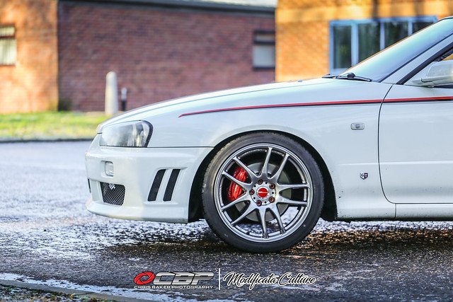

The new tyres for the Work wheels arrived and i didn't waste any time getting them mounted and fitted to the car. The front ride height is left untouched from the 17s, the rears were raised 20mm (its still veeeery close to the arch lip)
I think playing it safe with the offset of 30 was a wise decision, it may not be the 'fitment' that kids nowadays wanna see, but i think its perfect :)

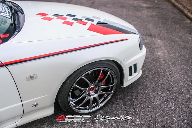

A big thank you to Unique Signs & Graphics in Norwich for designing it all from scratch and for fitting it. These were also the guys who designed and fitted the HKS livery on my MX5

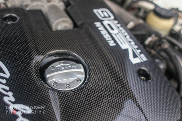

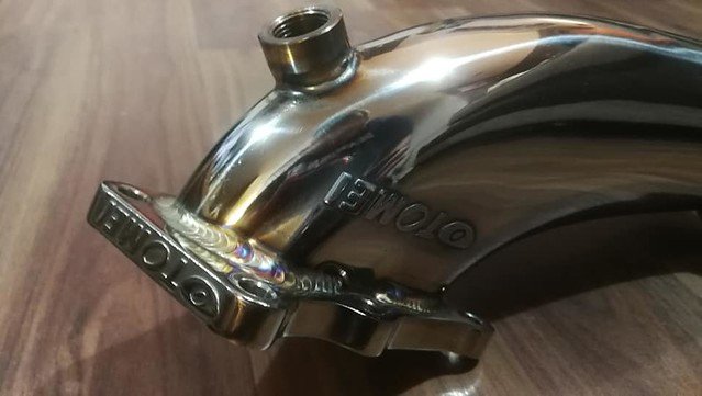

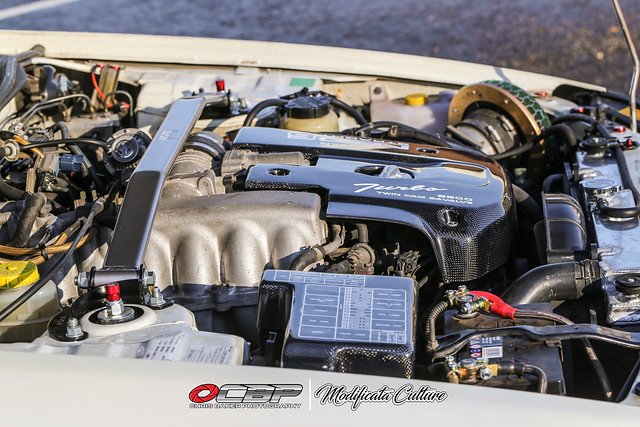

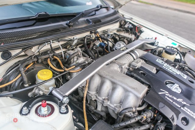

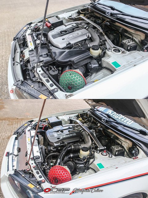

My Tomei Exhaust elbow arrived from Japan via Nengun. The quality and workmanship on this is incredible!
I found these on Yahoo Auctions and JDMParts Rupewrecht arranged the purchase and delivery. Originally they had a 2-3 week production time as they're made to order. But these were ready to be shipped within a week!

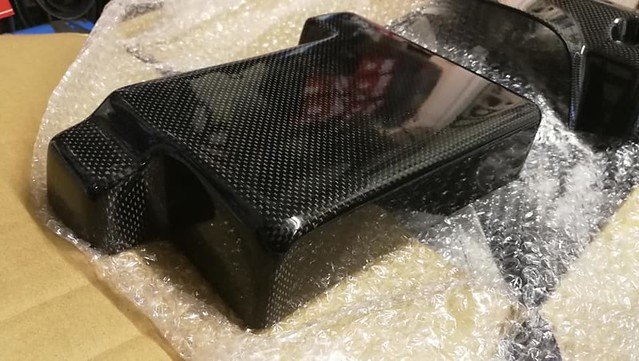

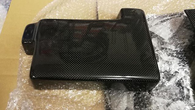

The quality is very good, the pieces are quite thick so not thin and flimsy like some carbon/FRP parts. They've certainly got some weight to them!

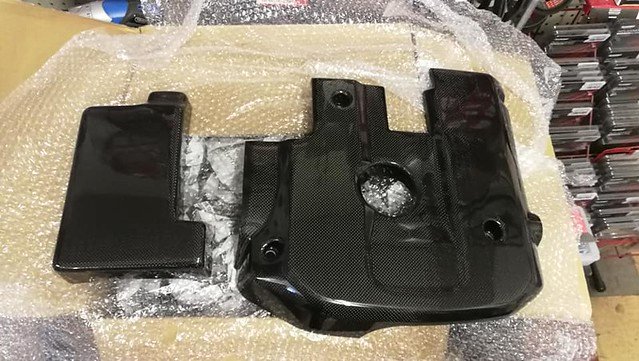

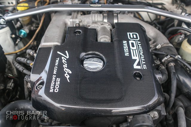

A friend of mine is currently cutting out the engine cover text aswell as the fuse box diagram to help keep them looking 'OEM'. Plus it breaks up all the carbon

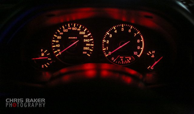

It was a very nismo christmas this year! Lu spoilt me rotten by buying me a Nismo speedo cluster
I also treated myself to some Nismo goodies from Nengun and Yahoo Auctions
Spent Boxing Day afternoon fitting it all
Which brings me to my next mini update, engine cover stickers!

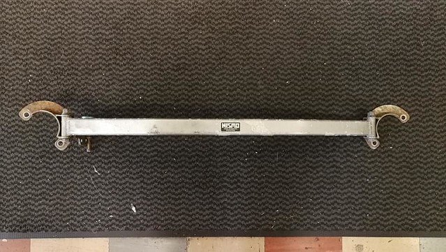

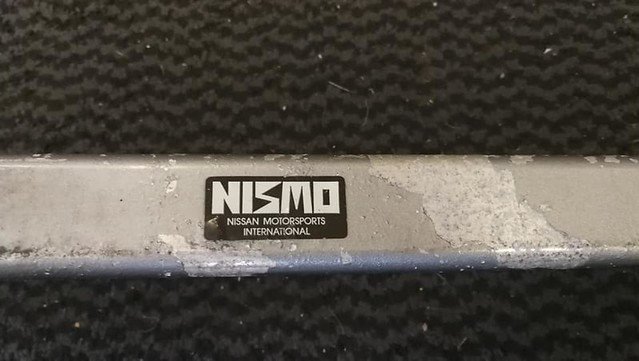

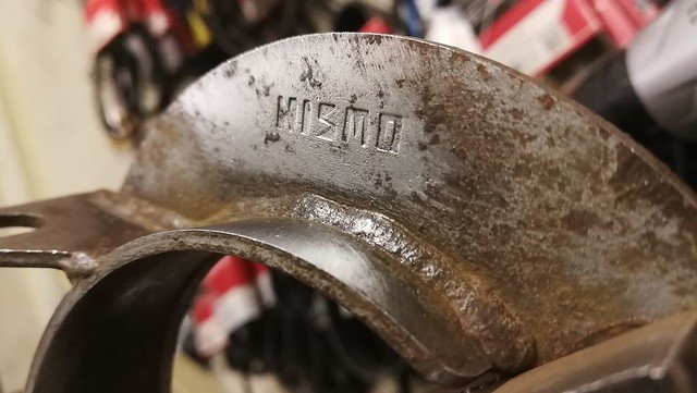

Keeping with the Nismo theme, i purchased an R33 strut brace with brake stopper on eBay. The brace had certainly seen better days so i started to refurb it.
And heres the finished item

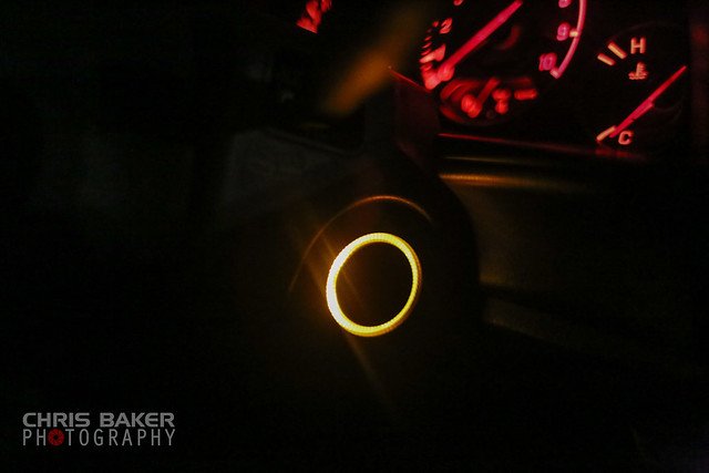

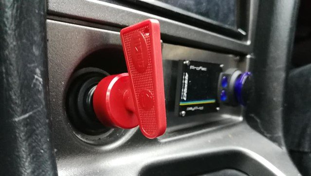

Another little change I made was to swap the bulb in the ignition barrel to an amber one, to help match the red/orange illumination in the cabin

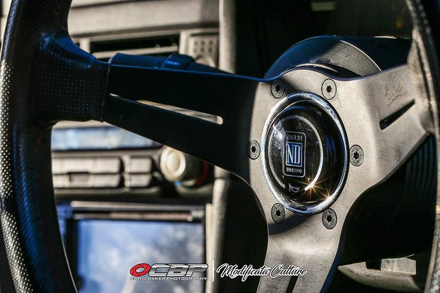

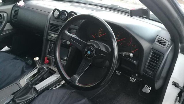

Although the interior was clean looking and stock, I felt it needed a lil bit more. I had a Nardi Deep Corn steering wheel stored away from the MX5, Driftworks supplied a HKB boss kit and the Nardi was promptly fitted.
Upon fitting the boss kit and testing it, i noticed something on the floor mat. I had only gone and snapped the locating pin on the clock spring....f**k! I removed the hicas fuse to temporally disable it until i could sort it. I had a couple of options, replace the clock spring and potentially have it happen again or delete the hicas.....which brings me to my next update

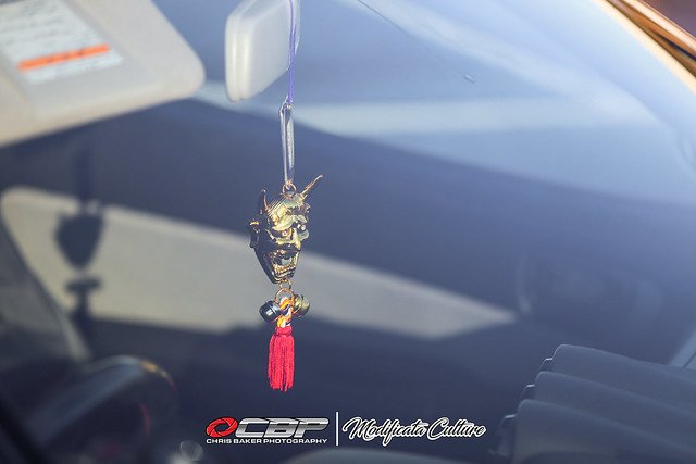

Fitted a tsurikawa and a hannya omamori to the 34

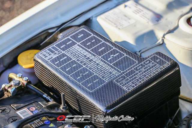

I've finally got fuse box diagram sticker fitted, it finishes off the carbon a treat

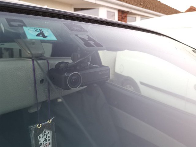

With the dash cam plugging into the back of the unit, you can view the Camera aswell as play back recorded footage and photos. The camera has a built in shock sensor, a message promptly appears if the car has been hit in your absence, and you can review the footage straight away.

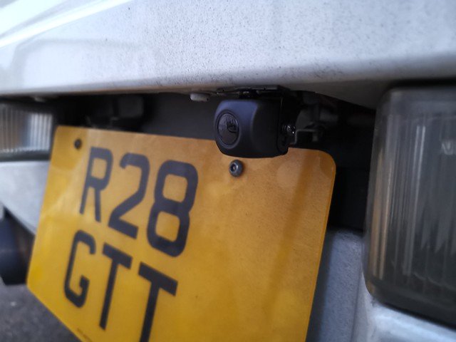

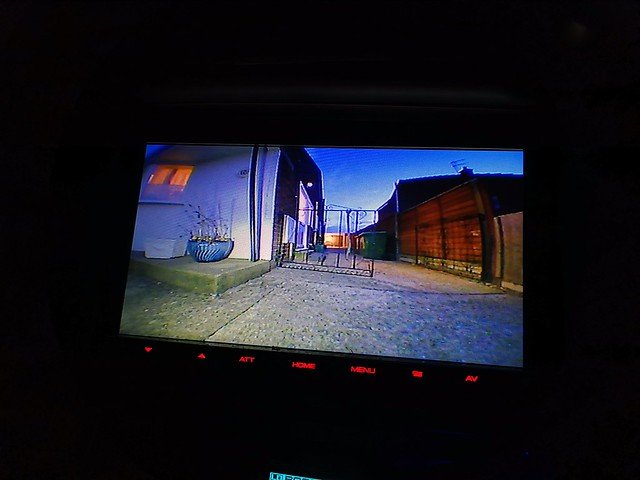

Another feature the Kenwood unit has is a reverse camera. You can pick up a generic camera off eBay or Amazon for not a lot of money but I didn’t want the extra grief of splicing and hoping the built quality would last. So I went with Kenwoods unit and I’m glad I did. Direct plug and play and all I had to do was splice into the reverse light loom

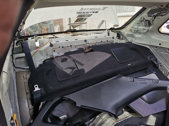

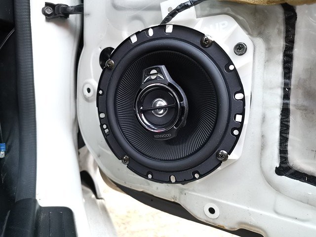

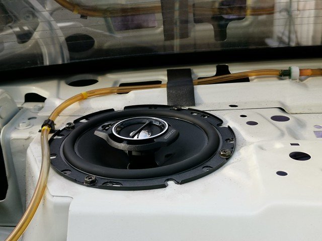

The rear speakers have been crackling for awhile so this was one job that needed addressing more than anything. I didn’t know what I was letting myself in for until I was half way through it…
The rear seats, door cards and trim had to be removed before I could touch the parcel shelf. The parcel shelf area was covered in a black dust, thinking it was the parcel shelf material disintegrating, I was wrong.
As you can see, there wasn’t much left of the stock Clarion speakers, no wonder the sound quality was so poor! The new speakers dropped in a treat and I managed to reuse the original fixings. At the point I wished I had bought the wiring adapters but nevermind.
With the rear interior put back together it was time to tackle the front speakers. This was ALOT easier, a few trim clips and screws and access was easy. Luckily the front speakers already had the adapters (weirdly enough) so that was plain sailing.
I did buy some sound deadening pads to put on the inside but space is limited and daylight was becoming less and less. I’ll tackle this at a later date.

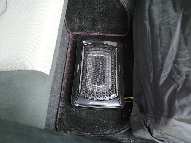

The last thing on the list was to install the slim subwoofer. I was hoping it would fit under the seat, but upon removing it I didn’t realise the centre is humped and tapers down. So I decided to put it behind the seat instead.
The wiring is a lot simpler, all of the wires go into a single plug, none of those nasty terminal screws we had ‘back in the day’. The hardest part was routing the live cable through the bulk head (wheel and arch liner off and it’s straight forward from there)

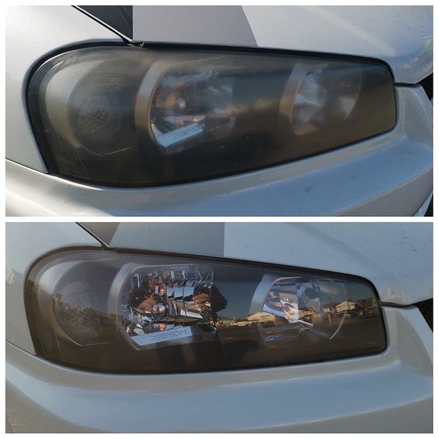

Not long after I purchased the car I used the Turtle Wax headlight restoration kit. Unfortunately it didnt last long before the lights became cloudy again. I got recommended by a friend of a mobile company who do them for a very reasonable price. So I got the car booked in and well....the photos speak for themselves!

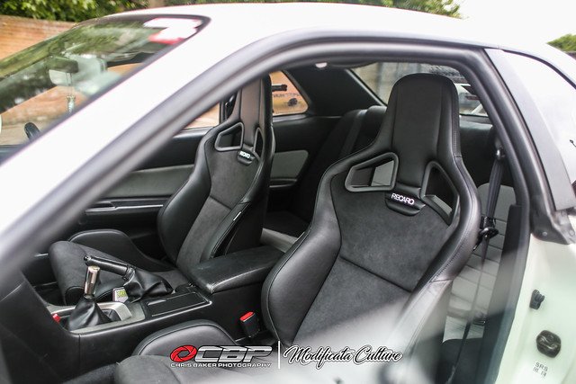

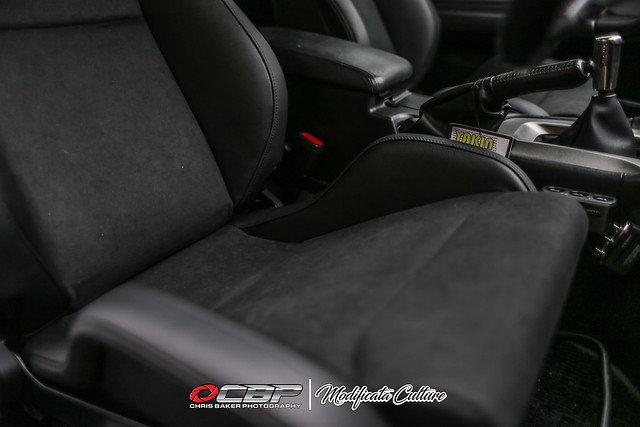

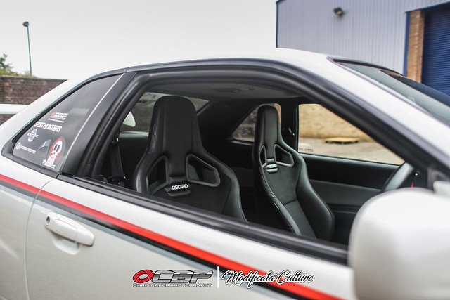

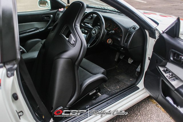

I've been looking at replacement seats for a couple of months but have always been undecided on which ones. Last week we took a visit to GSM Performance to consult with the sales team on various seats and to try them.
Being a 'bigger build' comfort was top priority, and trying the seats out before commiting was a major advantage. It was a tough decision as there were so many nice seats,but in the end I went for the Recaro.

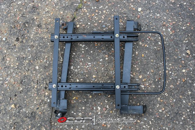

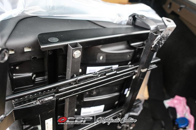

I managed to source some R34 GTR Bride rails that had been modified to fit the GTT. Upon ftting I noticed the Recaro seat mounts were alot wider than the rail. Several hours of swearing later, I had some brackets made up and everything bolted together.
I'm unsure if the GTR seat rail is different height wise, but the seats do slope down which has changed the driving position abit

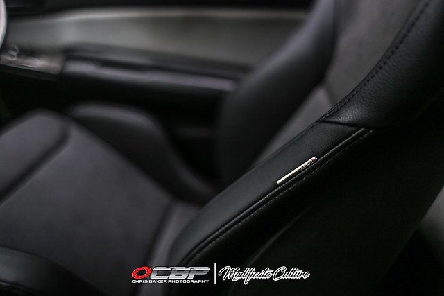

One feature I really like is the reclining lever that's neatly camouflaged into the harness cut outs.
The suede centres make the seats pop alot more than the all leather equivalent
Its abit snug inside, the side bolster does currently touch the doorcard. I'm hoping I can modify the mounts I made to bring it over abit.

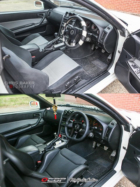

After 24hrs the seats had marked the doorcards quite badly, so I had to sort them out ASAP. I removed the doorcard to have a look, hoping I could modify and retrim the arm rest. But upon a closer look the whole door card would need re-doing and I didn't really fancy all that work. So I adapted the rail mounts instead.
I started with the driver side by drilling another hole next to the first one, the seat was still hard pushed against the doorcard. To explain it briefly it required alot more moving over than I first thought. The bracket on the rails was fouling the bottom of the seat so those had to be cut off. The belt buckles were too short to be bolted to the rear inner rail mounting hole so additional brackets had to be made. Then it was a headache trying to hold the seat up to get said bolts in while holding the seat up to line it all up while making sure the belt buckle didnt fall down.
*sigh*
But I finally got it all sorted and theres still room between the seat and the centre console.

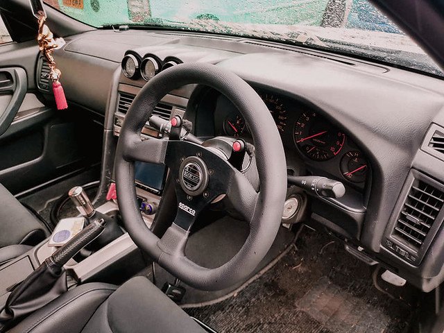

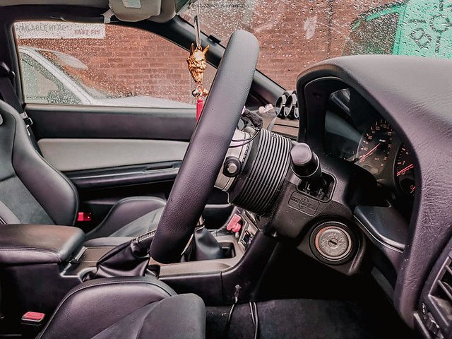

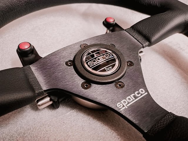

With the seats in I have to admit it was abit of a struggle getting out without brushing against the steering wheel. I decided to go with a quick release steering wheel, but it had to be a slim version. A friend had a Vac Motorsport race quick release for sale which would do the job nicely. The centre of the quick release boss looked too small for a horn button, so he included some Fast and Furious-esque NOS buttons to use as horn buttons.
The Nardi deep corn wheel has served me well in pretty much all of my cars, but it was time for it to retire in favour of a smaller, more modern equivalent. I decided on the Sparco L360 in leather, mainly for its 330mm size and it's flat bottom.
Of course,this wasn't going to be an easy job, not with my current luck lol
I wanted to mount the horn bracket inbetween the HKB boss and the first half of the quick release. This was to make the wiring neater and hidden. The first half uses a Nardi bolt pattern (whats the problem with that you ask?)
Well...the horn button bracket uses a Momo bolt pattern. Even redrilling the bracket would make it lean over to one side and not be central. So the only way was to mount it between the second half and the steering wheel. Luckily theres a gap between the two brackets, the wires were heat shrunk and taped to neaten it all up.
Once it was all mounted together, I lined up the supplied horn button from Sparco and it fits :/ Just my luck lol
