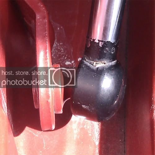

Below is a picture I pulled from another thread, this is the part of the strut that is hard to remove. Very hard, but not impossible. What we did was use my 10mm spanner and wedge it in between the ball and the strut, then slowly work the it off. It looks like it's going to snap the strut and it ends up destroying it, but that's ok because new ones are cheap.
This is what mine looked like in the end.

We ended up putting 100nm of pressure in each cyl. It holds the boot fine with a genuine GTR spoiler. If I had to do it again, I would put 150nm in each to see if it holds any better, BUT that 100 works just fine.
