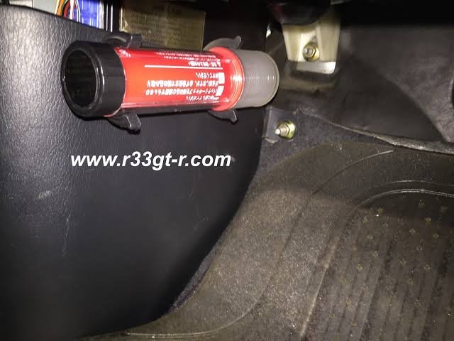

Third photo is a fire extinguisher holder. Most Skylines (all, if I’m not mistaken) came with portal fire extinguishers but most have been removed.

I believe that's for a flare (not fire extinguisher) as required by law in Japan.
Actually, now come to think of it...I think you correct. Then some people place fire extinguishers there but originally yes it was a small black flare.
People don’t put fire extinguishers there because it will be hard to reach while in the drivers seat, usually it’s on the right hand side of the passenger foot well or under the drivers/passengers seat. Also the flares are red.
  • Like 2
Right, you are (photo of flare on same spot).
