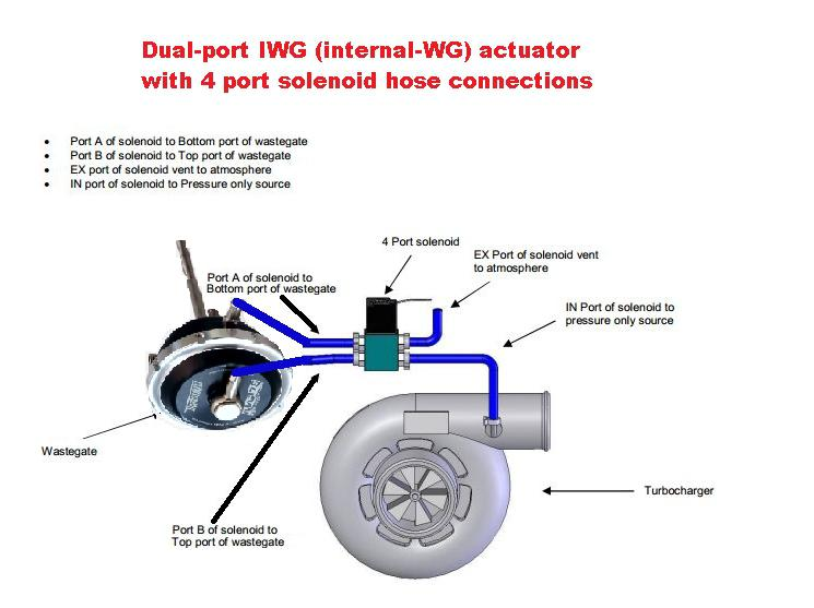

Sure you have the turbosmart plumbed correctly? How is it controlled - by your aftermarket ECU?
Yep, Turbosmart actuator was plumbed following the image below for 4 port testing. Boost control seems to work fine at lower RPMs... so I don't think its the plumbing. I'm using a Haltech Platinum Pro for the ECU.
Its behaving like it has really high back pressure, I can use normal duty cycles (~20%) at lower RPMs (0-4000) but I have to quickly ramp in a lot of DC at rpm increases (e.g. 65%). If I use >65% DC at higher RPMs boost quickly jumps from ~16 psi to ~30 psi (probably maxing out turbo) as I move out of the linear range for the MAC valve.

Yeah good call probably something I'll investigate in the future, but I'm a little worried about introducing a leak. From what I've read, unless something is seriously wrong, backpressure should not be an issue given this setup + boost level... BW MatchBot predicts an EMAP of 29psi@7000rpm with 20psi boost.

With 4 port control it can hit 30 psi with 70% DC but it's not controllable / consistent as small changes in DC results in massive changes in boost pressure (can't hit the pressures between 16 and 30 psi). I believe this instability is fairly standard behaviour for 4 ports.
