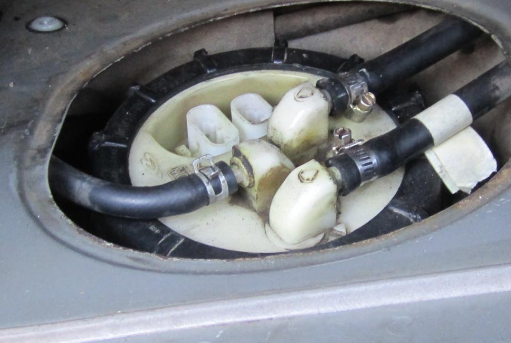

Replaced fuel pump 9 times, some dead pumps, some melty wiring.
IMG_20161226_103455.jpg.39fe38ccd38c703e21188ec9b2b1f454.jpgDeatschwerks.thumb.jpg.9744d45e77ac05a4f46b591ebf1058e7.jpg1201351770_Walbro460L.jpg.df972ff7c7252e610fa1219399b0ee6e.jpg457610758_PumpTesting.jpg.878eb36d1676deb9b58d38b6b73e9e5c.jpg
Also managed to somehow break a R34 fuel tank multiple times, in the red circled area!
465222281_Tank2.jpg.756a10ae1b1b9dc864759cac15e09f51.jpg1427487215_Tank1.jpg.e8a29d378c10aba6d91299ad9995b247.jpgImage0778.jpg.97be306c91ee54f27902edd14039edd5.jpg

I mentioned that I had gone through many fuel pumps earlier, and some of these melted due to wiring (aka outside barwon prison) whereas others actually simply died, ground themselves in to dust.
I went through a phase where I was pulling out the pump, cleaning the filter on it outside of the car and putting it back in once every 2 weeks or so, and it was clogged with shit. Every time. And the bizarre thing is it kept happening, even though the fuel tank had cracked and been replaced.. twice!.
When this happened for the third tank we decided to pull the tank out and clean it, which involved us basically filling the tank with kerosene and other caustic liquids, and shaking the tank above our heads for 30 minutes each, alternating with this superbrew of hell inside it in the hopes of breaking things down. When we eventually emptied this we found about 50 leaves in the tank as well as a whole bunch of gunk.
But not being people for half measures, we forcibly flushed kerosene through the fuel lines with a high pressure washer, to really, really, absolutely, clean them out. This actually worked, as the foulness that came out of them was beyond belief. We then eventaully put the car back together, and relaxed feeling happy we had finally solved that one.
Except what we didn't know is how desensitised we'd become to the smell of Kerosene through dealing with it the whole day/weekend. I drove the car to work on Monday in an underground parking lot for work.
Half way through the day the site got evacuated due to property services investigating the horrific smell coming from the car - The kerosense was so strong that you could smell it from a good 30m away from the actual car, enough that you couldn't tell exactly where it was coming from.
So yeah I didn't let anyone smoke near my car for quite some time.

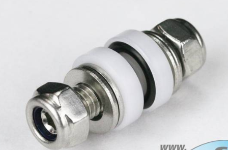

Existed, running larger wires for a single pump (that kept f**king melting) was an issue. You could run the wires, but sealing the lid was another story.
The rear seats of my car were off limits for most people due to the fumes. But it beat breaking down/lines melting/catching on fire. Just remember, no smoking.
In efforts to make it seal I tried approximately every epoxy known to man to try and seal around the wires running through the lid. All failed, some better than others. Some were good vs Petrol, but died when I put Ethanol in. Some were good against Ethanol, but died under Petrol. It was really quite crazy.
Once I used superglue, and glued my fingers together on one hand, like a claw. I did not own Acetone, so I drove 45 minutes across town to where my gf's lovely bestie had acetone handy to un-glue my hand.
Unfortunately one of the things I used was superglue.
This isn't a 34, but you can see where this is leading, superglue in this area didn't quite stay where I had hoped, and I managed to get Superglue, a really, really strong, industrial grade super glue in the threads between the black locking cap and the fuel bulkhead. And quite a lot, too.
Eventually it was freed... at 3am.. on a Sunday/Monday morning, where yes of course I needed the car to get home. This music was actually playing on the radio at 3am on PBS.
At this point we were more than happy to embrace any spiritual deity of any nature for any kind of blessing at all, to seal the holy heatshrink.
