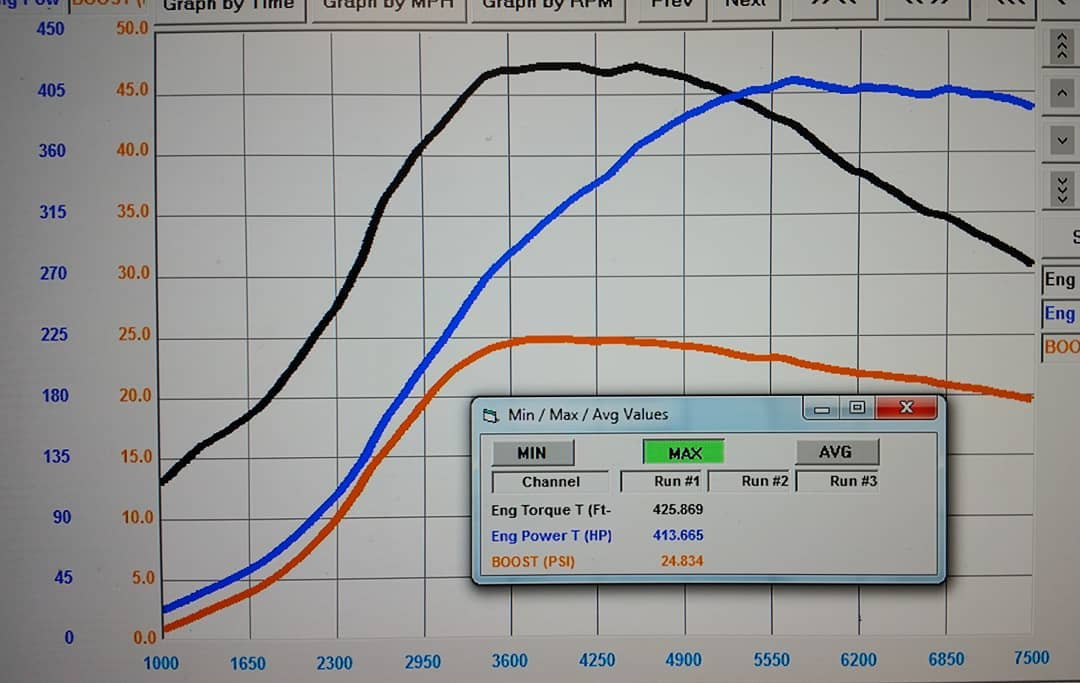

We'll have to see, worst case I replace the turbos when they blow up or when the engine gets pulled again. The US tuners with dyno sheets on the GT3-SS don't have a financial interest in selling an HKS turbo over a Garrett turbo, even if they play games with correction factors and inflate numbers I'm looking for relative comparisons. The data I've seen so far suggests that worst case, it's a minor improvement over -9s in the mid-range and isn't as capable for power. Best case I'll be able to get close to the "as advertised" torque curve here with VCAM step 1B, which would really be incredible: image.png.04da507c460455c8b5a93dacccb6e3be.png
I'm really not wedded to making a ton of power, at the end of the day this is a street-tailored car and power delivery is more important than what the number says.
