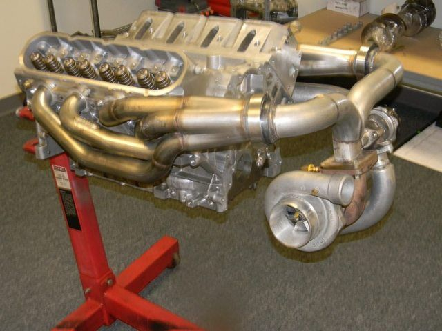

It's a practicality thing. With an I6 it's not that hard to have a single turbo, it actually reduces the amount of intake piping you have. With a V6 unless you want to do a hot V setup and completely re-engineer the engine + transmission a single turbo would have a ridiculous amount of exhaust piping to get to the turbine, like so:

Why is it then that some aftermarket turbo kits for the LS have the turbo only being feed by the one bank?
Yes, the good ones have the both banks merge, but I have seen some big Hp cars running only of 1 bank.

You sure about that? typically only one new manifold is required and the standard driver side manifold is reused. So when looking at a kit you may be misled thi king only one bank feeds it, but that would suck balls and I have never seen an ls kit like that.
the cross over pipe typically runs ender engine between belhousing and block then up to join passenger side bank.

36 minutes ago, GTSBoy said:
Running a V engine with only 1 bank powering the turbine would be daft. Massively different tunes required for each bank, to account for the massive backpressure on the one with turbine.

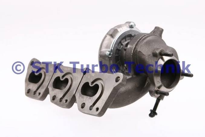

Did more googling
The Saab 9-5 3.0t did
It made about 200hp with 3.5 lb.
Even die hard Saab fanboys hated the engine
Sounds like a SR20 designed by NASA
So there you go, you can, and they did, but they shouldn't have, because it is shit.
