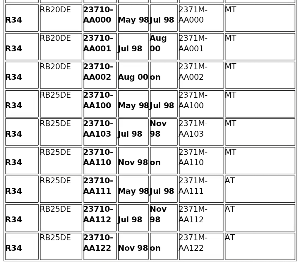

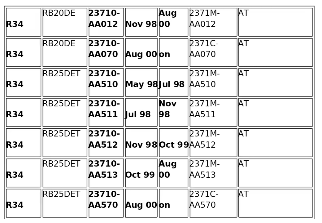

8 hours ago, Dose Pipe Sutututu said:
Have a look at the part number, I have a feeling that erratic idling is because of an A/T ECU.
I've attached P/N I've found off the net, not 100% sure if they're accurate but worth a try.
Massive thanks for this - there is a difference in the second last digit between DET MT and AT variants. I will use this for reference and try to locate it on my ECU.
Following your initial response I did a brief bit of research on the swap process and came back with information saying an ECU swap was not necessary, just that certain AT-specific ports became redundant afterwards. It is something I will need to look into further for sure. My initial thoughts upon purchase were that the swap has been done, so I can forget about it - rookie.

@  Dose Pipe Sutututu, the ECU is an AT one, part number: 23710-AA513. Before i try swapping this out, is it possible the neutral switch or any of the NDS readings below could be causing this?
