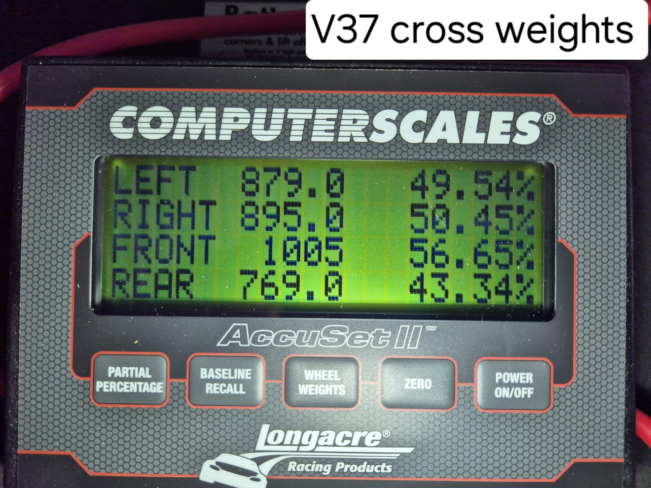

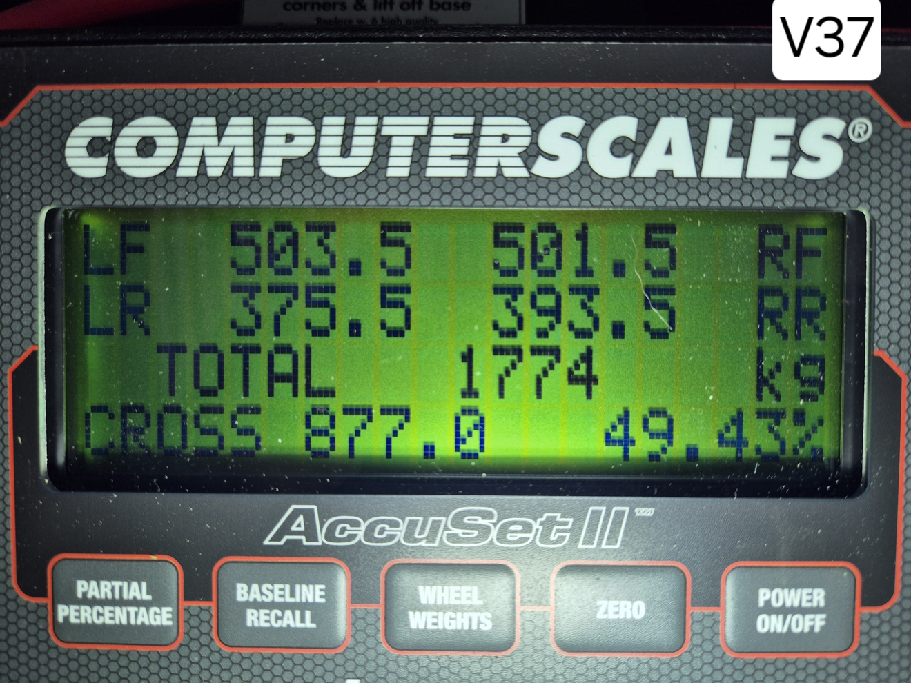

Having done all those calcs.....Infiniti specs lists V37 Red as weighing 1784, and my rego papers say it is 1680.
Seemed like a very reasonable excuse to buy some corner weight scales and check.
It came in at 1774kg with no driver, about 2/3 tank of fuel and all daily driver stuff on board including space saver spare (more to come on that). Unfortunately it is 57/43 front to rear which is not great and will be hard to improve, so those poor front tyres will be working hard.
Corners:
Cross Weights:
