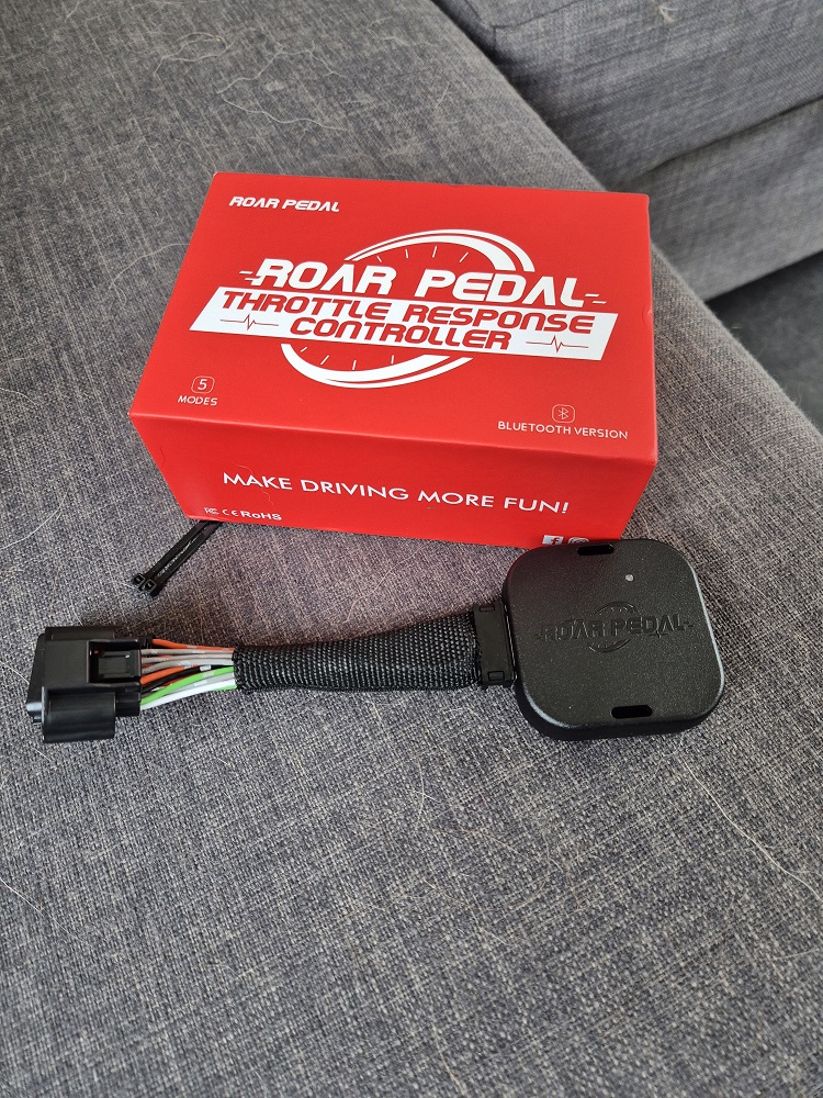

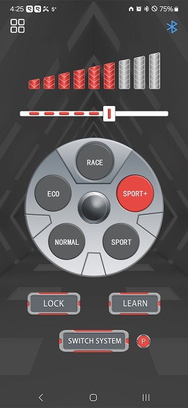

In the meantime, proving I have the same sickness as Mark (modifyitis) but a much less severe case, I've sourced a pedal controller for the car, it was about $250 landed with quick shipping
https://roarpedal.com/products/roar-pedal-controller?variant=43907318448371
Obviously the red sport has eco, normal, sport, sport+ modes and the main difference is the throttle curve. Even so it was clearly early days of calibrating such things and even in the higher modes (which you need to set each time you start the car) it still has a dead spot off idle that really annoys me. Plus the factory sport/sport+ have the the rev hang and fake engine noises that are pretty annoying for road use (would be fine for racing)
The throttle controller is a simple pass through with 2 plugs, 2 minute install then bluetooth configuration from an app.
Unlike the factory stuff the setting is retained across drives. It basically has a bazillion options (2 types, 5 modes and 9 settings per mode so about 100 settings), I'm currently using p mode, sport+, level 6 which is nice and responsive but doesn't spin the wheels on dirt every time you touch the pedal.
Obviously this car is getting a full tune one day which will include proper throttle mapping, but in the meantime this has transformed how the car feels driving around.....
I always thought those throttle controller kits were essentially snake oil. Good to see that it can actually make a difference!
It really bugs me how modern cars tend to revert all the settings for each startup. At least Honda got it somewhat right with the Type R where the default is sport mode. And have to switch to go to comfort...
  • Author
Yeah the difference is massive, but I'm sure it varies per base car and what you want as a driver.
The Fuga (2014) and Titan (2015) also had horrible factory throttle mapping but in both cases I had done an uprev tune which fixed the response without needing a throttle controller.  Whoever was in charge of Nissan e-throttle mapping in that period has a lot to answer for :mad:
Those controllers don't do anything, except change how the signal appears to the controller.
So for example, to make it more sporty, where you first put a little bit of throttle in, it instead will send a higher impulse, and then taper it down towards the target.
In theory, you can learn to do what the throttle controller does, but it feels unnatural, for example a normal take off at 15% throttle input in sport mode on Duncans setup, might actually tell the ECU, give it 75% throttle for 0.5 seconds, and then drop to 25% for a second then tailor it back to 20% throttle and maintain that. Compared with the normal throttle might have gone "I'll give you 50% of what you asked for, then half a second later I'll give you 50% more of what you're asking compared to what you have, and then in the end I might let you have 13% in total.
At the same time, engine setups like when cruising on the highway, while on light throttle may have the actual throttle 70% open, and playing massively with variable valve timing. A small change in your throttle request will see the motor just mildly tweaking torque request by adjust cams every so slightly, but give it a sudden gut full quickly, it'll bring the cams back into a performance mode ready to go, and then the throttle to follow the position of the pedal, which gives a lot more response. Hence the controller giving a much bigger input to the ECU then back it off, makes the throttle overall feel more responsive.
Peak power etc overall though is unchanged.
And as Duncan has said, this is why they have to make a different controller mapping typically per make/model as they are all doing different things etc.

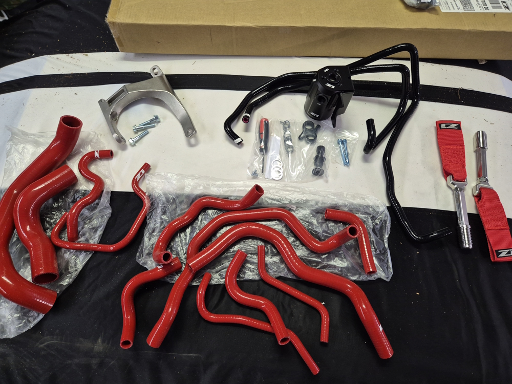

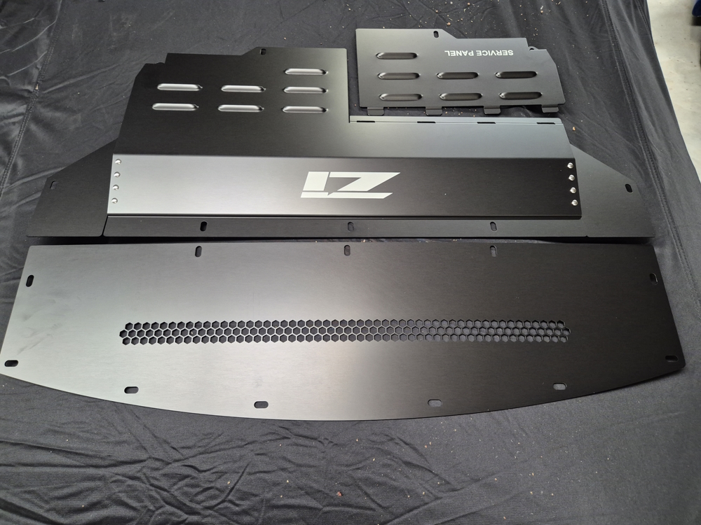

So, with the USD on the way down with Donald's pending election, I went on a bit of a buying spree at Z1, there is a fair bit of aftermarket stuff for the v37 platform and it looks reasonably well engineered and made.
First, a weight adding change - new undertray for the front, but usefully it comes with a port to get at the drain plug and oil filter without having to remove the whole damn thing like the dumb factory setup.
Also....
2 reg compliant tow straps
Red radiator hoses (preformed silicone)
Red vacuum hoses
Catch can kit (might need some massaging to fit RHD)
Diff brace to add more that one mount point to the rear
I'm not planning to put the silicone lines on right now, but they should help with quicker work on the car instead of just being a mass of black stuff under the bonnet

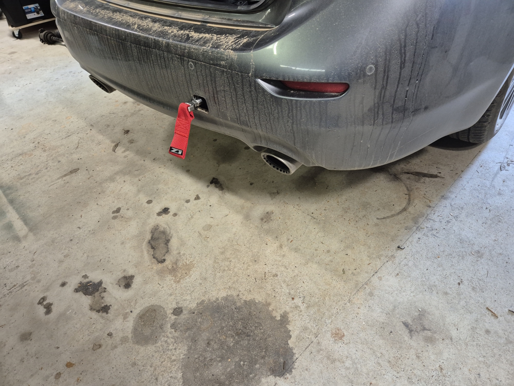

  • Author

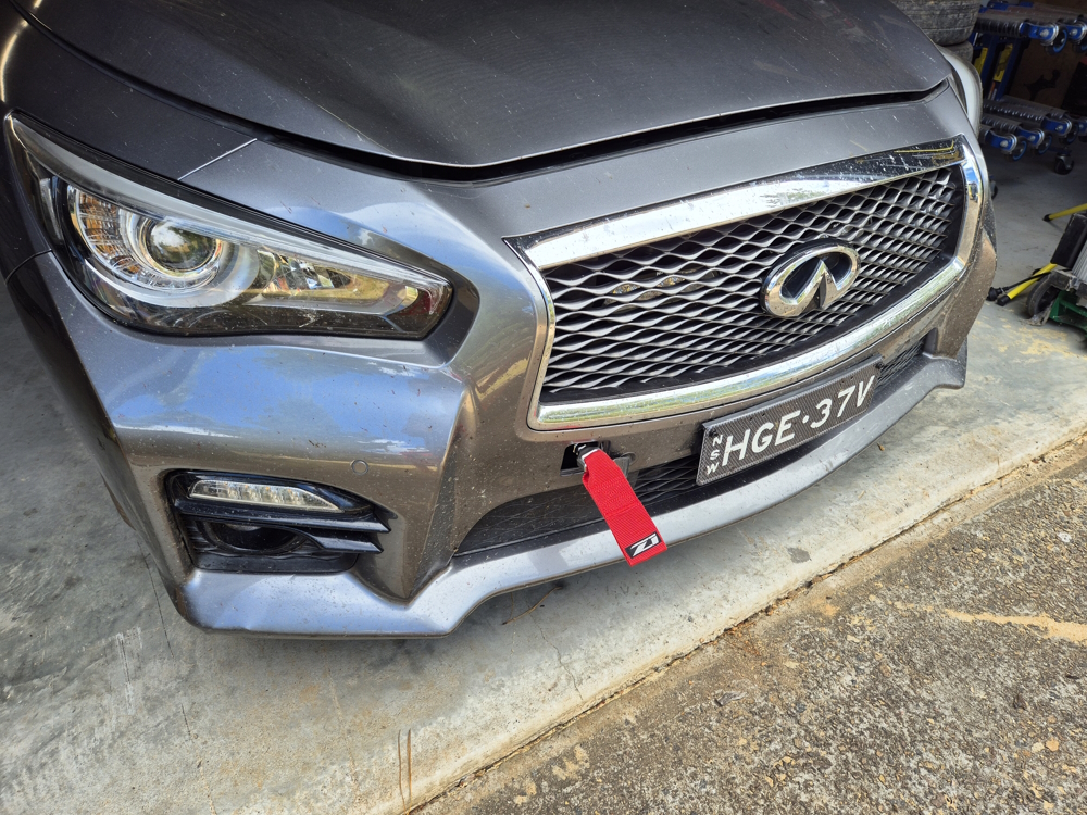

Tow hooks fit neatly in the factory holders front and rear, easier than bodging something up myself.
Hopefully I'll never have to test if they can hold the whole car's weight like Mark did on his 32 back in the day...

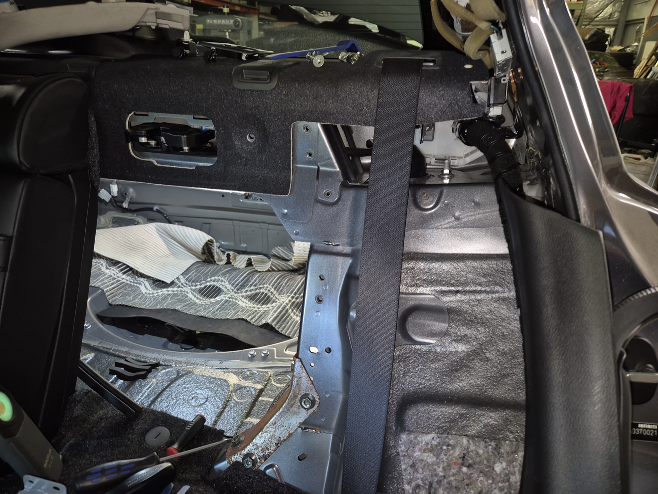

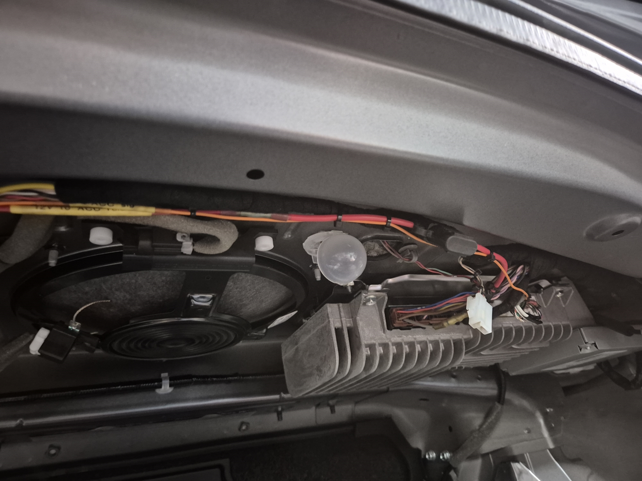

So, to run the 4g aerials to the booster, I had to get access to the rear bulkhead....bit of a mission.
Hot tip, don't offer to help change the rear shocks for a mate with a v37....
Remove seat base, 2 clips that slide forward to release it the it lifts straight out
Fold down rear seat (pull in from boot)
The side bolster of the rear seat is not connected to the middle parts that fold. To remove unbolt at the bottom bolt then push it up off the top hook
Then there is a plastic surround behind the seat back, 2 pop out clips, 2 bastard clips, some swearing at it is out
Pop the rear seat latch surround off
Remove door surround lower trim then side trim
Remove c pillar trim - 4 clips, pull inwards not forwards
Remove metal brace - 5 bolts 1 nut
Then you have got to the rear strut top...what a pain!

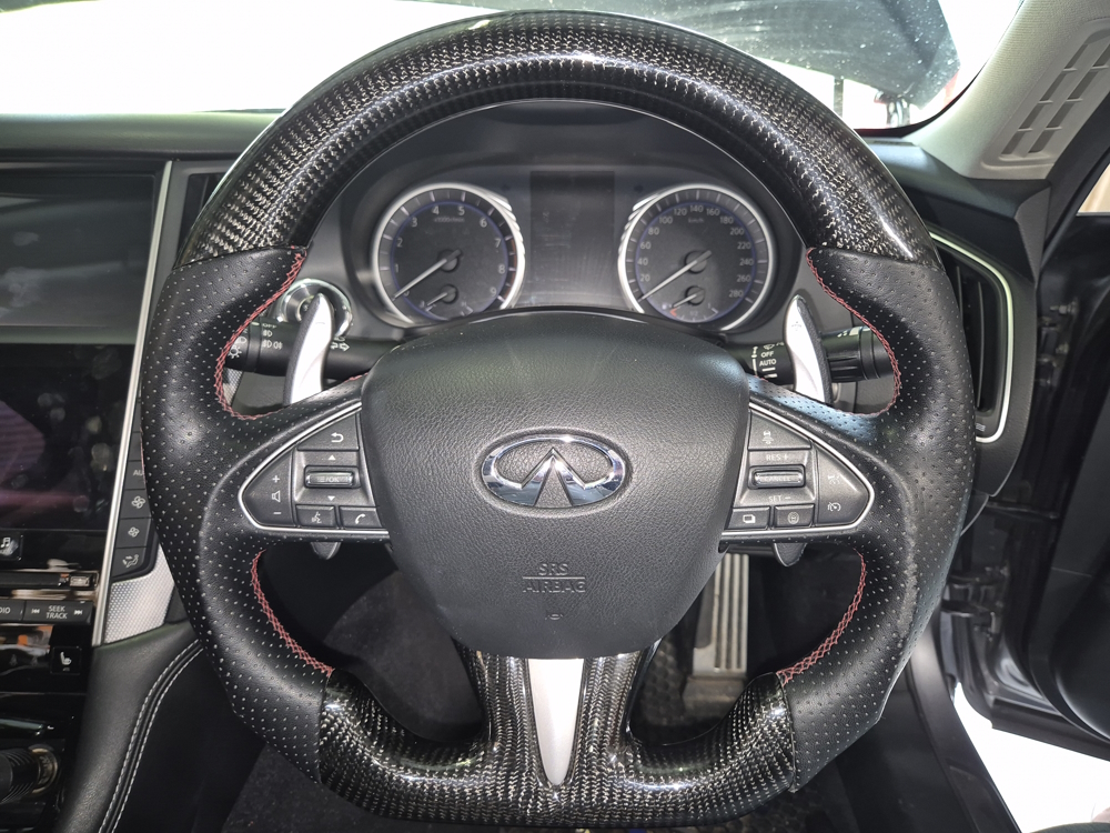

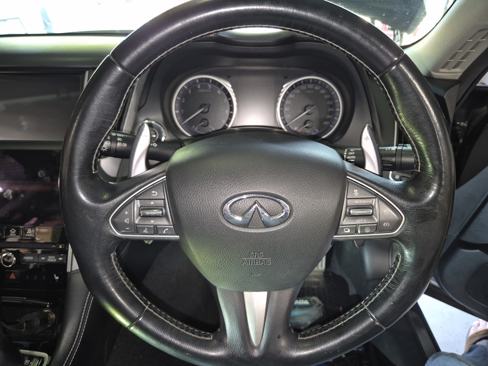

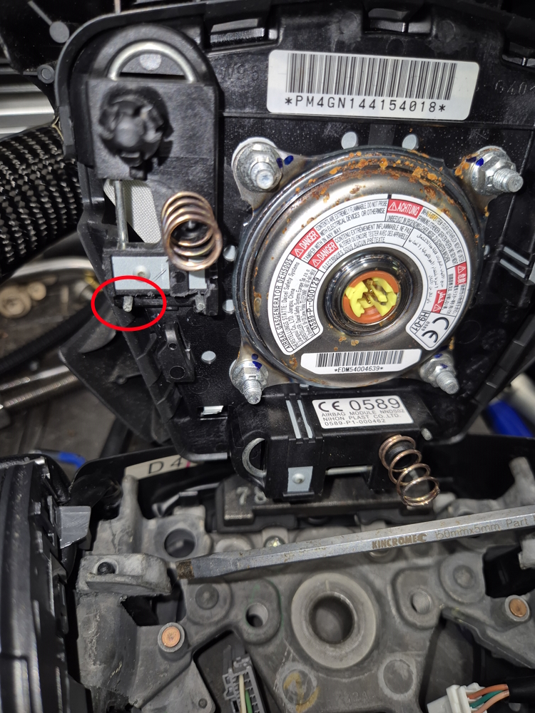

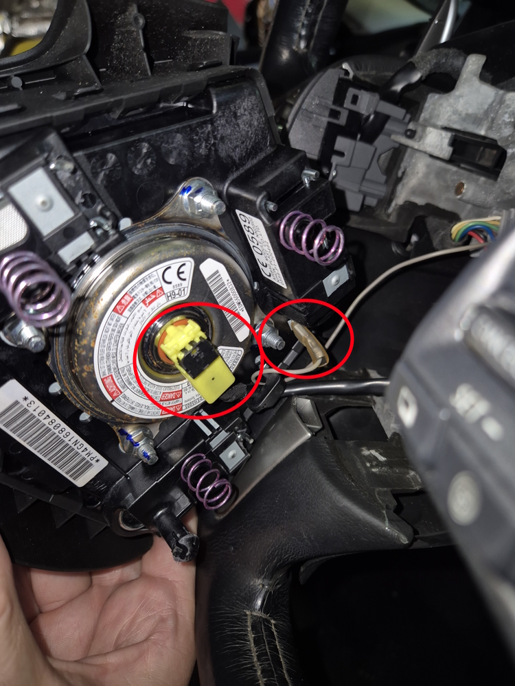

So, to next task....the carbon fibre steering wheel was either an expensive factory option or a chinesium special. Either way, I don't like either the flat bottom or thick ring style, so it had to go
So...to remove the steering wheel....
First, disconnect battery negative and stomp on the brake pedal for a few seconds.
Then, remove the small circular covers on each side of the wheel's rear surround to uncover the airbag clips.
You need to push something like a flat bladed screw driver through, to push the steel clip inwards and pull the side of the airbag forward. Once you've done the easy side, same on the centre console side. You can see the tab you are shooting for circled in red
Then, disconnect the horn spade connector and for the yellow airbag plug you need to get something small under the black locking tab to pop it out, then the connector releases......airbag is off

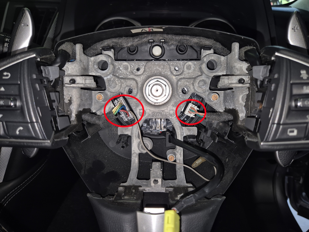

  • Author
Once the airbag is off, to remove the steering wheel....
Undo the 2 plugs into the clock spring, and the horn connector from it's clip.
Hit the 19mm nut with a rattle gun (preferably) or if you don't' have one, you probably want an assistant to hold the wheel in place while you use a breaker bar to undo the nut
Then, screw the nut back on 3 turns, and pull the wheel sharply towards you. If that doesn't work hit it medium force with a rubber mallet on either side, or possible behind if you can get there. If that all fails (it shouldn't!) you might need a steering wheel puller
  • Author

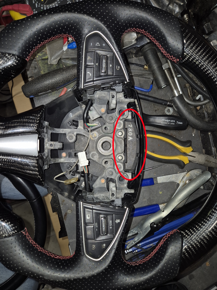

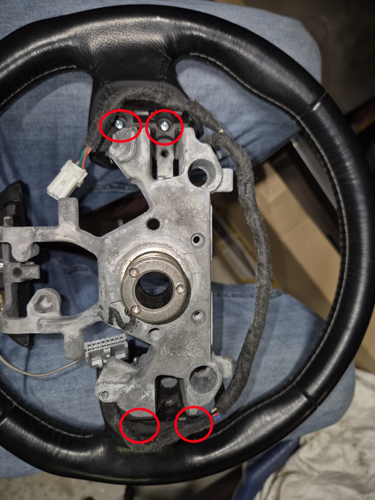

In my case, the standard wheel I had was in good condition but the buttons had more wear, so I swapped them across from the original wheel from the car.
The plastic rear cover is held on by 4 tabs, and once the wiring is removed you can get access to 2 screws on each side the hold the buttons in
From there I just swapped the wiring over.
What was interesting is the standard style wheel is 2.0kg but the carbon fibre one is 50% heavier at 2.9kg. It even has a weight inside the wheel at the top to make up for some sort of imbalance in the design. weird
  • Author
From there, as the manual says....assembly is the reverse of disassembly, no tricks worth mentioning
Much better (for me)

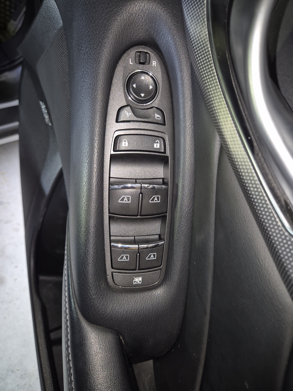

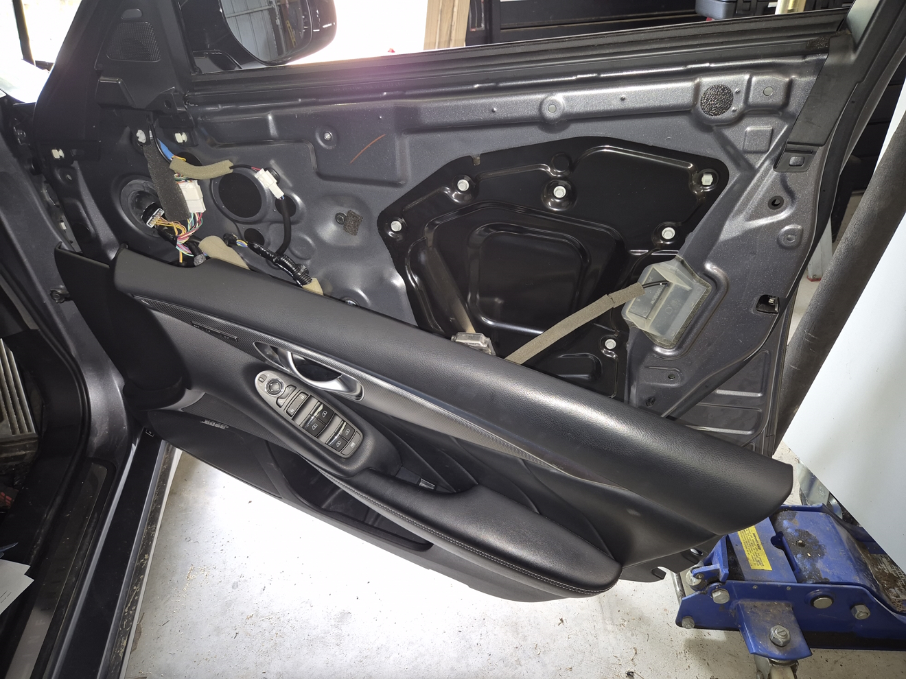

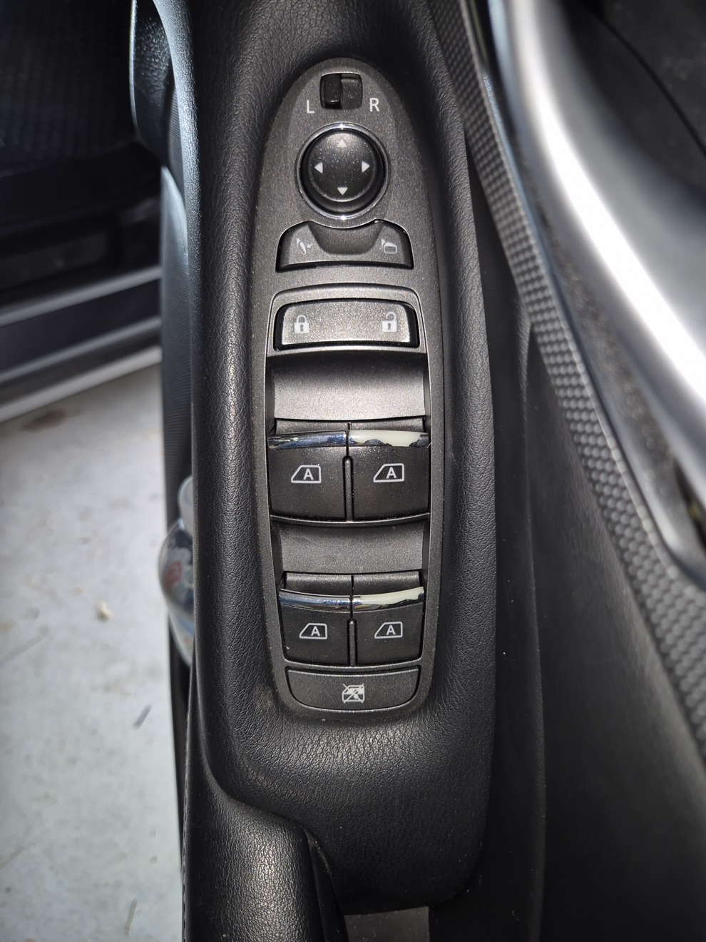

Last of the maintenance items for now....not sure why but the drivers side window switch had heaps of wear on the right front and right rear switches
Unfortunately, unlike earlier Skylines the controls are bolted to the door trim from the inside. So....off the with door trim. There are bolts or screws:
Behind the door handle cover, pop it off from the handle side
Under the rubber trim at the bottom of the door pull (also just pops up)
Behind the courtesy light at the bottom.
Other than that, just window down then pop off the usual selection of push in clips around the perimeter and the trim lifts up
Interesting that they have a bolt on cover instead of the old school plastic held on by goop....I guess they prioritised sound levels over price
Then, 2 screws and 2 plugs to replace the switch (looks identical to the Fuga/Q70 one incidentally) and put it all back together.
Also much better

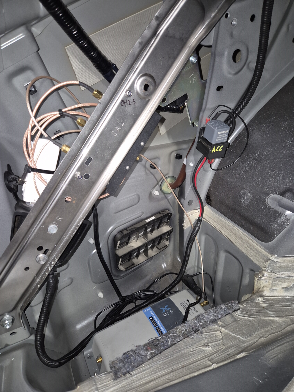

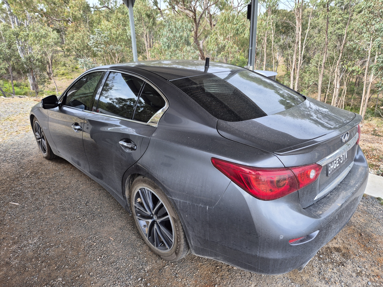

Catching up on a post, I've replaced the external shark fin with a small 4g antenna (no further drilling, just a 1mm embiggening of the existing hole, and run that to where the dual battery models have the battery in the left rear guard.  No idea what the factory antenna did, but removing it had no impact on anything I use, according to the US manual the GPS antenna is in the dash and it still works fine
Also ended up stealing battery power from one of the amps and ACC power from a unit nearby to add an ACC relay to power it.
The mounted the booster, wifi, power socket and antenna splitter in the rear left guard out of the way, all out of site with the boot trims in
