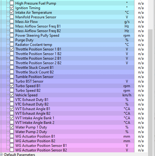

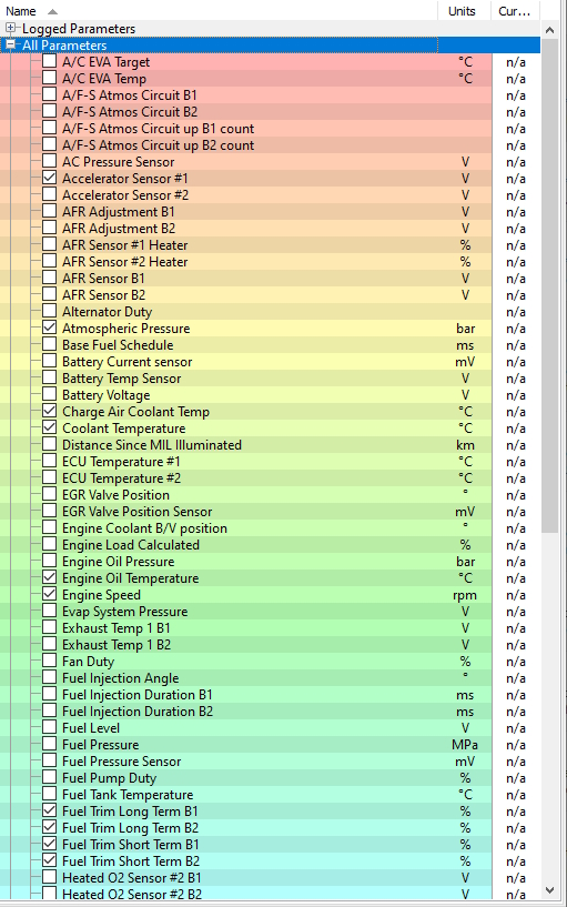

So next thing was looking at data logging. Not straight forward because none of the motorsport displays have cracked the nissan/inifinti CAN and ECU based displays don't do g logging, lap timing, predictive laps etc.

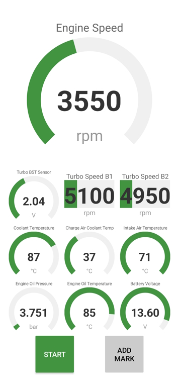

So, I bought an Ecutek dongle from Tunehouse (Oz distributor). Even without a tune onboard that allows display and logging of about 50 parameters via Android (and presumably iOS) app. Approx 600 for the bluetooth + Usb version
That gives me (pretty ugly but) functional dash display on Android
And logging of these parameters
I'll play around a bit over the break, but at least now I can make sure I have oil pressure when I get to some track testing.

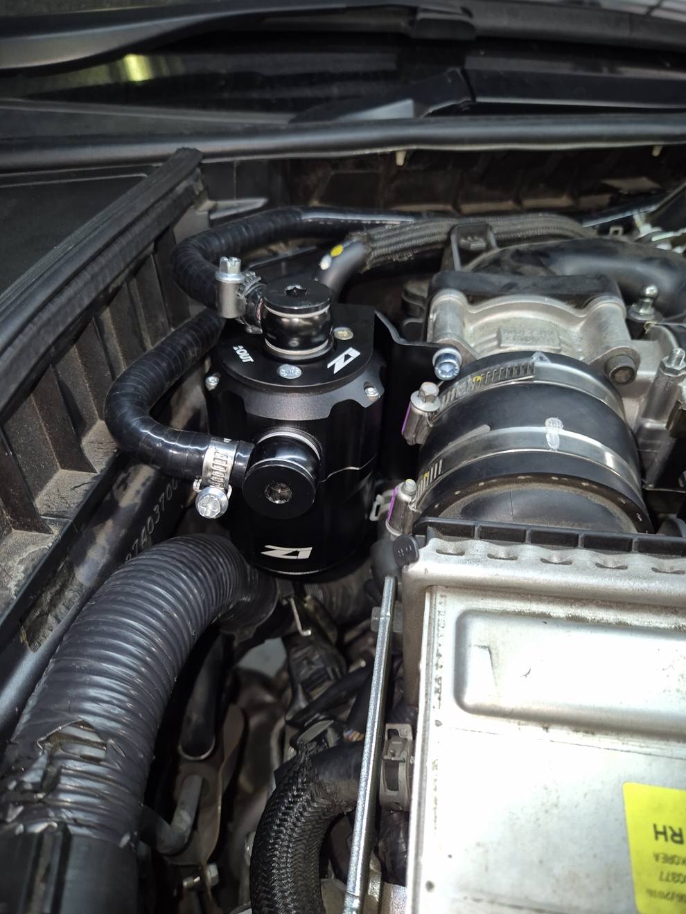

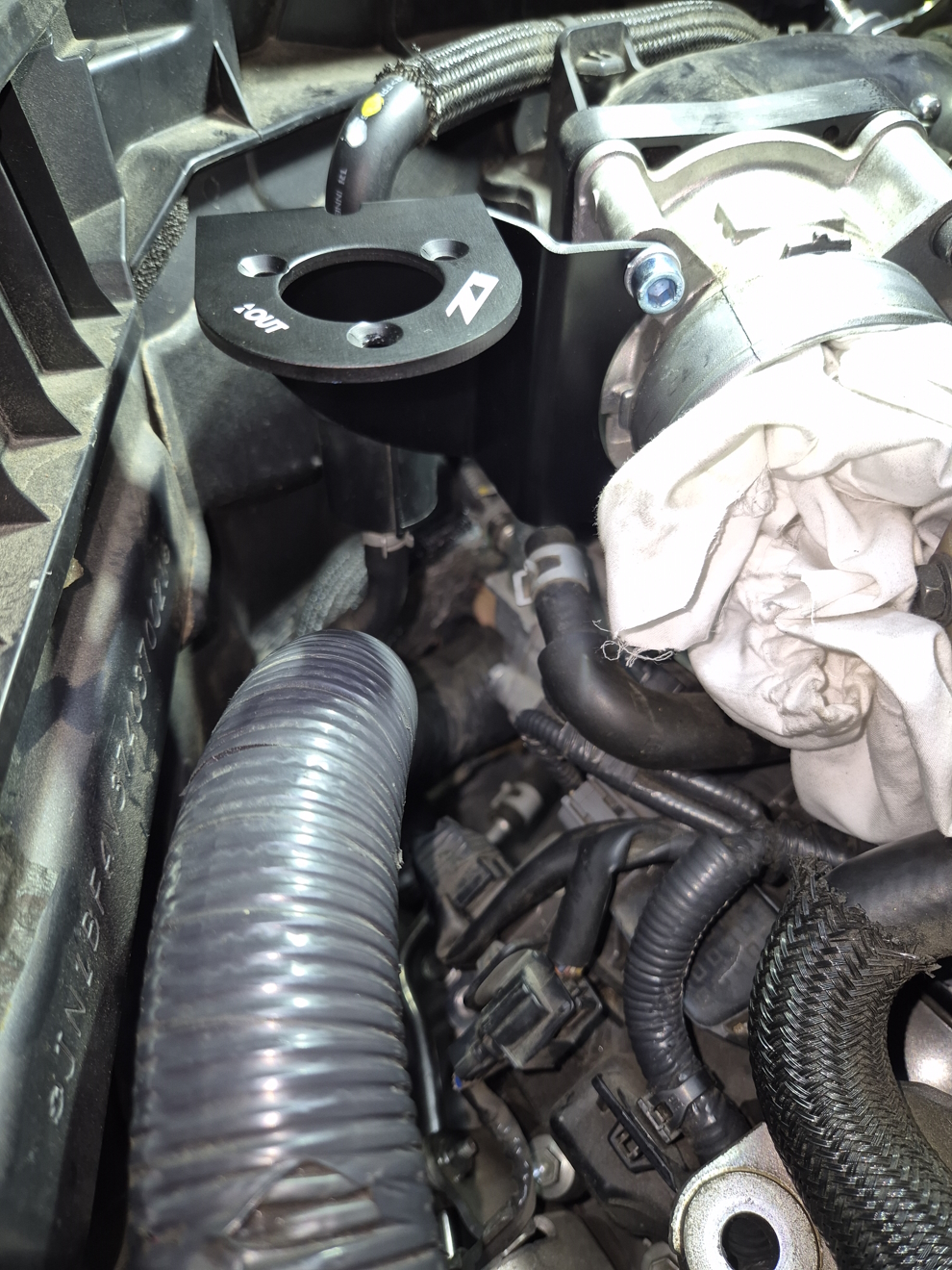

So the other thing I got sorted over the weekend was Z1 oil catch can install.
https://www.z1motorsports.com/z1-products/z1-motorsports/z1-q50-q60-30t-baffled-oil-catch-can-kit-p-23546.html
It was a good kit, most importantly it came with preformed silicone hoses in the right shapes rather than trying to bend/join regular straight rubber hose. It did come with crappy spring clamps not proper hose clamps so I ditched them
1200x900_Z1_Q50_Q60_Oil_Catch_Can_Kit.we

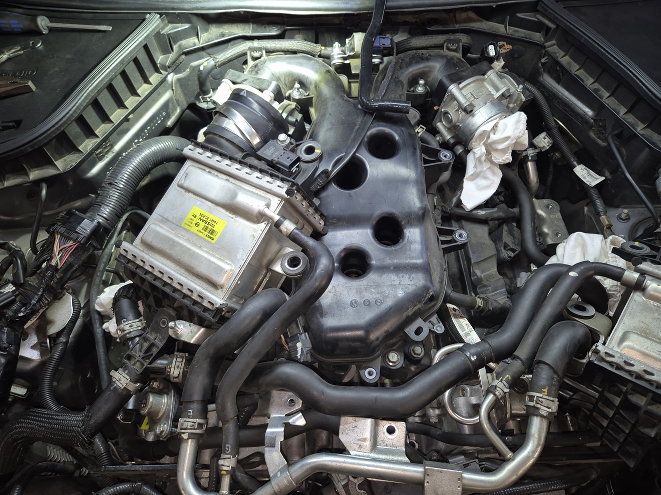

On the down side, it is made for LHD cars and RHD cars have the main ECU harness running straight through that location, I ended up bending 2 mounting brackets so the loom is up against the brake master cylinder compartment wall to make room for it....otherwise everything fit without modification
Intercoolers off on both sides, but there was enough room to get everything done without disconnecting (and therefore having to re-bleed) the coolant lines.
Each is mounted with 4x 12mm headed bolts, plus in and out side hose clamps (7mm headed, nice) and 3 electrical connectors on the navigator's side which were a real pain to undo (probably for the first time in 13 years).
Also one of the mounting bolts on the driver's side was cross threaded, thanks Infiniti/Nissan workshop mechanics.

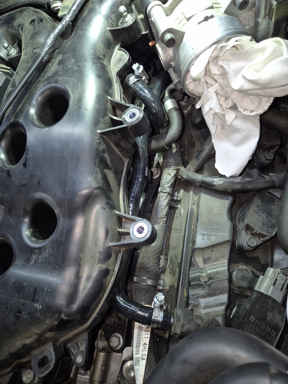

On the navigator's side, the catch can plumbs into the factory hose that goes from the cam cover PCV back to the intake.  This is the 2 new hoses in place. All simples and direct fit
On driver's side, there is a bracket provided that mounts to the throttle body, they even provide slightly longer bolts to allow for the bracket thickness which is nice (although, they don't have captive washers like the factory bolts of course)
In that pic the main loom brackets are not in place, once I had "adjusted" them across it now sits up against the panel and just clears the OCC
The remaining problem with this is emptying it; currently you have to remove the 3x m4 bolts that hold it to the bracket and both banjos to remove it (probably dropping the banjo washers at the same time) pull it apart to empty then replace. I do have some fittings coming for a remote drain from underneath that will also add a little capacity...it is very small and will need to be emptied every oil change to be sure.
