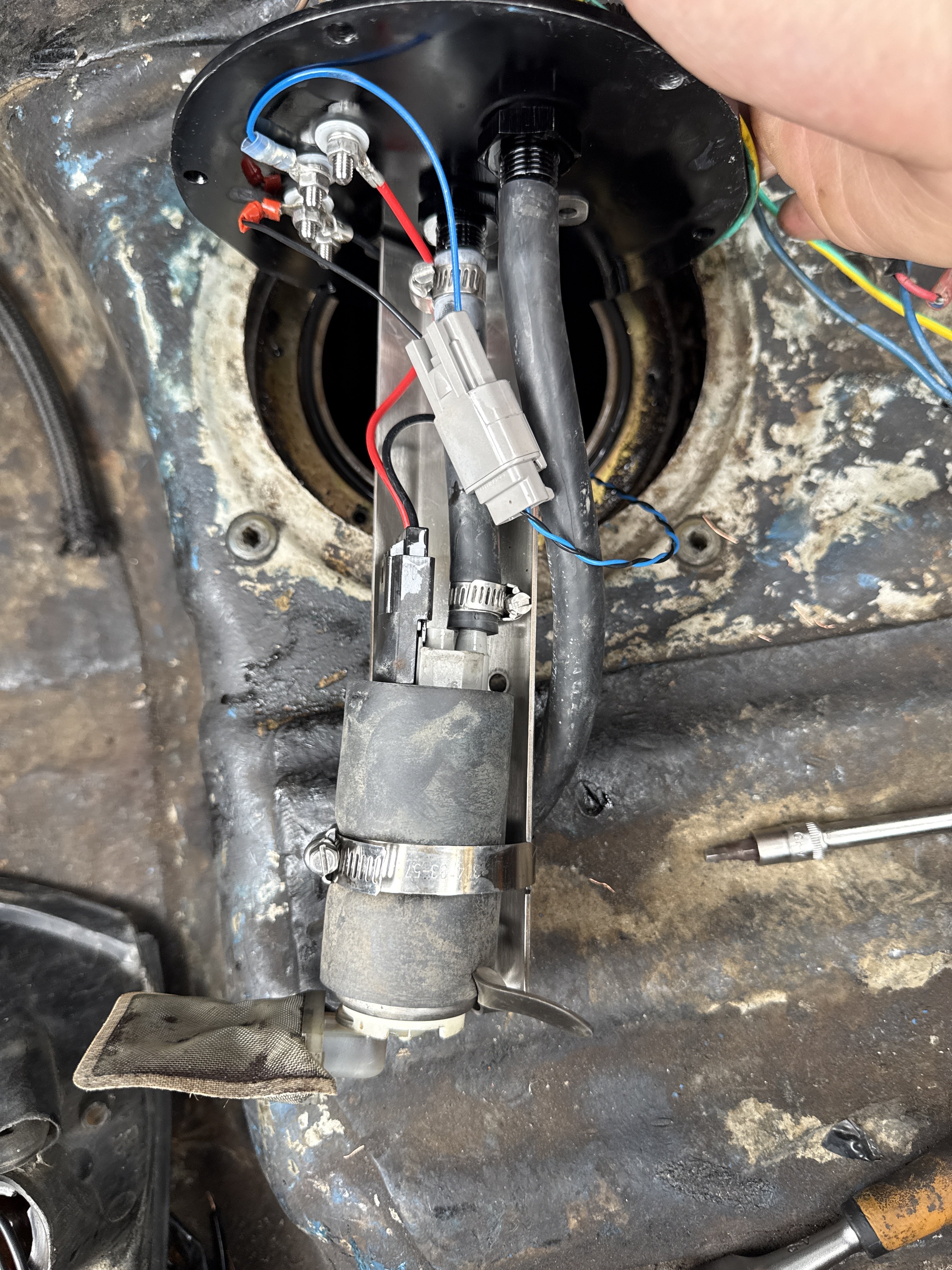

2nd issue, when replacing my fuel pump and fuel hanger I managed to break the factory fuel level sender leaving me with no fuel gauge, I’d like to buy the fpg fuel level sender for r32/s13 but the plug it comes with confuses me, I’ve got a detschwerks x1 fuel hanger which has light + pump - level + pump + and a ground, I’m no auto sparky but I’m wondering if I can cut the plug off the fuel level sender and wire the negative to the pump negative and wire the positive to the level positive to get a fuel gauge back ?🥴

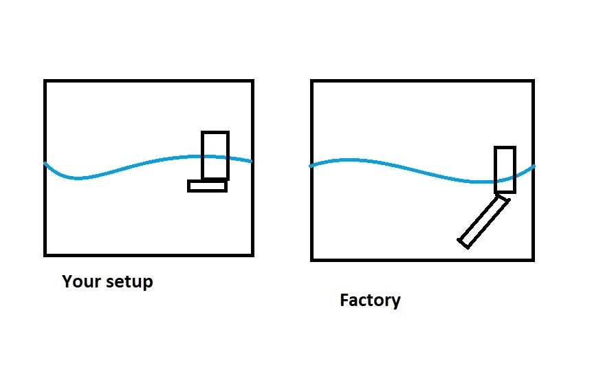

I drew you a picture to explain this one :)
The factory strainer is quite long, reaching down into the bottom of the tank. Safe bet your aftermarket fuel pump has a little baby sized strainer that probably doesn't even point down towards the bottom of the thank.
Solution, move the pump lower down in the tank, or fit a longer strainer, or do both. I did both, I've run my tank down to 5L remaining and the car still drove fine.

Also this may be a stupid question, but how would you recommend getting the strainer on a downwards angle ? as they tend to obviously clip to the bottom of the pump which usually sits level 🥴
As GTS mentioned, it takes a bit of faffing, some fiddling and a little modifying.
With the strainers, you can buy different styles. Some sit flat on the pump, some angle down.

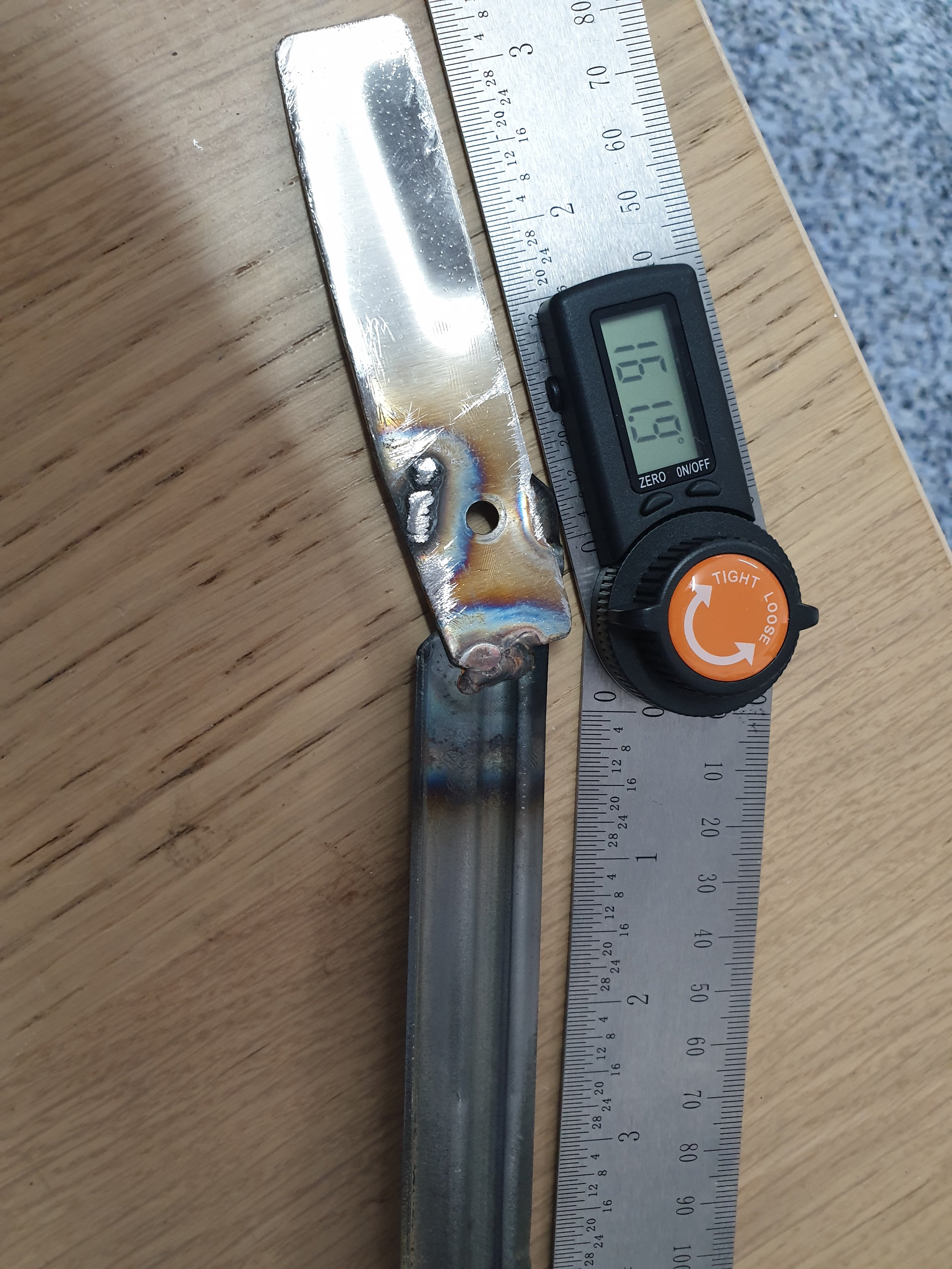

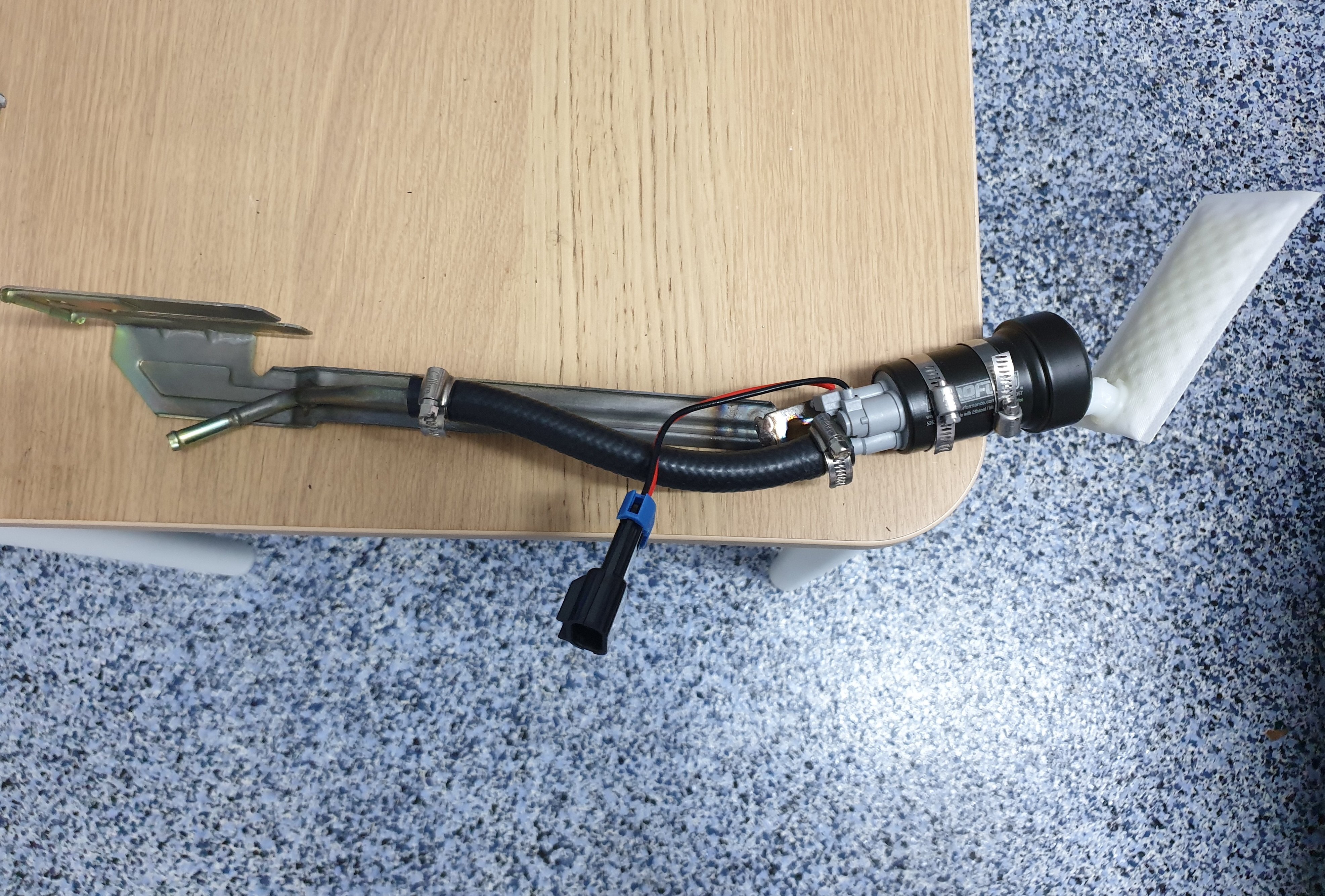

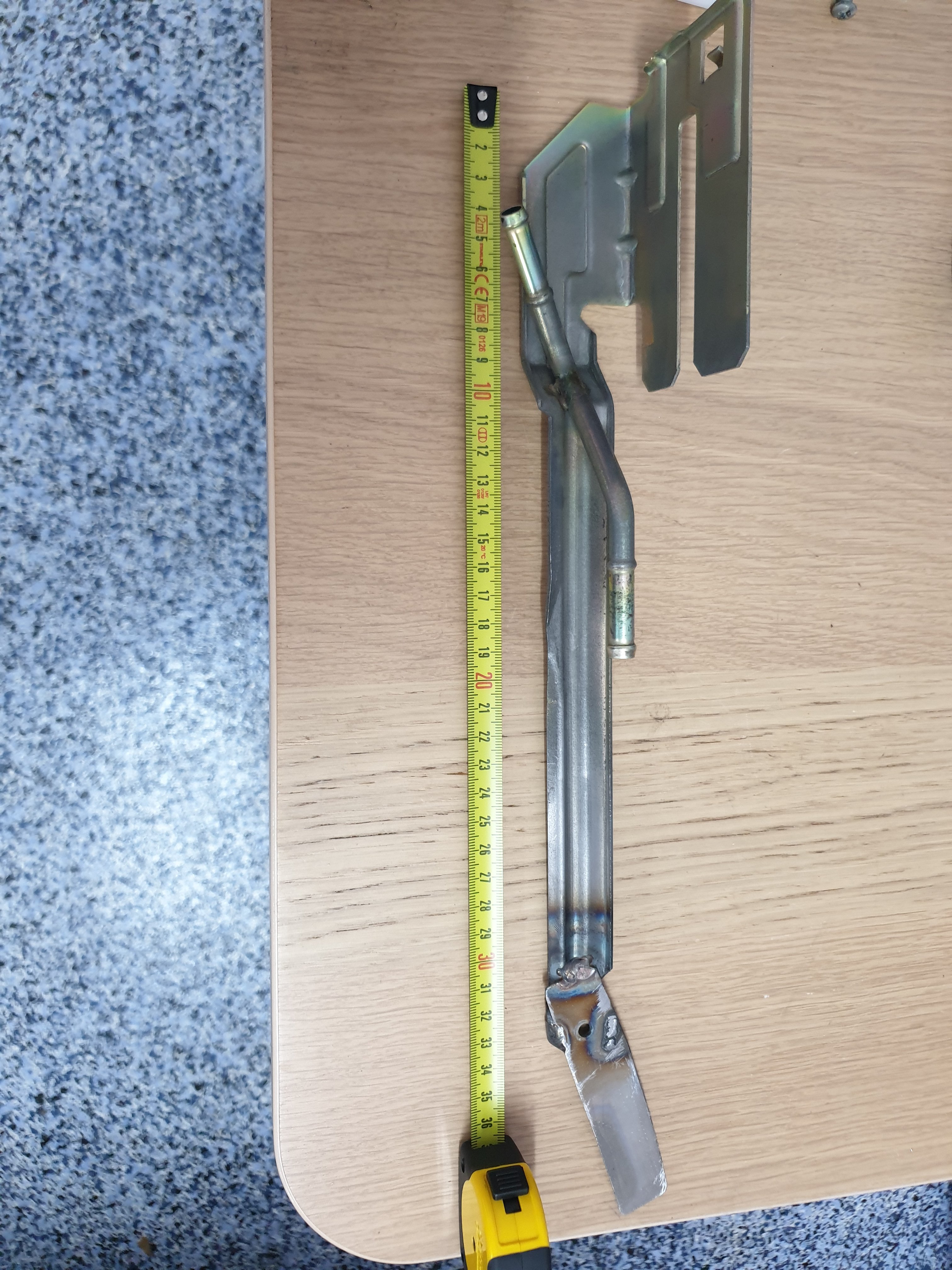

Here are some photos of mine, ignore the ugly welds lol.

I actually have an aftermarket hanger, the detschwerks x1 hanger, but my dw420 has never really sat in it correctly, good to know I can just modify it a bit to suit.
