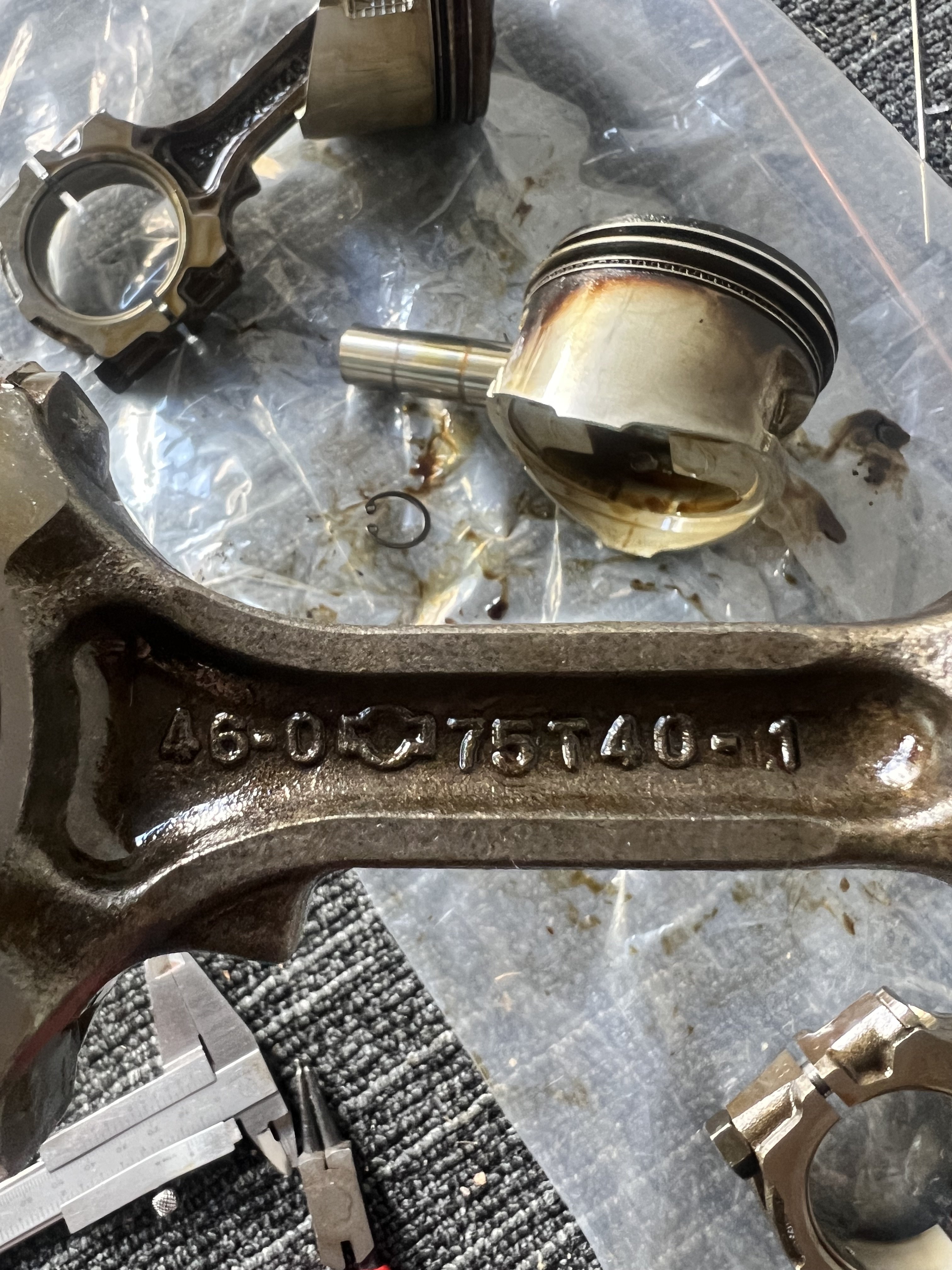

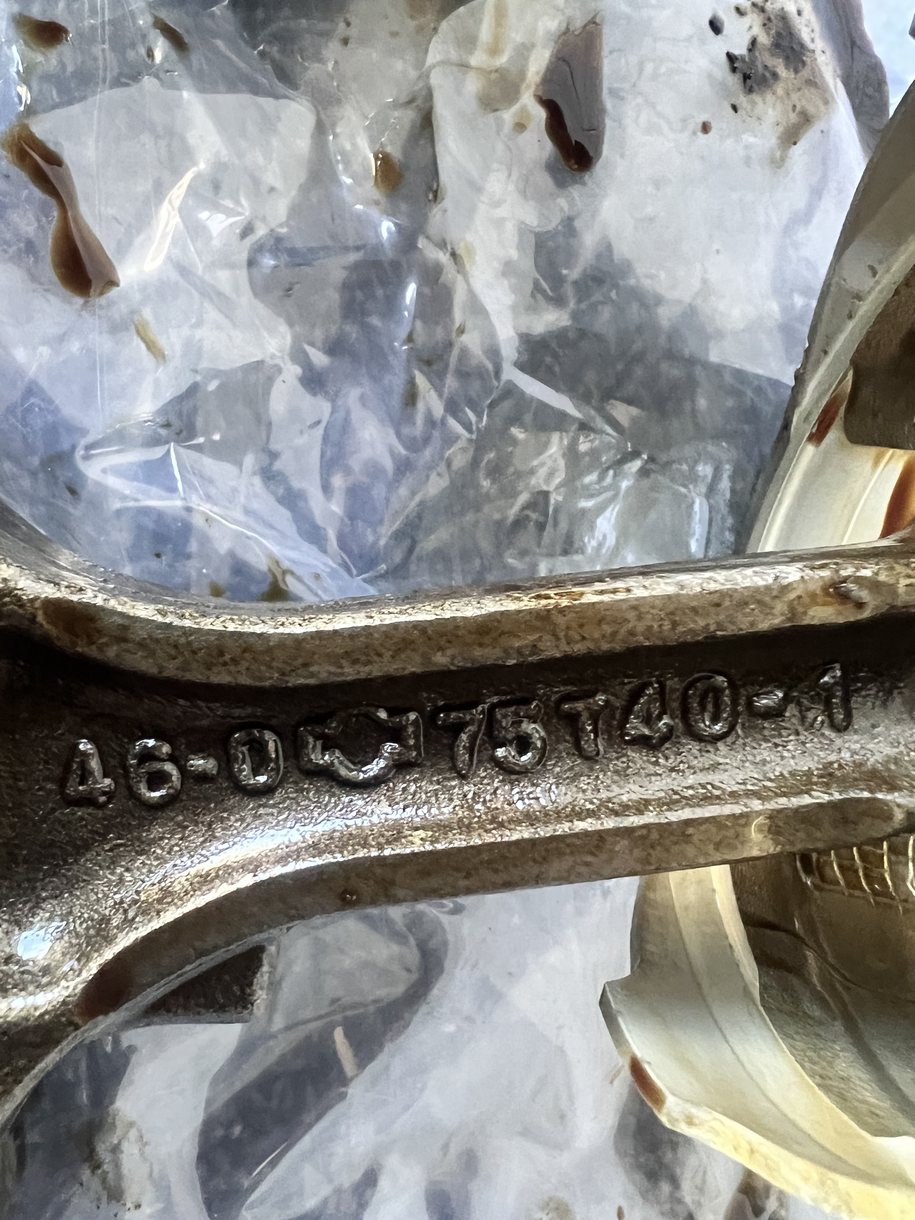

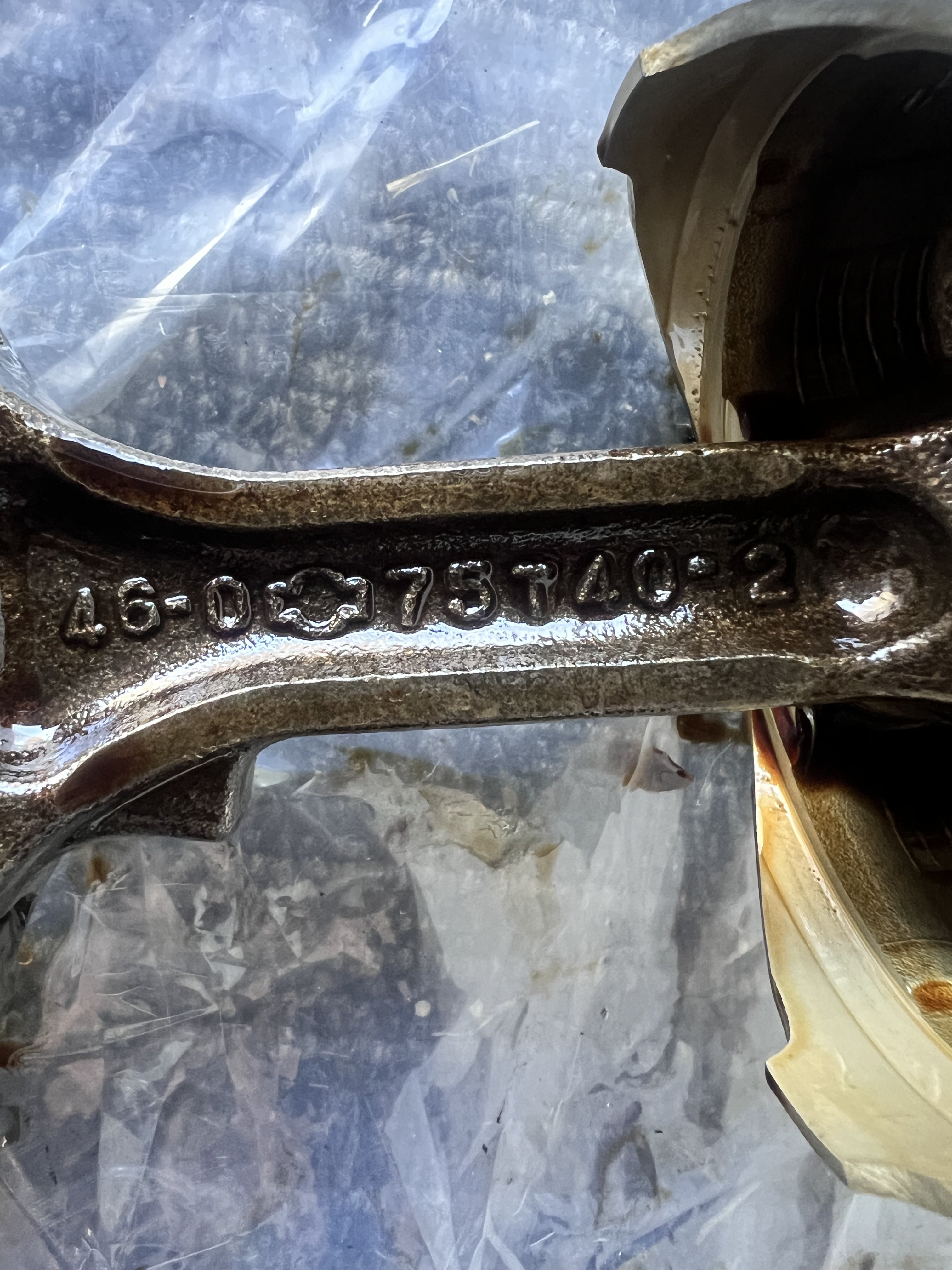

The only Neo rods that were any different to any other RB25 rods were the DET ones, and they were the same as RB26.
Here is a Neo DET rod. O5U part number visible.
20171202_135757_HDR.jpg.92cd94b31f69812d
Here is a post in a thread here on SAU with evidence from someone who has done this before. There are photos in the thread of normal RB25 rods.
