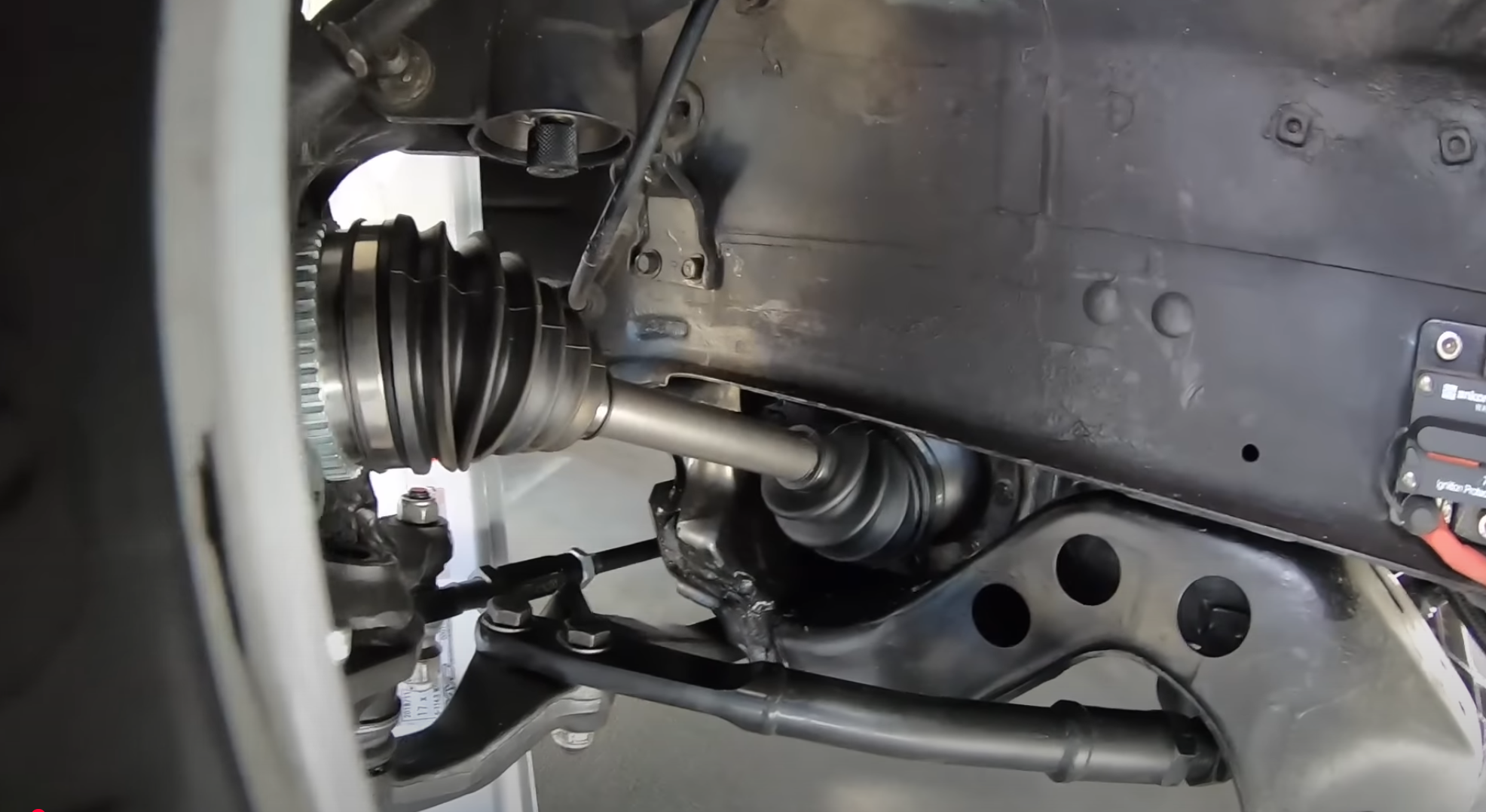

Is anyone running these axles?
R32, R33, R34 GTR front Axles. shafts itself rated 950hp. Suit all RB26 engines Croydon, Melbourne, Victoria

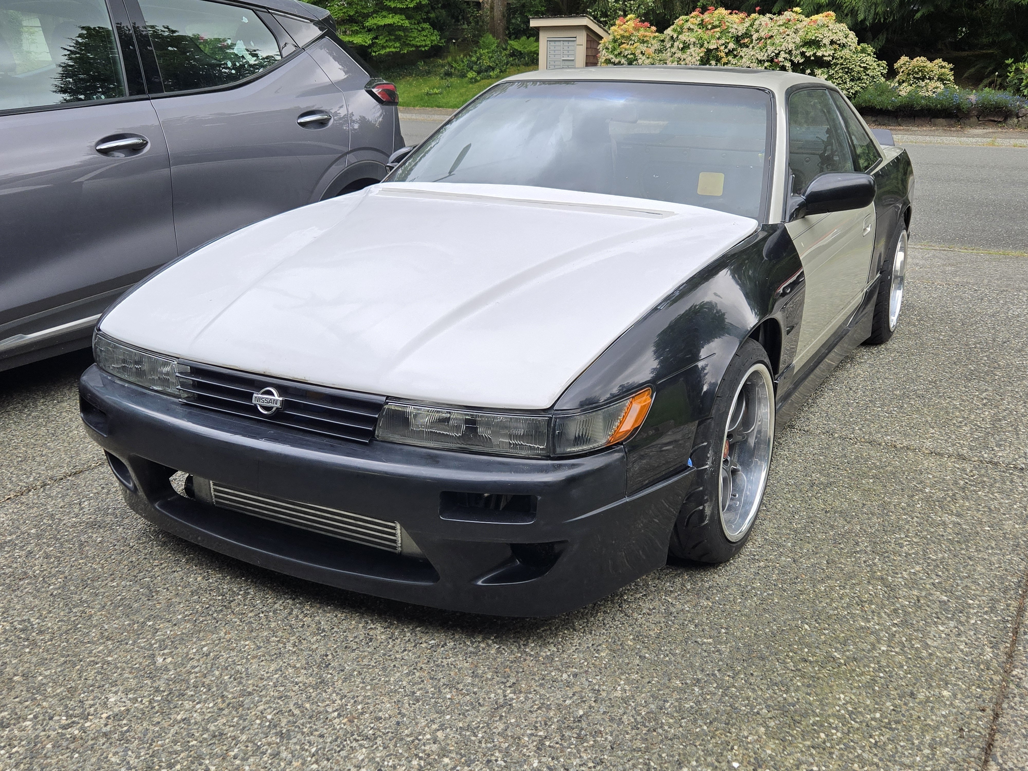

Would be nice to pay half the cost of Driveshaft Shop Axles. I'm building an AWD S13 Coupe that is very low ride height (high cv angle) compared to stock R32. Has an RB30 with appx 600whp.
Just looking for feedback.

I think that might be in the question. He is going very low, and I think the standard GTR ones are simple tripod joints (like the rear NA/S chassis ones), not proper CVs (like R chassis turbo/GTR ones). Proper CVs take the misalignment better than tripods.

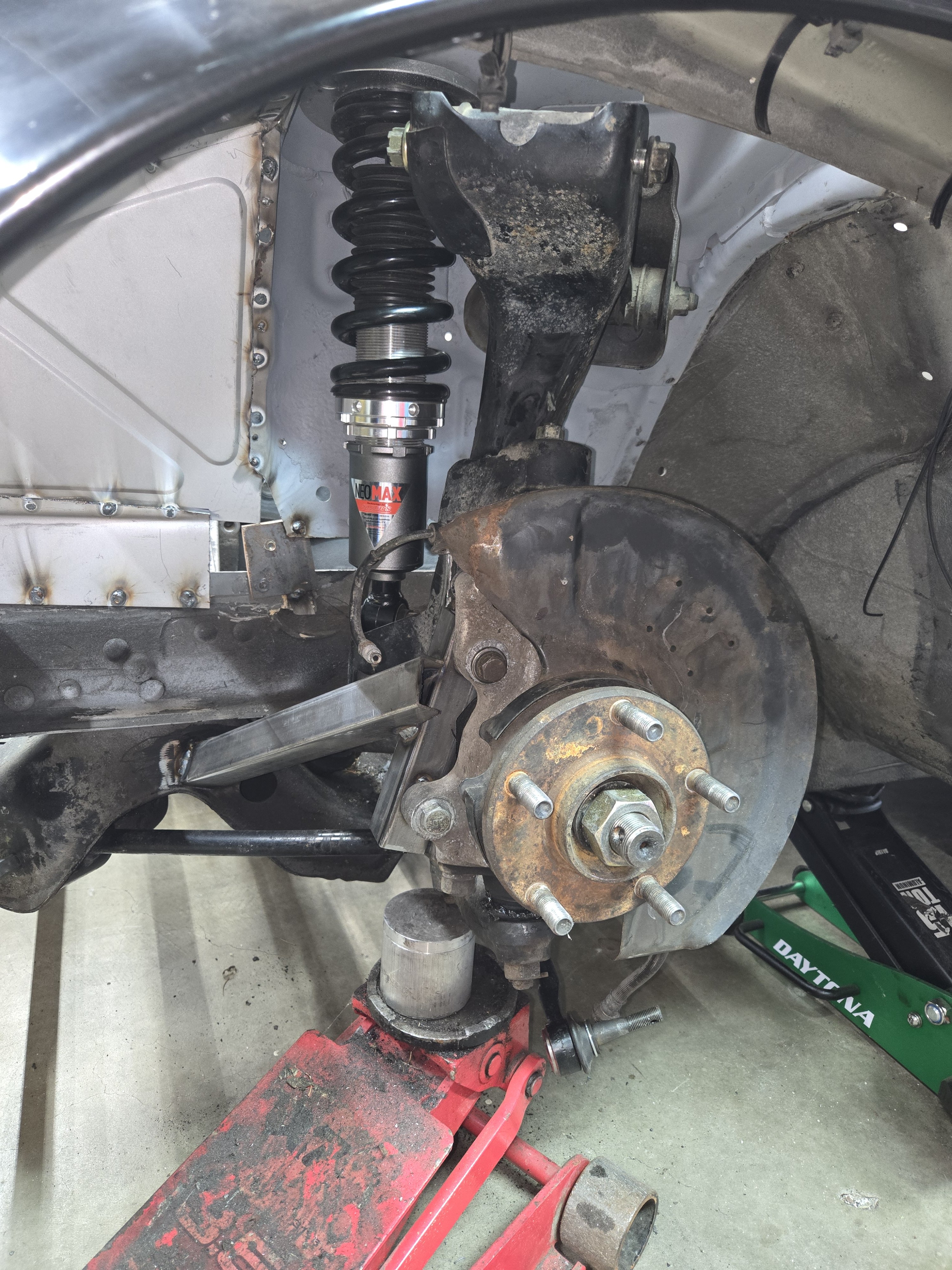

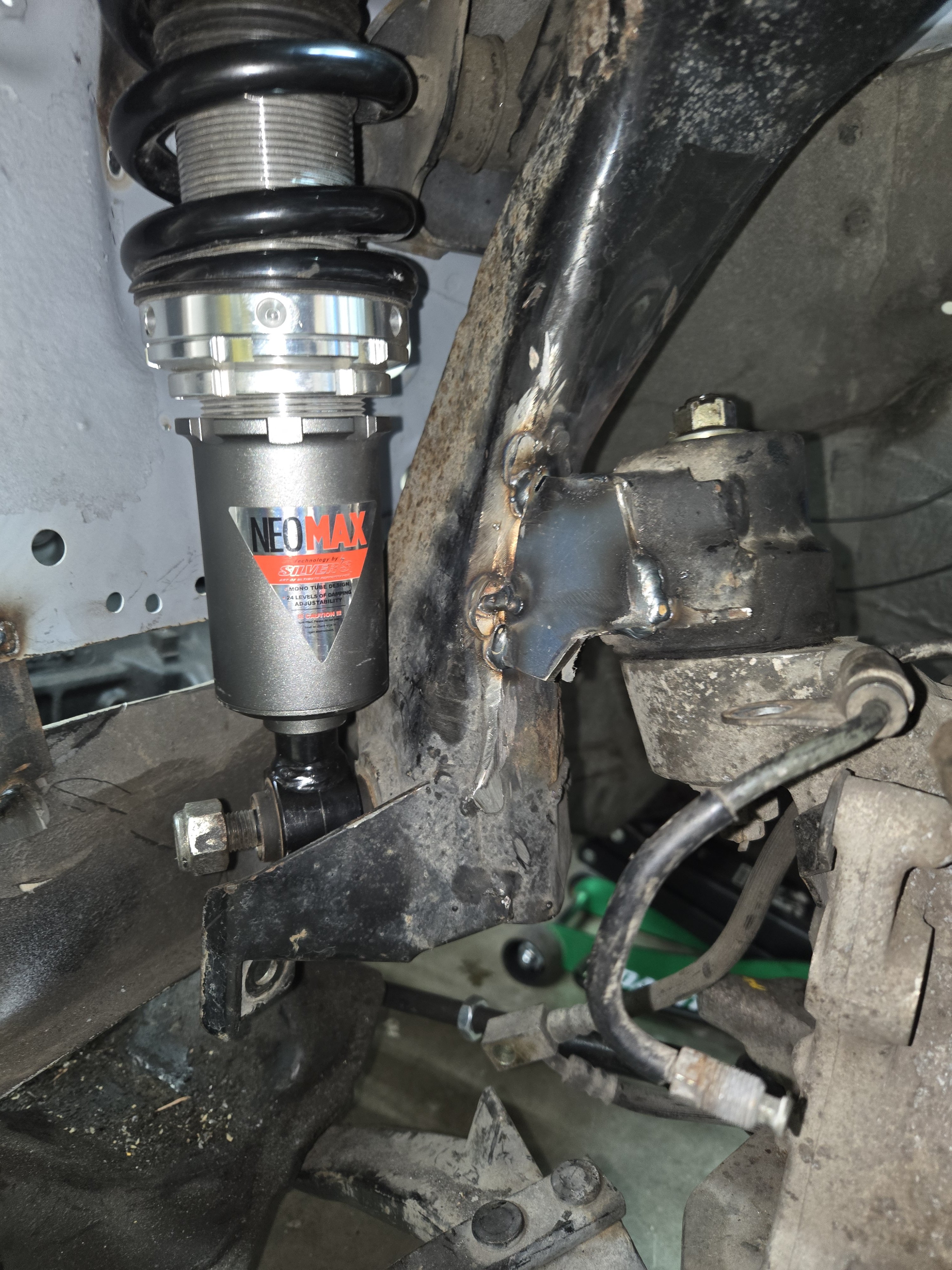

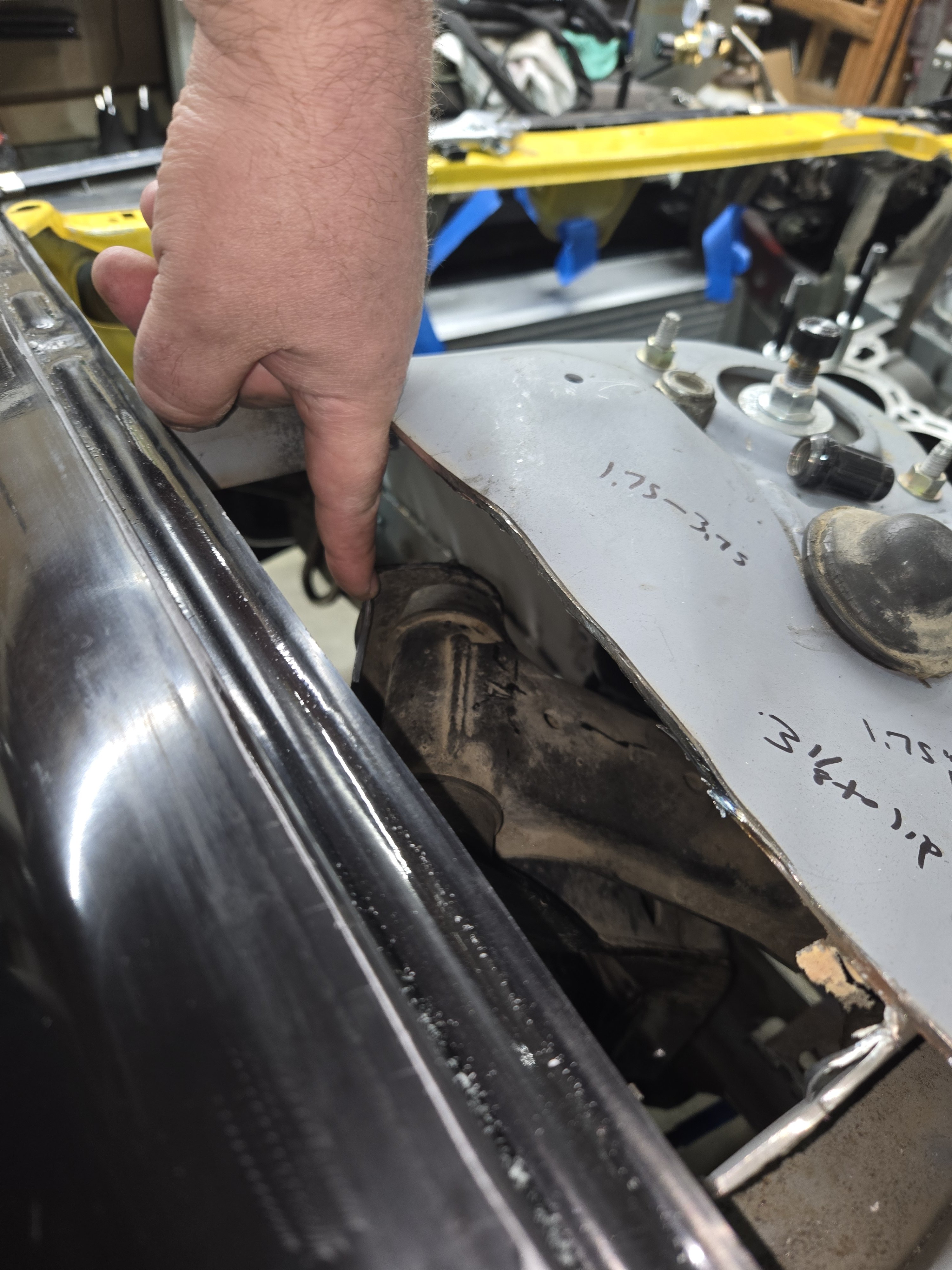

The frontend wouldn't go low enough because the coilover was max low and the upper control arm would collapse into itself and potentially bottom out in the strut tower. I made a brace and cut off the kingpin and then moved the upright down 1.25" and welded. i still have to finish but this gives an idea. Now I can have a normal 3.25" of shock travel and things aren't binding. I'm also dropping the lower arm and tie rod 1.25".

Pay careful attention to the kinematics of that upper arm. The bloody things don't work properly even on a normal stock height R32. Nissan really screwed the pooch on that one. The fixes have included changing the hole locations on the bracket to change the angle of the inner pivot (which was fairly successful but usually makes it impossible to install or remove the arm without unbolting the bracket from the tower, which sucks) and various swivelling upper arm designs. ALL the swivelling upper arm designs that look like a capital I (with serifs) suck. All of them. Some of them are in fact terribly unsafe. Even the best one of them (the old UAS design) shat itself in short order on my car.
The only upper arm that works as advertised and is pretty safe is the GKTech one. But it is high maintenance on a street car.
I'm guessing that a 600HP car as (stupidly, IMO) low as you are going is not going to be a regular driver. So the maintenance issues on suspension parts are probably not going to be a problem.
But you really must make sure that however your fairly drastically modded suspension ends up, that the upper arms swing through an arc that wants to keep the inner and outer bolts parallel. If the outer end travels through an arc that makes that end's bolt want to skew away from parallel with the inner bolt, you will build up enormous binding and compressing forces in the bushes, chew them out and hate life. The suspension compliance can actually be dominated by the bush binding, not the spring rate!
It may be the case that even something like the GKTech arm won't work if your suspension kinematics become too weird, courtesy of all the cut and shut going on. Although you at least say there's no binding now, so maybe you're OK.
Seeing as you're in the build phase, you could consider using R33/4 type upper arms (either that actual arm, OEM or aftermarket) or any similar wishbone designed to suit your available space, so alleviate the silliness of the R32 design. Then you can locate your inner pivots to provide the correct kinematics (camber gain on compression, etc).
OEM suspension starts to bind as soon as the car gets away from stock height. I locked in the caster and camber before cutting off the kingpin. I then let the upright down in a natural (unbound) state before re-attaching it. Now it moves freely in bump and droop relative to the new ride height. My plan is to add GKTech arms before the car is finished so I can dial camber and caster further.
It will be fine. This isn't rocket science. Caster looks good, camber is good, upper arm doesn't cause crazy gain and it is now closer to the stock angle and bump steer checks out. Send it.
