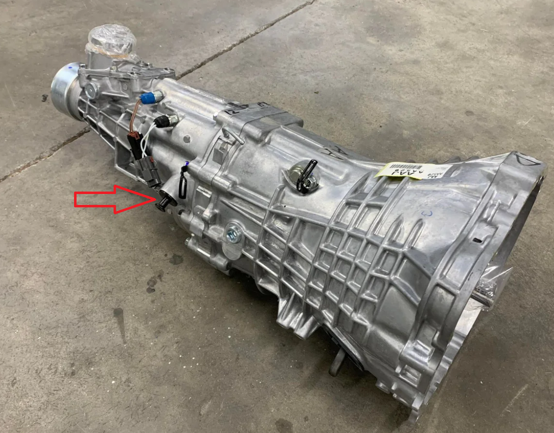

  • JC71 changed the title to FS5R30A rb25det neo 5 speed trans
and if there is not speedo sensor from car to go there? just cap it off?
(its currently using a N/A ER34 GT /S15 style diff which has the speed/abs sensor built in front section of diff)
Edited by JC71
If the current relationship is between the diff and the speedo, then no, you will not need a speed sensor in that hole in the gearbox.
If the car were an R33 GTST, or an R34 GT-T, then it would need a speed sensor in there. Because that's what those cars have/need.
If the car were an R32, then it will need a cable drive cobbled together from a Navara speedo drive, because R32s can't handle an electronic speed signal to the speedo.
The "long nose" diffs in your type of car, that have the speed sensor on the snout, are a pain because the casing is different from all the other short nose diffs. This means that the pinion shaft inside them is longer, which can make it harder to do certain types of diff swaps.
But, if all you are going to do it swap the diff centre, and keep the gears (that's the crownwheel and pinion gears) then you won't have any problems.
