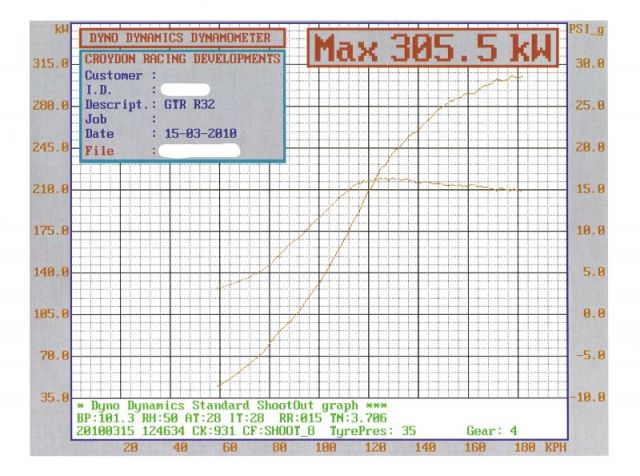

Stoked - 305awkw at just 16.5psi, with a clutch that was only sold as good for 240kw.
24U block, probably N1 engine (so bigger cams, more finely balanced)
Nistune by Croydon Racing
R34 N1 turbos (2860-7s)
Xforce split dumps, modified to put the R32 o2 bung in a sensible location and smoothed a little
Aftermarket front pipe, 200 cell Metal Cat, 3.5 in Trust Cat back (very quiet compared to most)
Greddy Profec EBC
Seimens 550cc injectors
Trust Intercooler, about the same size at stock
Sard high volume fuel pump with direct earth
Adjustable cam wheels (but set to 0)
Otherwise stock, eg airbox, AFMs, coilpacks etc
Jim said it was very easy to tune up and make good power.
