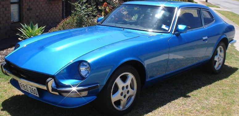

  2. Hi I have a RB20DET powered Datsun 260z with stock gbox with 4.4:1 LSD. Currently the car accelerates well but the gearchanges are very frequent and the engine doesnt seem to labour much the as the car is around 1100kg. max speed in second is 110 at around 7200rpm. its doing 60kmh in 4th gear at around 2300rpm. it accelerates well and lag is very minimal or non existant considreing it has a larger turbo and longer intercooler piping. though this aint bad but on the highway it chews fair bit of petrol as it does over 3200rpm in 5th at 110km/h. im interested to know at what RPM does a stock driveline r32 GTSt do at 60km/h in 4th gear so i can compare to mine.Alo if someone knows what rpm in 5th gear at 110km/h. if there is much difference ill be looking at changing the diff ratio to 3.9 or 3.7 to improve the fuel economy on long boring trips. as the car is fairly light weight dont think it will impact too much on acceleration for those very short of the line trips. thanks in advance for help.
