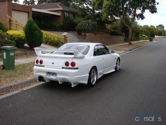

F.s Veilside Rear Spoiler & Custom Rear Bar...
