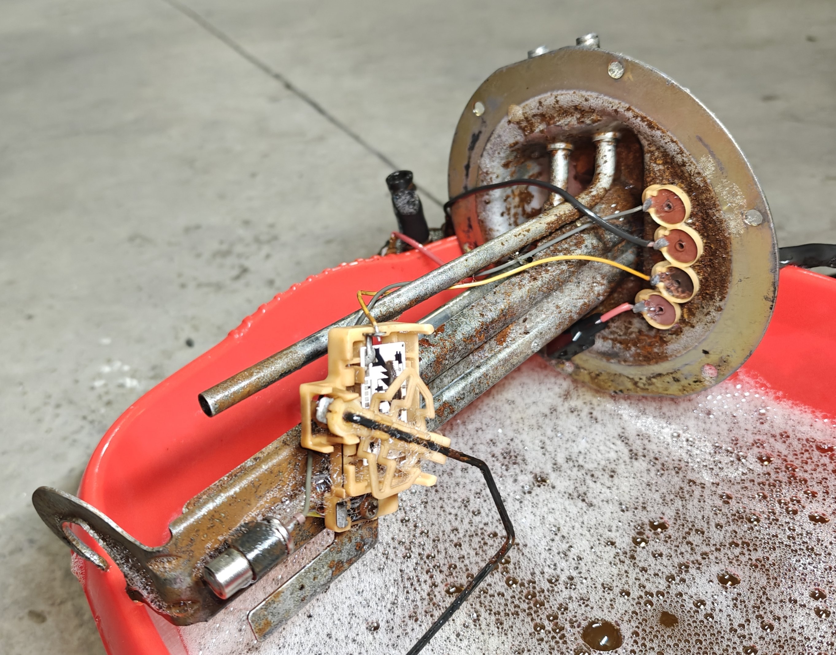

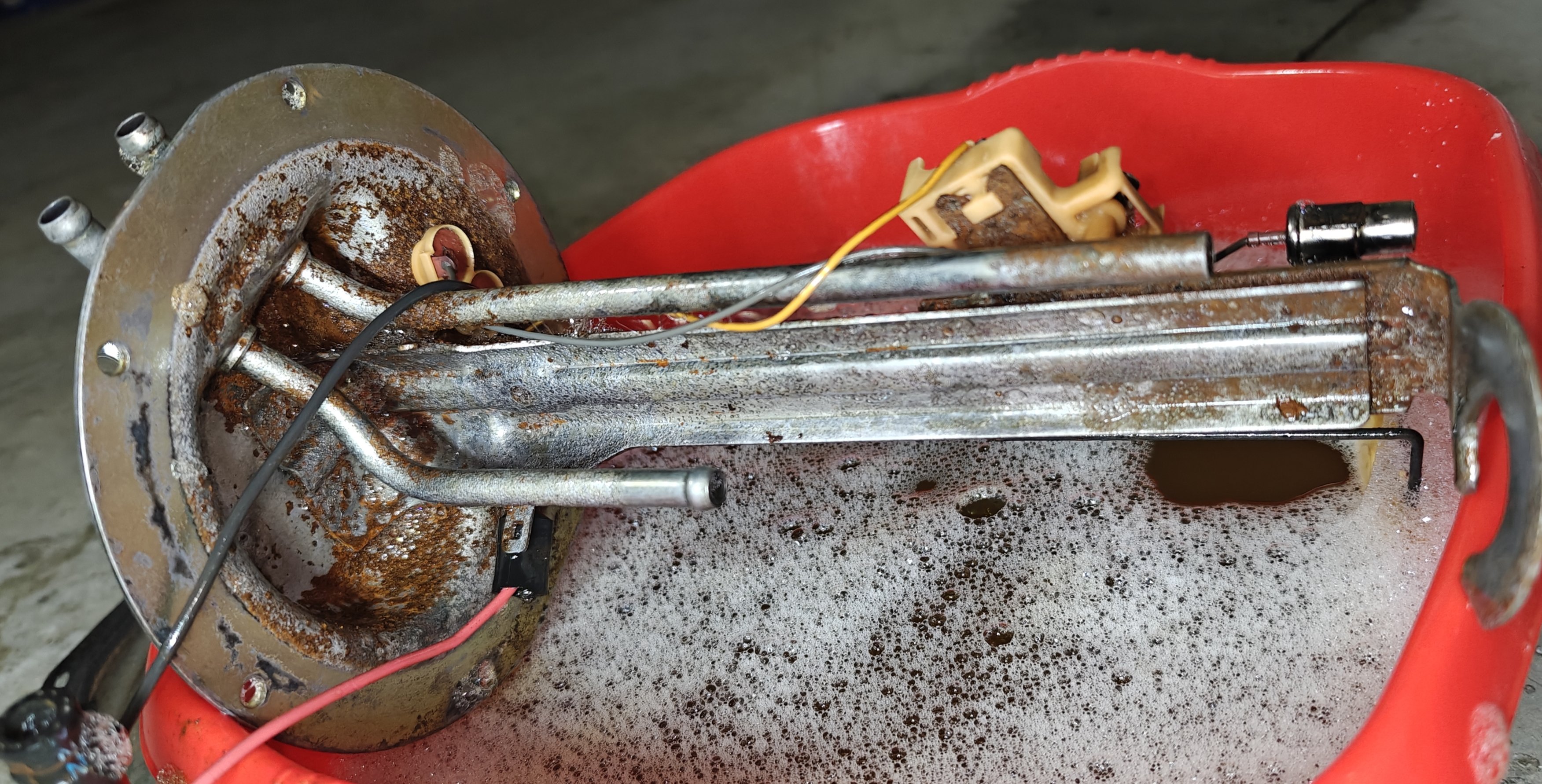

  4. 7 hours ago, GabsReDeal said:
    I found the ingredients at larger amounts from a Coffee Shop.
    1kg Citric Acid for €8.50
    500g Baking Soda for €2.50
    I tried it out tonight distilled water (I got from my ACs) and dish soap. It does get bubbly with dish soap.
    In just two hours the hanger has improved significantly and rubbing against any remaining rust seems to flake it off. I'm going to leave it a little bit longer and see how it goes.
    IMG_20250706_023240.thumb.jpg.db301f01c6e9a723496fd1477ba7bc0e.jpgIMG_20250706_023256.thumb.jpg.2bda611f285586c6c6714cab624e8198.jpg
    I have read that someone even used this solution in an ultrasonic cleaner to clean a seized water pump which brought it back to life.
    You can probably scrub the rust with a toothbrush or something. After you get the rust off flush well with water to neutralize and you will probably want to also use a fuel tank sealer to keep it from rusting again.
    • Like 1
  5. 5 hours ago, MBS206 said:
    Get something that can spray a bit, something like I'd use is a pressure pack for weed sprayer. I use one with degreaser. Spray it on (make sure you're fully covered up, you don't want that shit on you, especially face/eyes).
    Alternatively, a paint brush will help here as you can brush and work at the stuff quite aggressively.
    Be aware, citric acid can eat metal away and will cause it to rust more later.
    So make sure you neutralise it when done, and give the fresh metal some protection.
    That hanger, I'd honestly bin and get something like the Frenchy's drop in replacement.
    The tank, again, I'd look for something else to replace it with. Remember, as metal turns to rust, it means there's less metal there now. So some patches of your fuel tank are likely to be quite thin.
    Personally, Id focus on the front end of things, IE, how did the injectors get clogged if they're meant to be after a fuel filter. Then, once the front is sorted, I'd rig something up, even like a small surge tank, and make sure the engine is now running and all behaving. Then I'd replace the fuel tank and fuel hanger and pump.
    Also, I'd already be preparing to ditch your fuel filter...
    The sodium citrate solution is designed to buffer the citric acid to keep it from attacking metal quite so much, the guy that came up with that recipe did a ton of testing on how much metal loss occurs over time and it's nothing crazy unless you forget about it for months:
    • Like 1

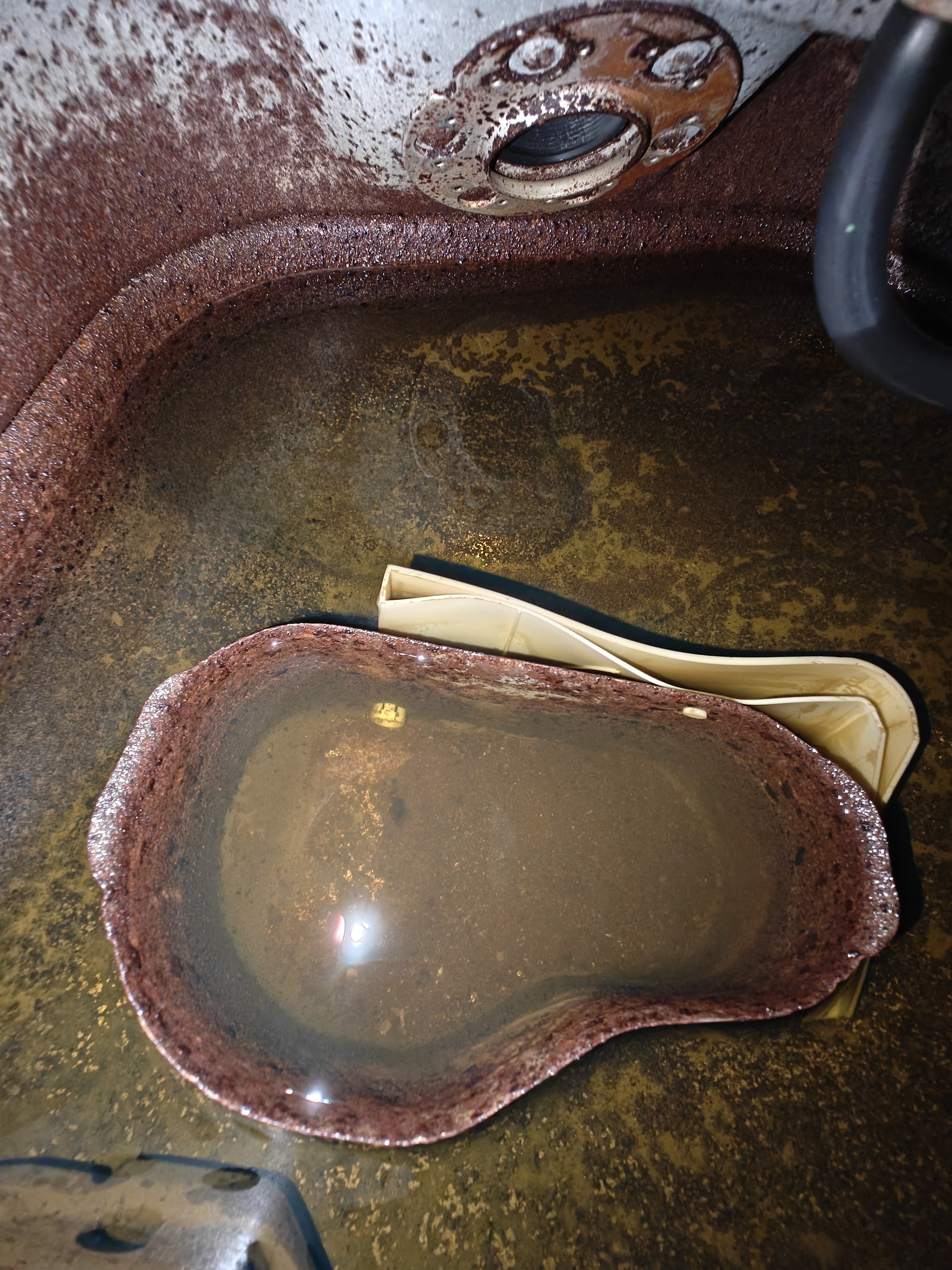

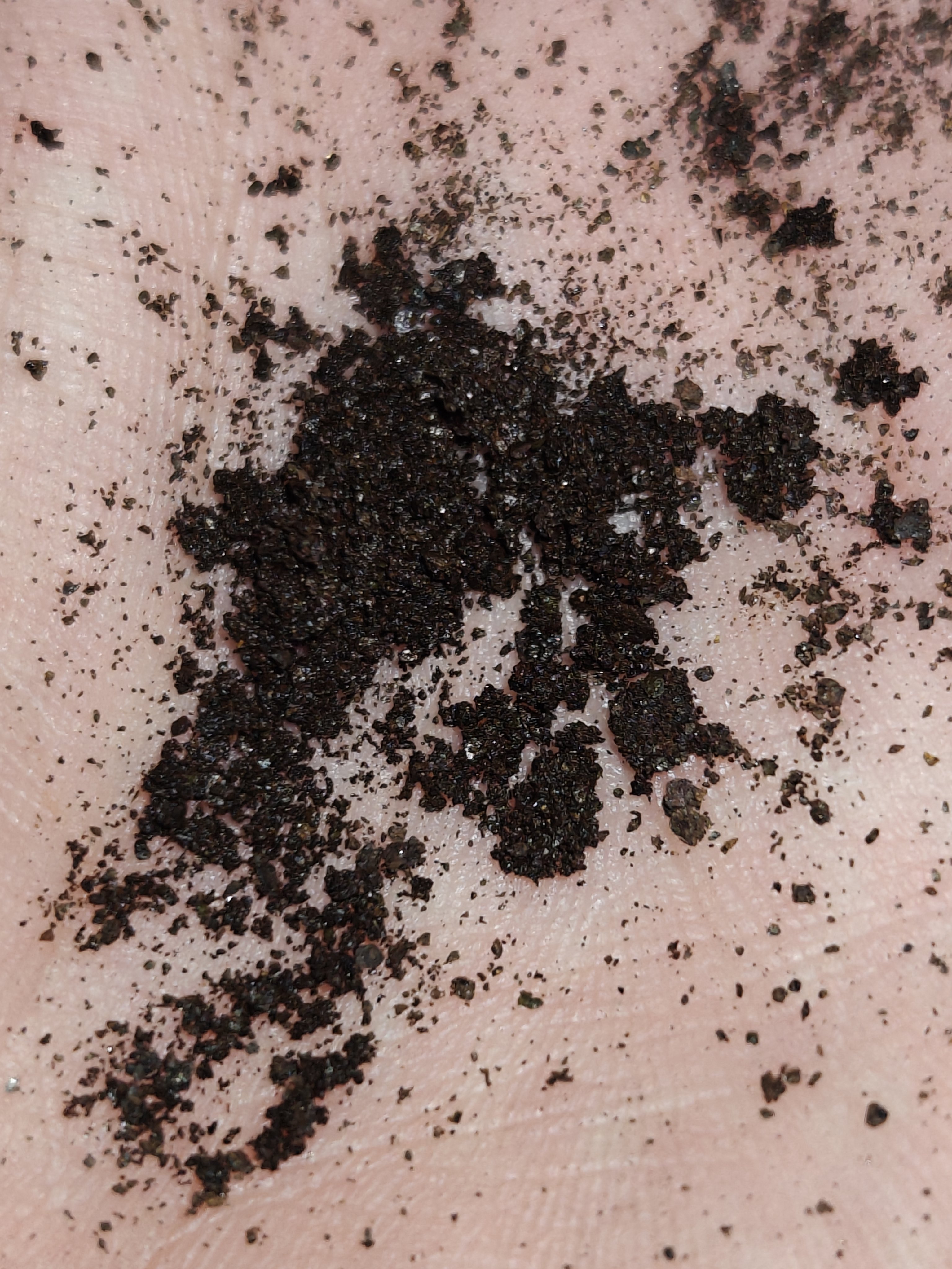

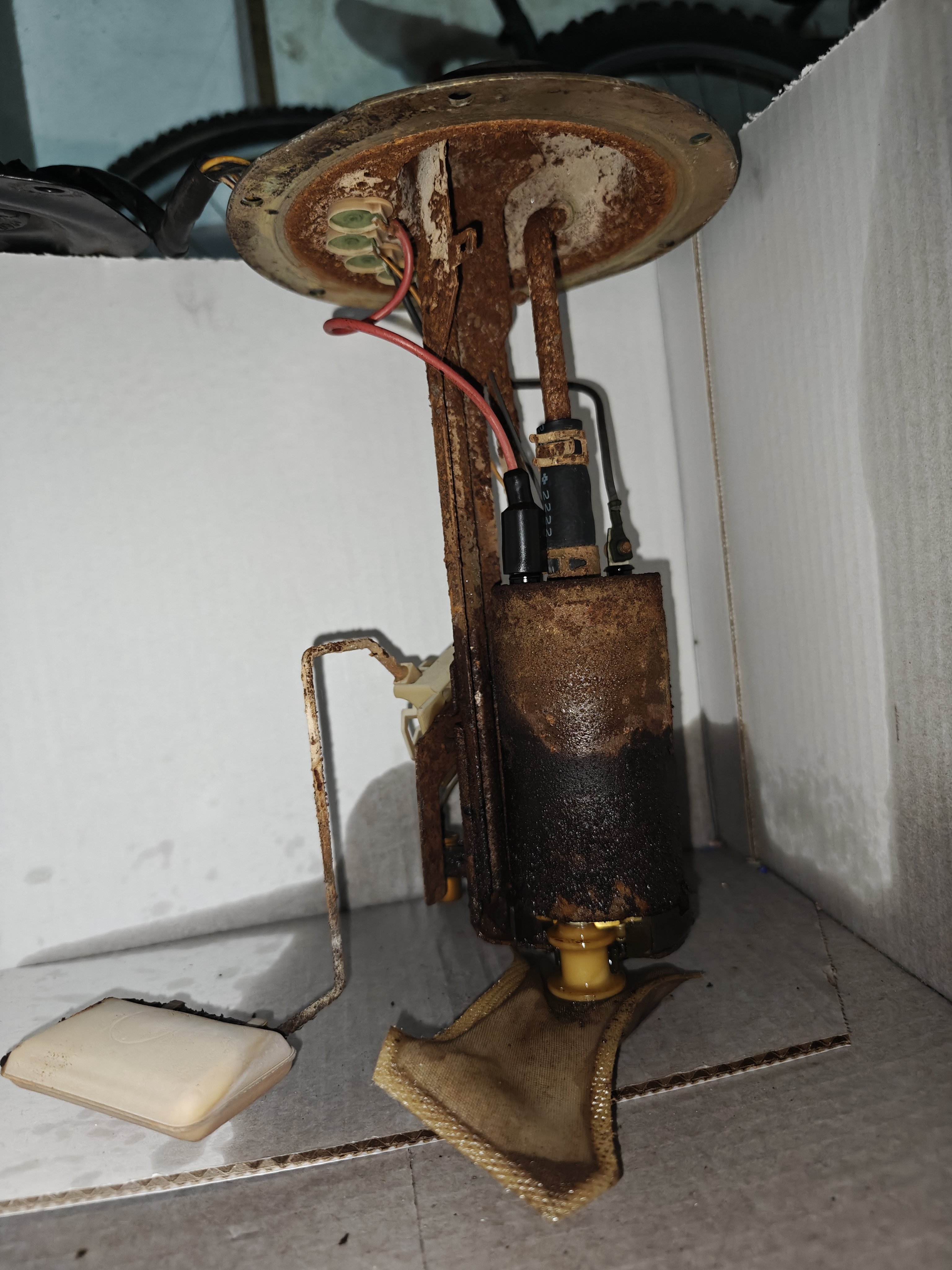

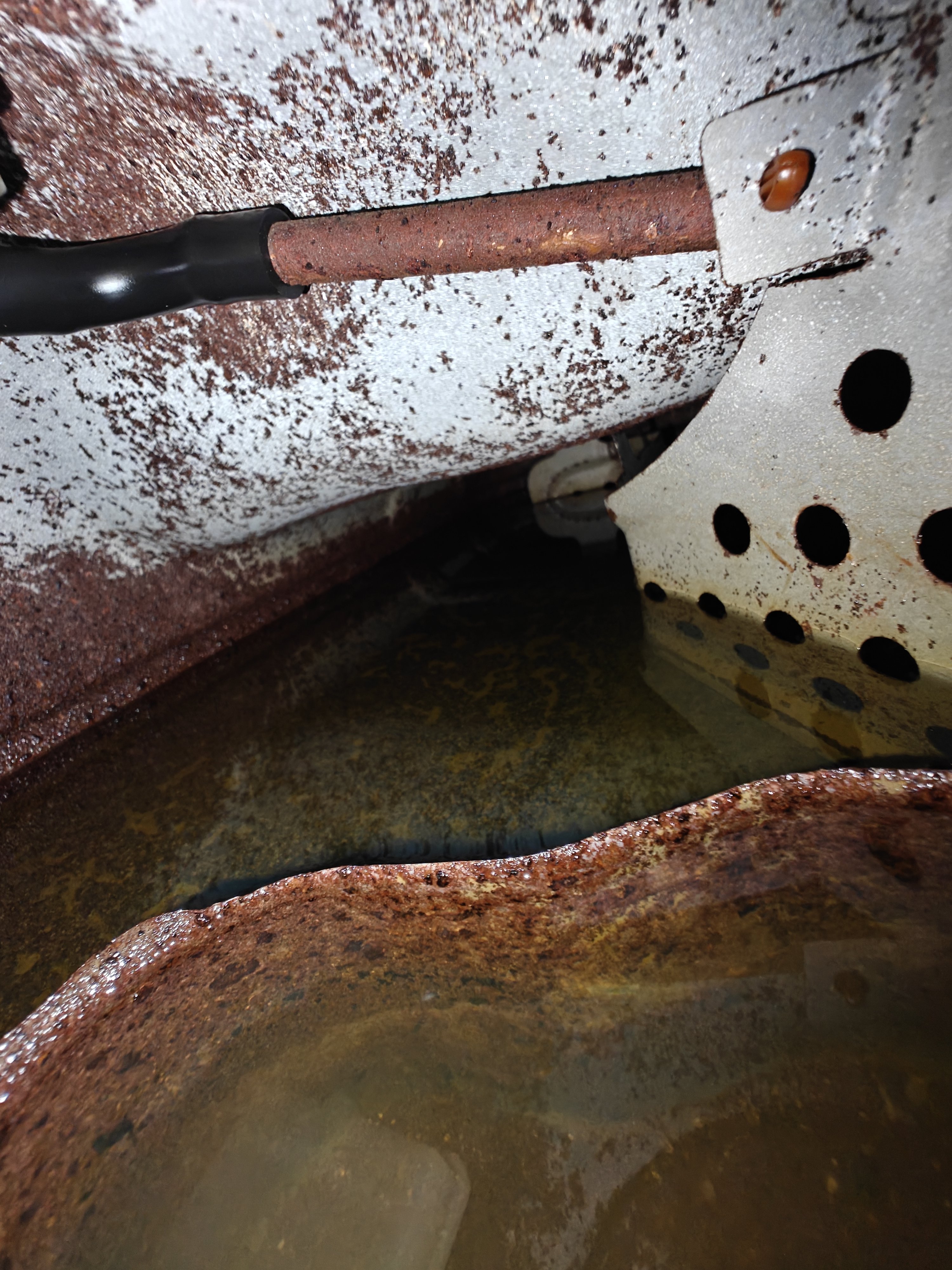

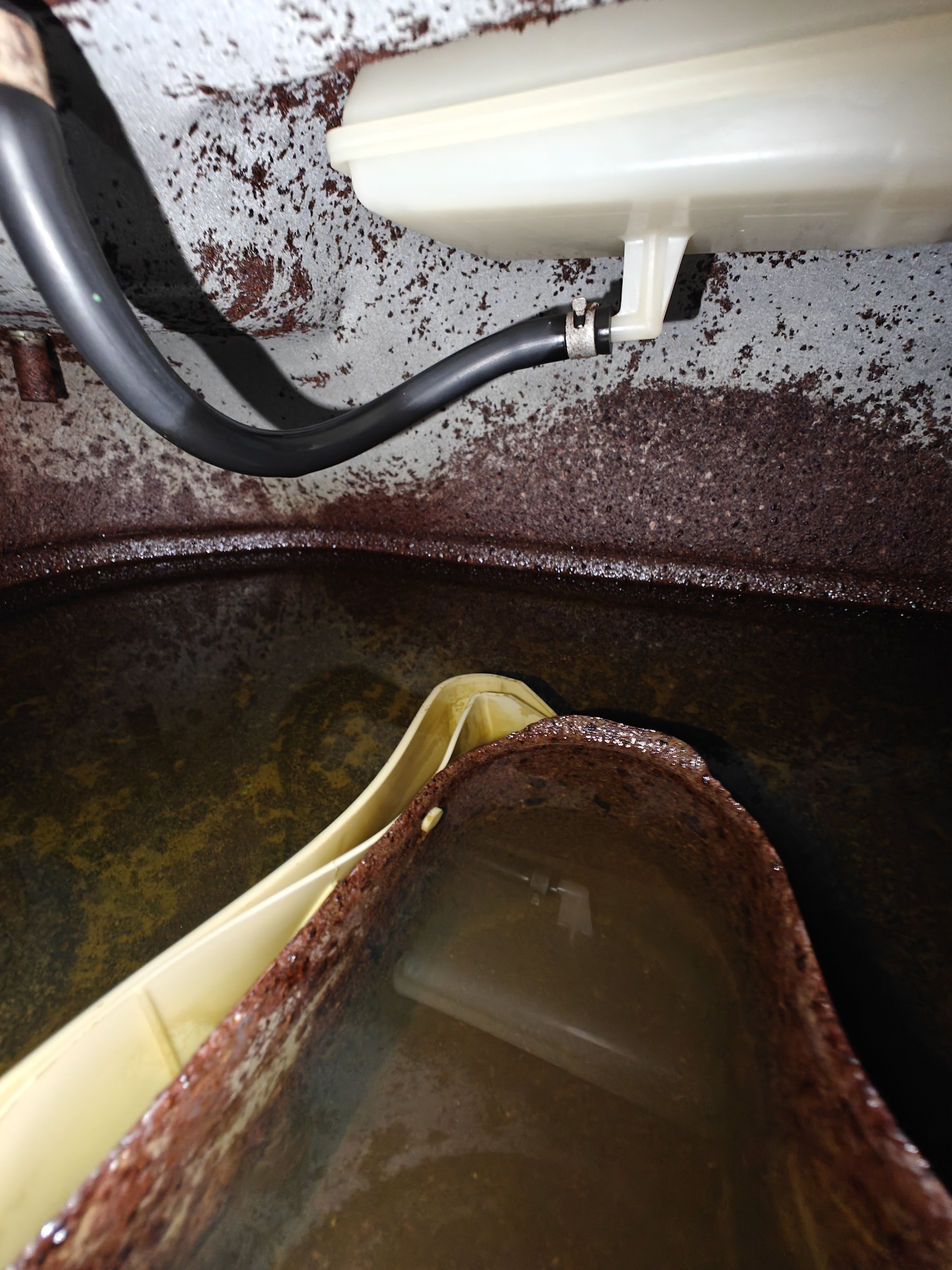

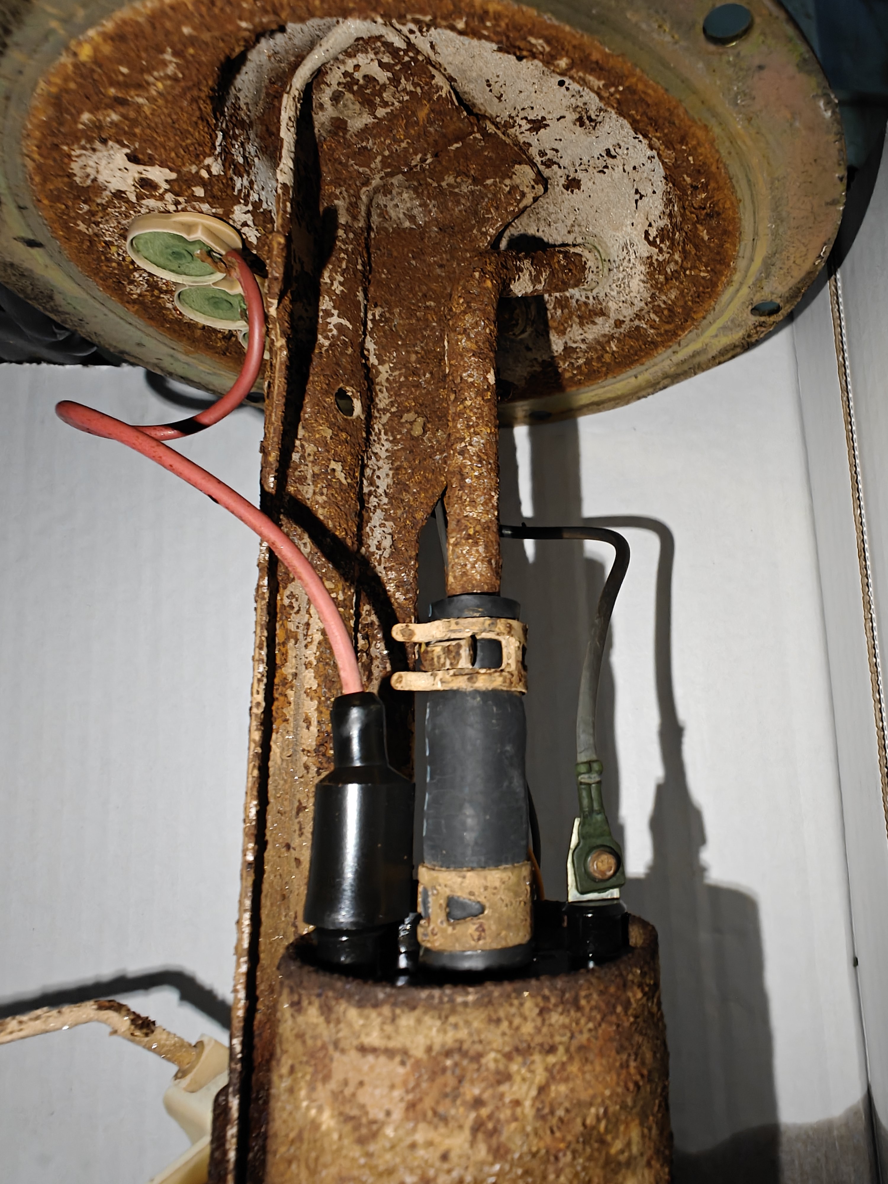

  7. 13 hours ago, GabsReDeal said:
    I removed the fuel pump to take a look at the tank. The sender unit is very rusty.
    IMG20250703191951.thumb.jpg.80fc508d406d1874dcb6b68d31b00587.jpgIMG20250703191958.thumb.jpg.6c9db46ffa6c8b7be442dfddb0677cc4.jpg

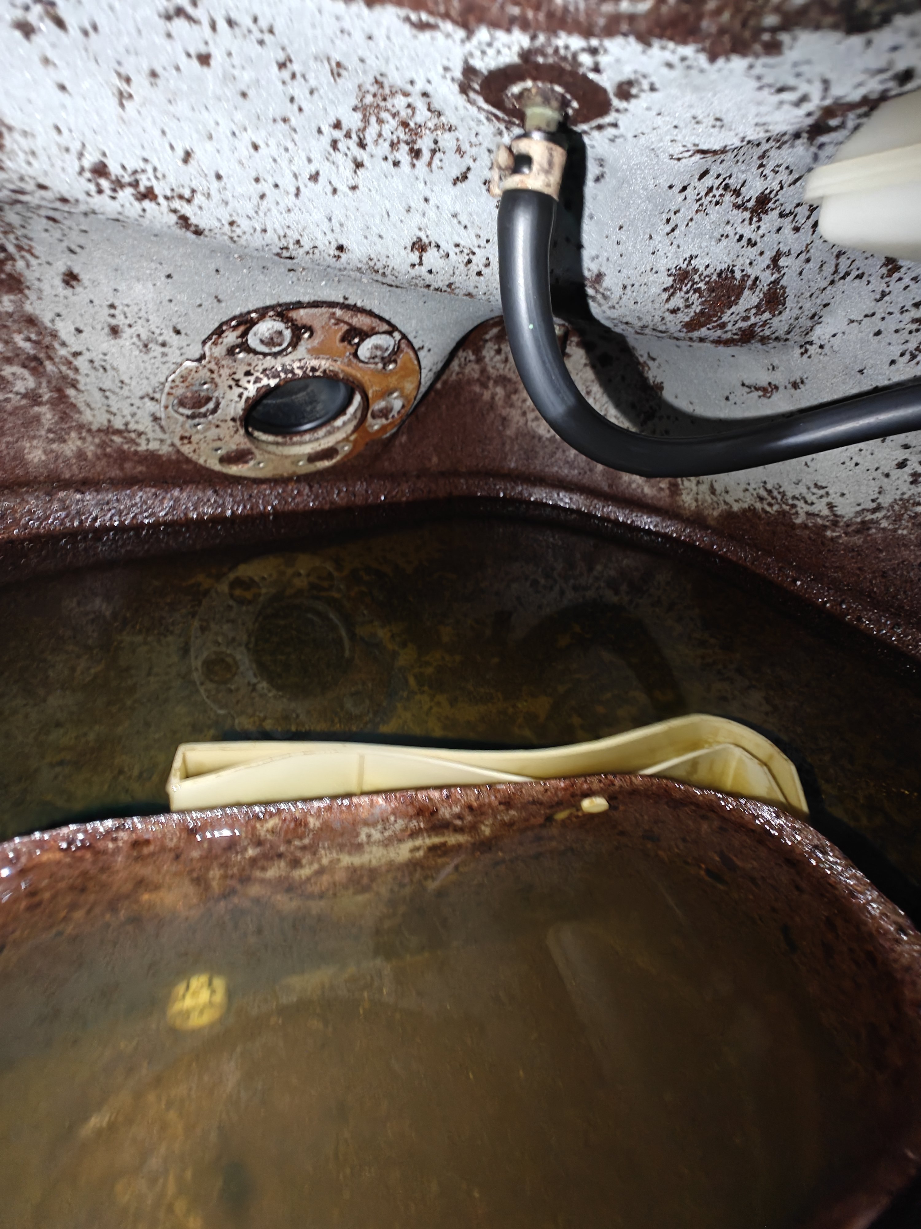

    Took a look at the tank and it is also quite rusty.
    image.thumb.jpeg.c1312da27f940999691e6cab2f573cc8.jpegIMG20250703192149.thumb.jpg.7ae79efa521fd6711acf8b6d002f9a41.jpgIMG20250703192154.thumb.jpg.68178d52aaa1c1c8bcc8dcab15018bb1.jpgIMG20250703192206.thumb.jpg.58a626edfb64c421f59fa271ac6d98b6.jpg
    Right at the base of where the fuel pump sits, there's a buildup of what seems to be rust particles.
    I did find new OEM fuel tank (17202-01U01) and sender unit (25060-01U00) from amayama which would set me back around €900 including shipping and customs. I most likely would need a new fuel pump as well.
    I'm going to be honest, I have been driving for around 6 years now and this is the only mechanic I went to apart for once (Last year I took my Porsche 924 to a guy who specializes on them). I've got a good relationship with him and he's always there to assist, even coming over to my garage at times for my convenience since the car was not starting. I believe he's got over 20 years of experience, but this is not the first time he let me a bit down on some basic diagnosing. I do not want to switch over to someone else, but I'd be lying if I said that it did not cross my mind.
    Take the fuel pump out of the hanger, purge the fuel tank of gasoline, try cleaning it with a soaking of this sodium acetate and dish soap solution. If there's no rust holes this should get the tank and hanger clean.
