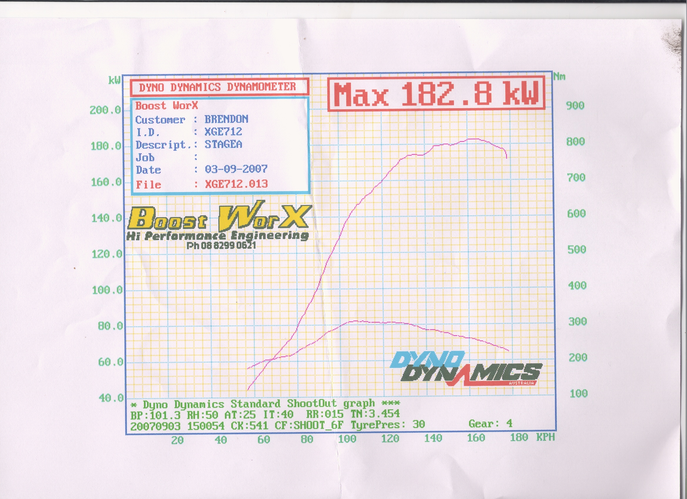

Ok, had my last tune done a few weeks back. Automatic, hiflow Slide turbo, usual mods etc, 183kw.
Boost seems to be dropping off..... car ramps up on the street to 105kmph so perfectly, then there is the boost drop and you can see that has a stranglehold on peak power.
Tune curve looks good for an automatic, 4th gear, with 2x piggyback controllers (Sitc / SafcII). If the boost held better I have no doubt a bit more (10kw+) power ultimately could be found in the top-end. Torque is fairly impressive, and on road 0-100km is very nice indeed for a family wagon.
But - what to do about the boost drop. Get a HKS adjustable turbo actuator, and set to 1bar, so that it holds peak boost for longer?
Power is down tho, lat tune 189kw this tune 183kw. Feels more responsive on the street tho. Had the group-buy Aerospeed adjustable cam gear wheel installed, wonder if it was set correctly (ie retarted 4degrees and not advanced 4degrees!); plus had to have the water pump replaced too.
Other than that, its all good. This was my 30k project over the past 2yrs (incl car price + mods + labour/tunes), and now its all done. Just figure tho that it isnt quite right, feels great but the graph shows the boost loss and a cple kws down on what it should have. What to do about it?
* might save up for a DrDrift ecu remap (1300 hundred! I think) and 500cc injectors, then retune still using the SAFC/SITC combo *
Any hints tips comments appreciated.

Hey Tangles,
Head down to bill at ATS and pick up a 14psi garrett actuator. Form memory they are around $120-150 ish
The std actuator is only rated to 7-8psi or so. 1bar is a big ask especially as turbine pressure rises and attempts to push open the wastegate.
How is the cat? Maybe thats not too healthy.
The slight difference in power 'may' be simply a different day, different tie down.
Or you could be right.. lol :wave:
Either way if mid range is up then thats the affect the cam gears have made.
