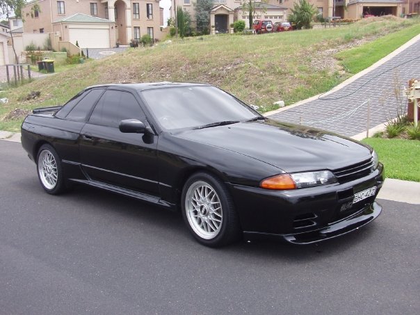

Nice looking R32! It dresses up the estate where you live as well!

Love the front lip!
Hi Jez...nice car mate top stuff...the N1 headlights set it off nicely too.
The lip is a Garage Saurus item and is the same as the one on my car...but looks better on your car in all black.
