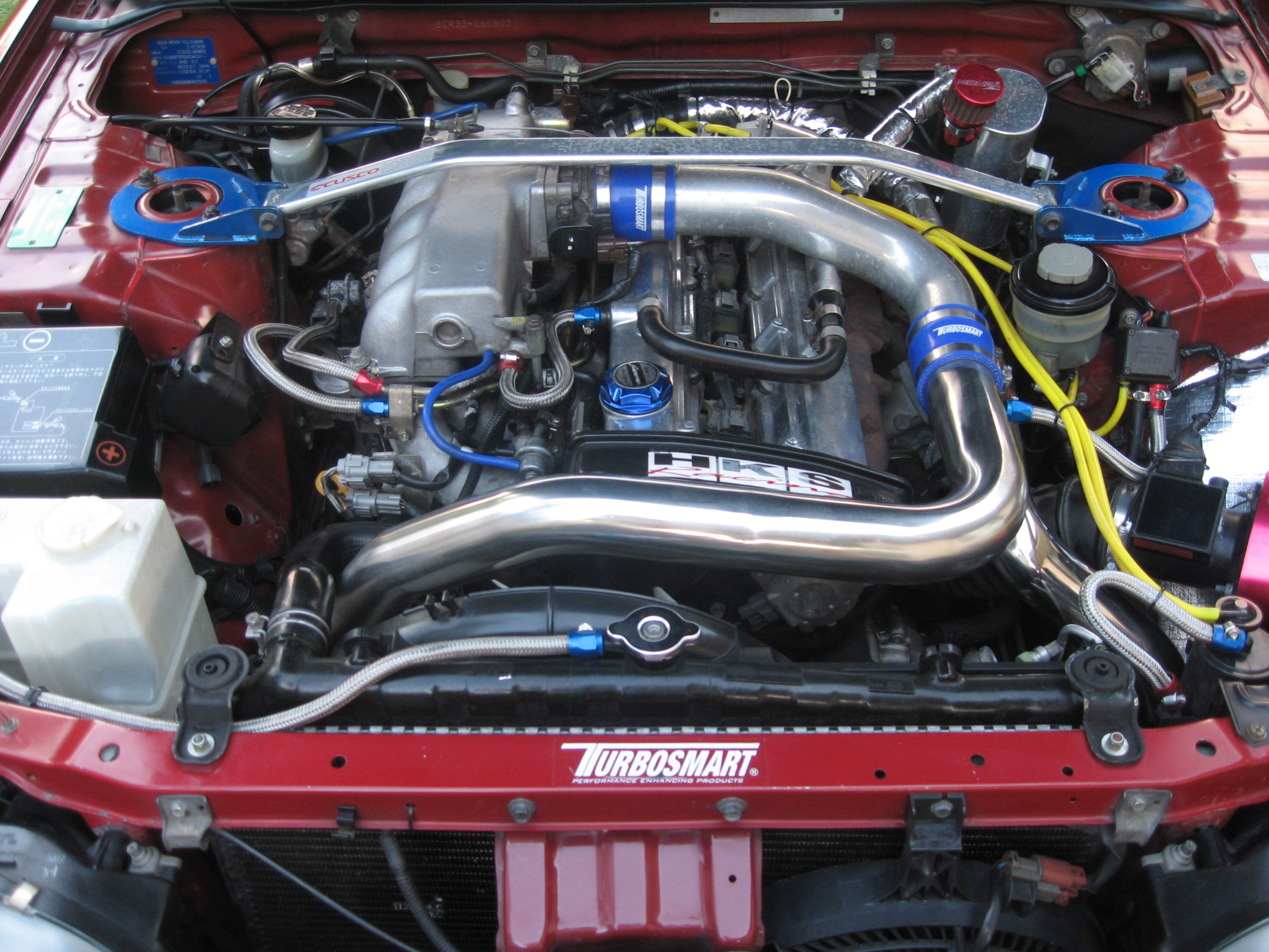

Totally equivalent. Stock often goes from the comp cover because that's where the actuator is also installed and the factory needs 2" of hose to make the connection - and it comes as a pre-assembled unit. They totally have a boost reference from somewhere between the turbo and the throttle(s). Oh, jeez. Just do it in M12 then. We don't actually care that much. I would expect any such AN converter fitting to rely on an o-ring or some other seal onto a flat surface under the flange of the hex**, because bolt threads are no intended to provide a pressure seal. unlike..... pipe threads. **which also requires a suitably flat and smooth surface on the turbo's boss to provide the seal.
I also used NP That’s were it’s seems to be the best place to fit it? All schematic shows also that it’s should be referenced from the turbo housing. But idk, I do see high hp cars without any connection or anything to their turbos, so I really don’t know how they connect their things
I do have loctite 243 and 246 and a few more models. I could drill it now in place and make new threads for m12 and order an4 - m12 coupling and fit that to the turbo. Run a braided hose to the EBC which I could get a an4 to 1/8npt
So M12 and sealant should be fine? NPT ” because that’s what I had and what I could get atm.
