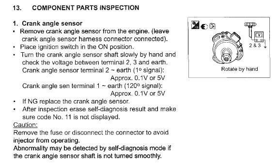

so i decide to try to check the CAS per FSM but im a little confused. im going by this:
im trying to follow it but its a little confusing to me. i can hear the injectors going off when i spin the shaft... when i check the voltage to #2 i get battery voltage, 3 and 4 depending on the position of the shaft its 5v or lower. nothing at 1.
is my CAS ok?
