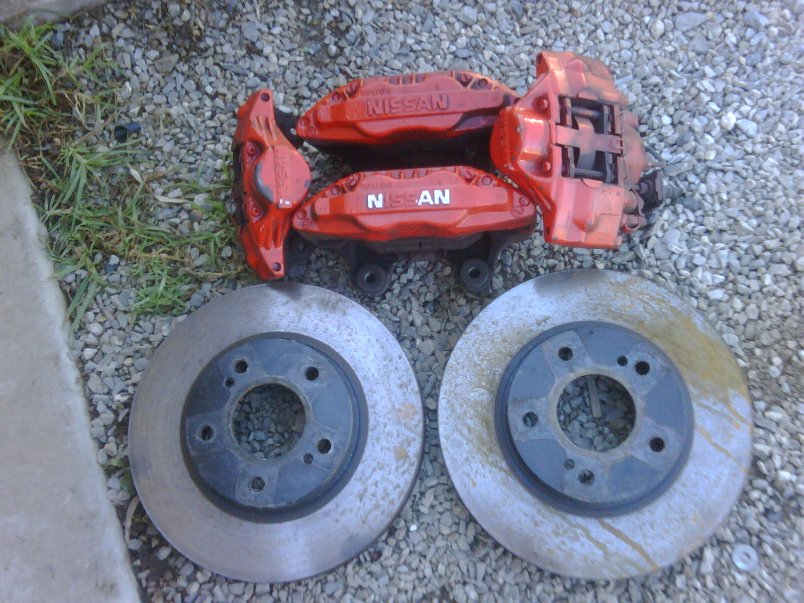

R32 Type M Brakes All 4 And Discs N Pads
