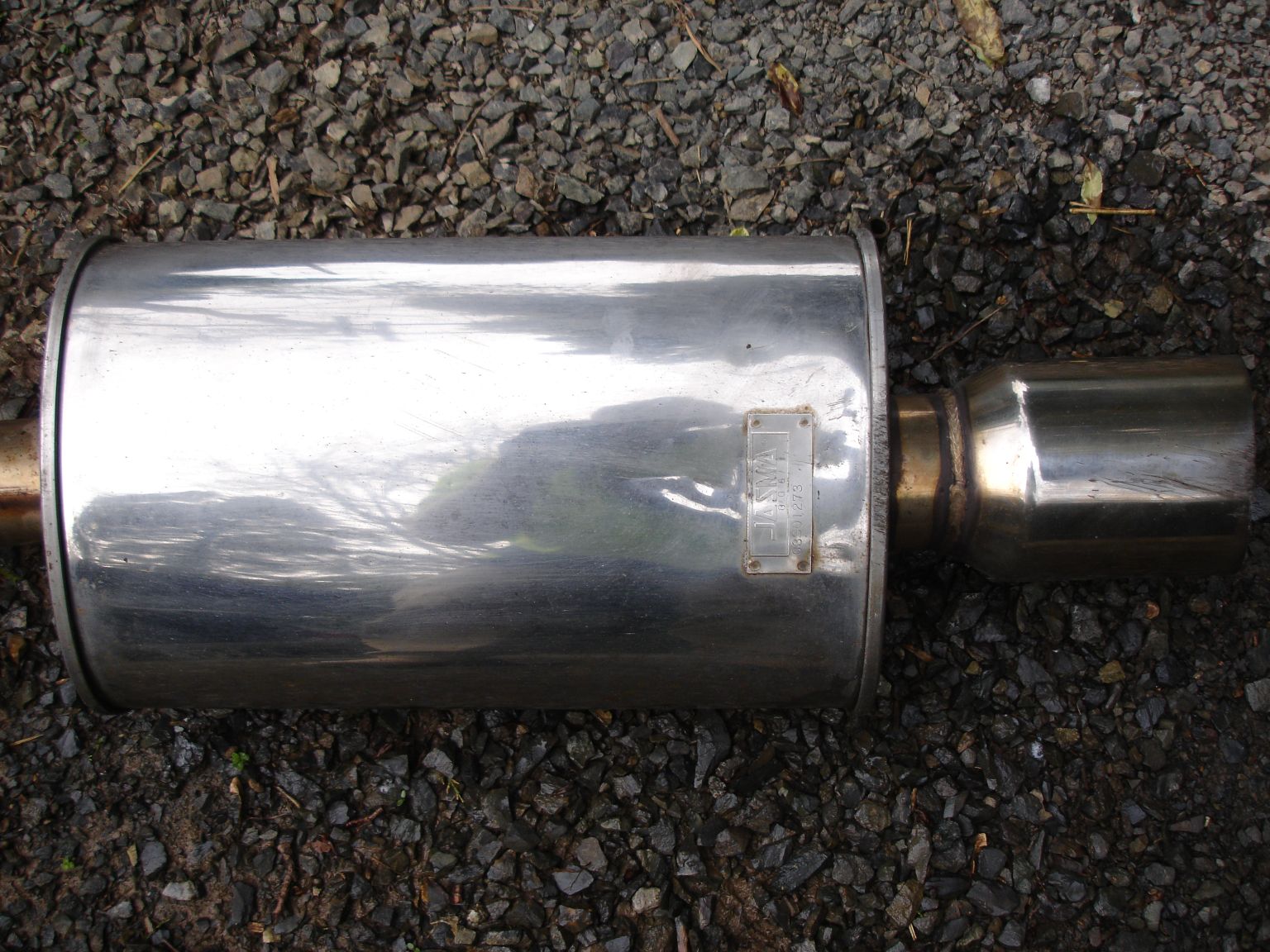

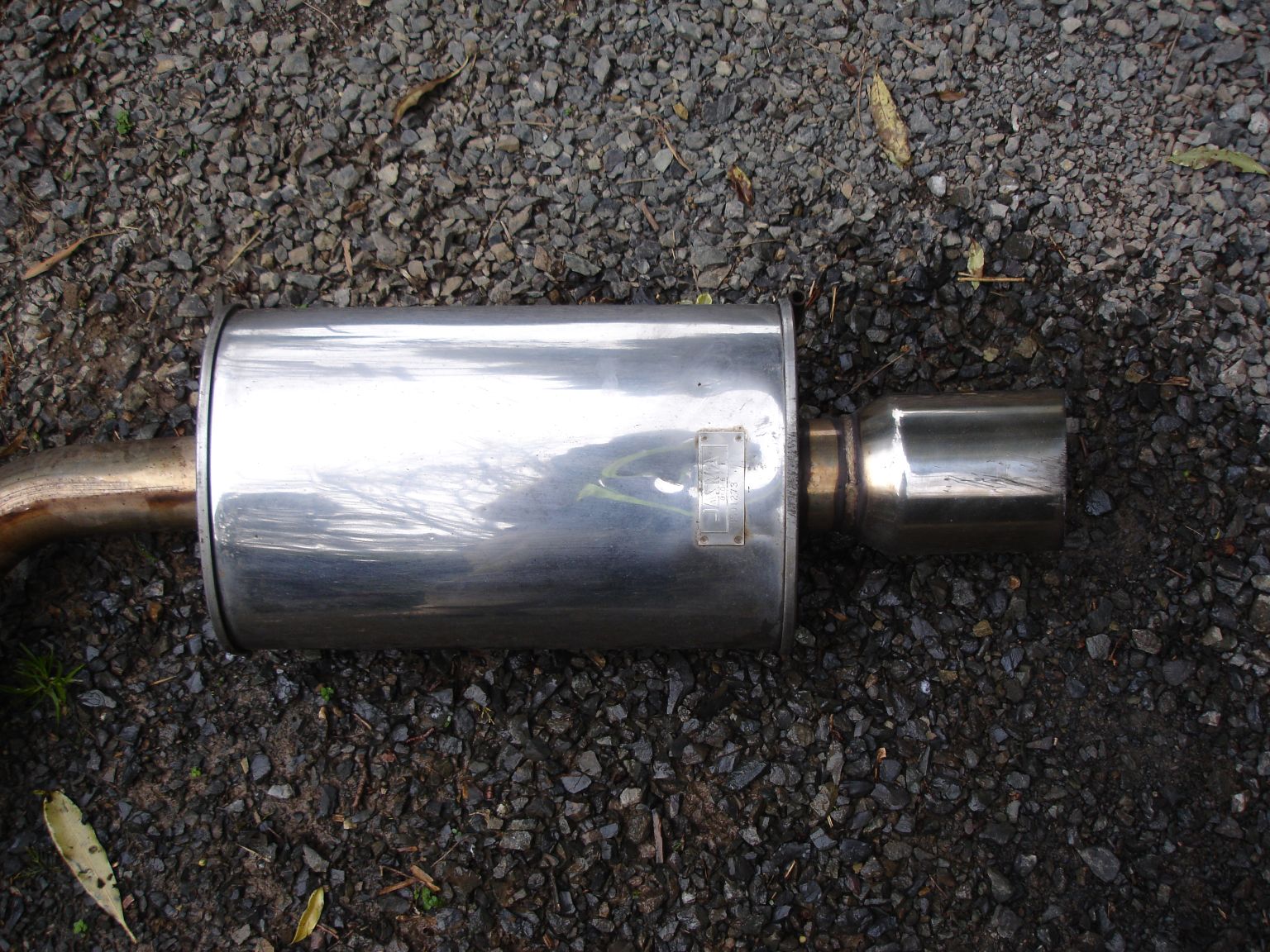

Jasma Exhaust Tip
Legend. I ended up finding the facebook account of the owner of the first car i sent but sadly he deactivated the account. I think you’re right in saying it’s some sort of well done custom job. Really appreciate your help anyways.
