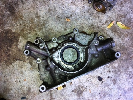

RB26 Standard oil pump $50

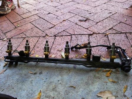

RB26 standard injectors & rail $200

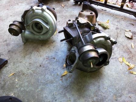

RB26 turbos & dump pipes, good condition $200
