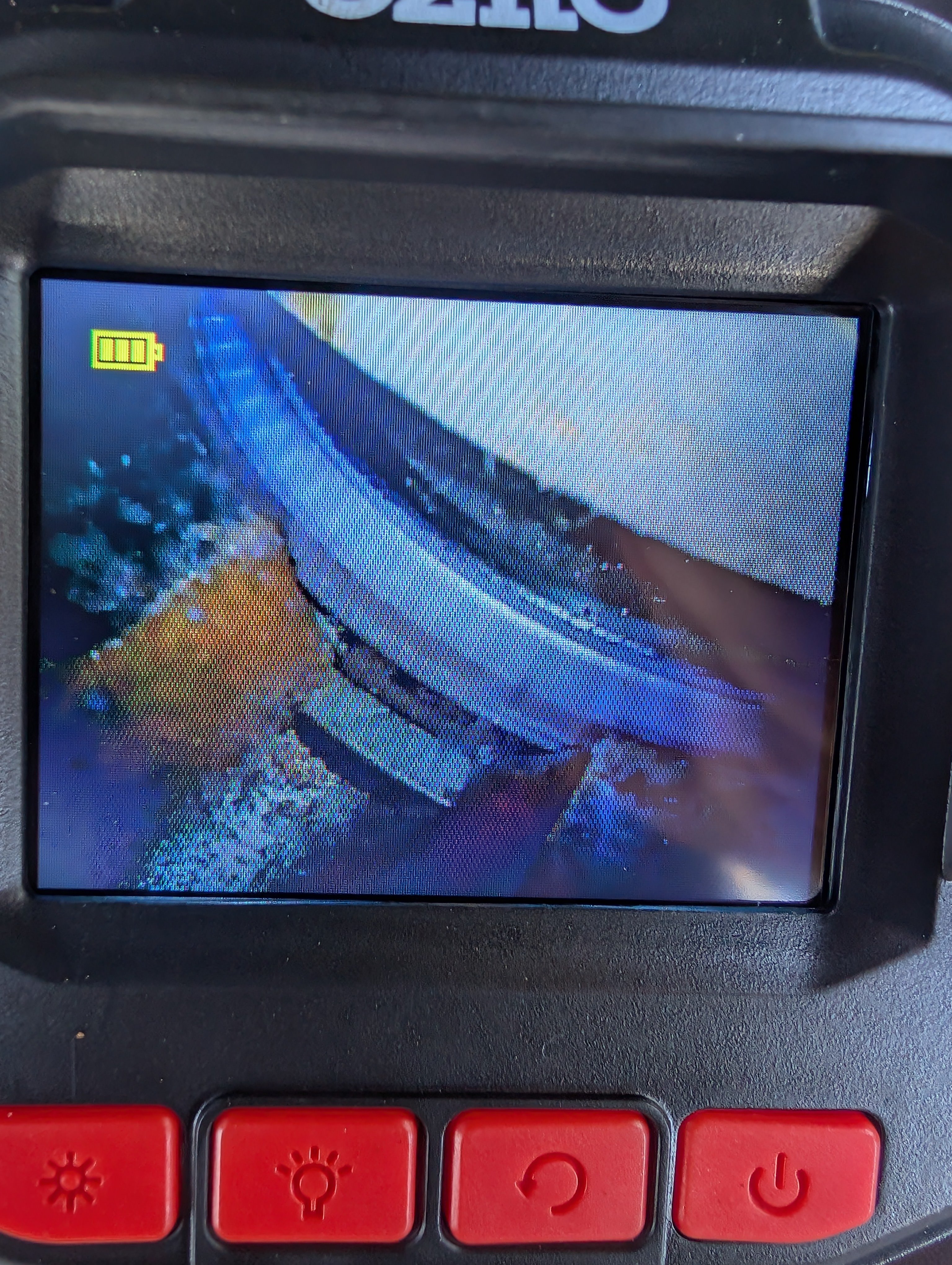

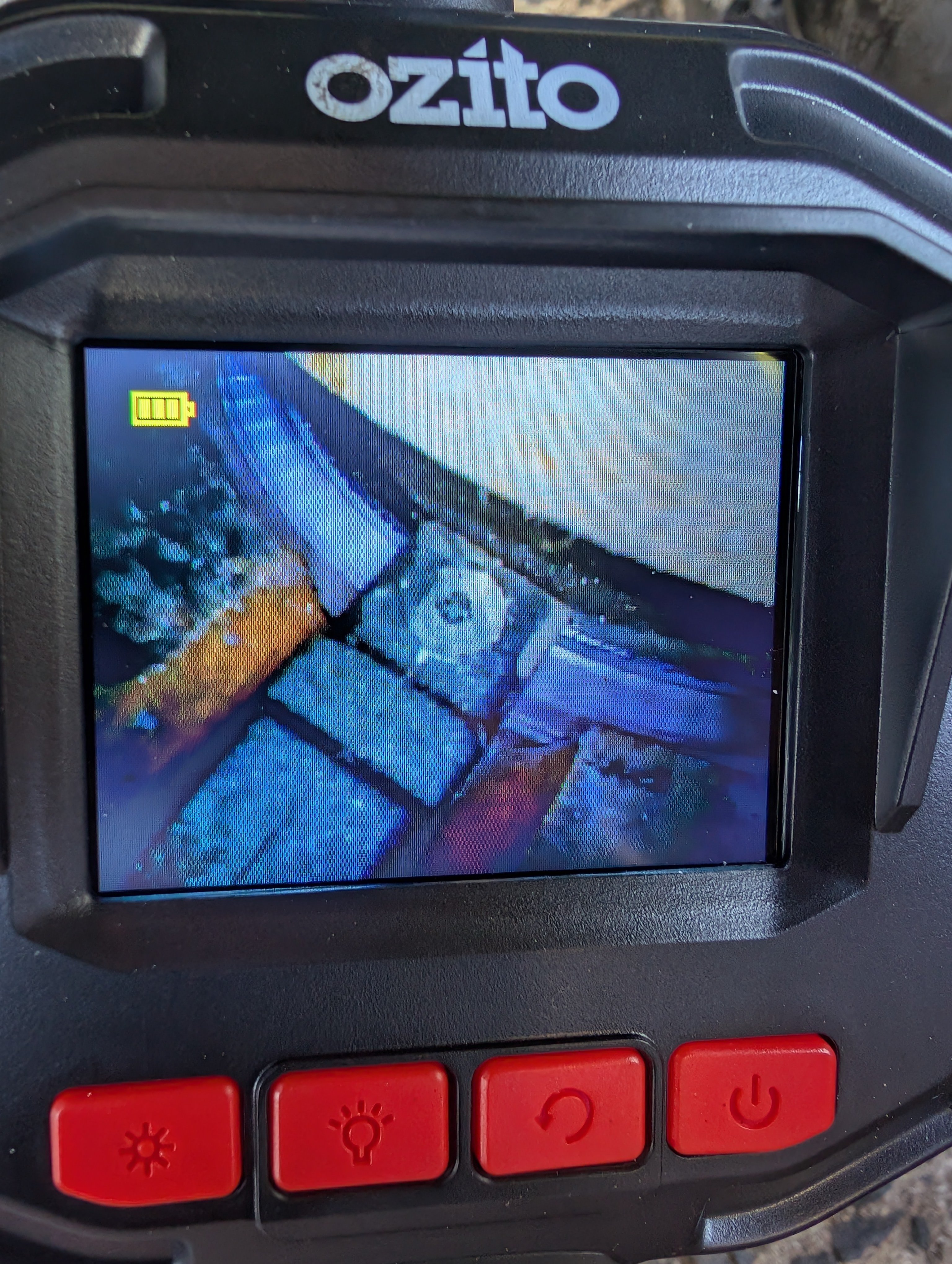

Ok so we have a smoking gun. A few weeks ago I had to replace a speed sensor that I'd fit incorrectly. I replaced the sensor and everything was fine with no lights or codes thrown any longer. When I was doing some more bedding in yesterday I got ABS and traction control lights again and, considering when this happens those things are disabled, the pedal went back to normal with smooth braking and no hiccups. The codes thrown are for the same speed sensor that I replaced. When I looked at the sensor I took out it looks like the tip of the sensor is damaged. So whatever happened to it, perhaps it has damaged the magnetic ring on the bearing (that I only replaced the other week). I'll get my boroscope in the hole where the sensor goes and see if there is any damage in there. Hopefully just the tip of the sensor is in there and the bearing is fine. 🤞🏻 It's worth noting also that the pedal hiccup happens more often and for longer periods now and totally goes away when the codes are thrown again which happens usually after 5 or so minutes of driving. Love all your help here as usual guys, thanks!
