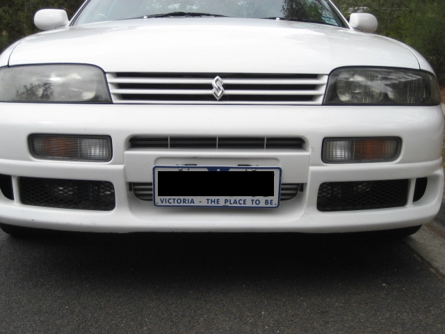

i got my cooler done by Protek in Melbourne and they fitted it with no masacaring of the bar or rienforcement. id definetly recommend getting it done by a workshop, unless you know exacxtly what your doing. should be around 200 or so and it well worth it to know they its done right. im sure they already would do their best, but empahize to them you want no or very minimal cutting of the reco and bar and im sure they'll try and accomodate.
pic. got new plates now and the slim lines fit just about perfect across the middle.
